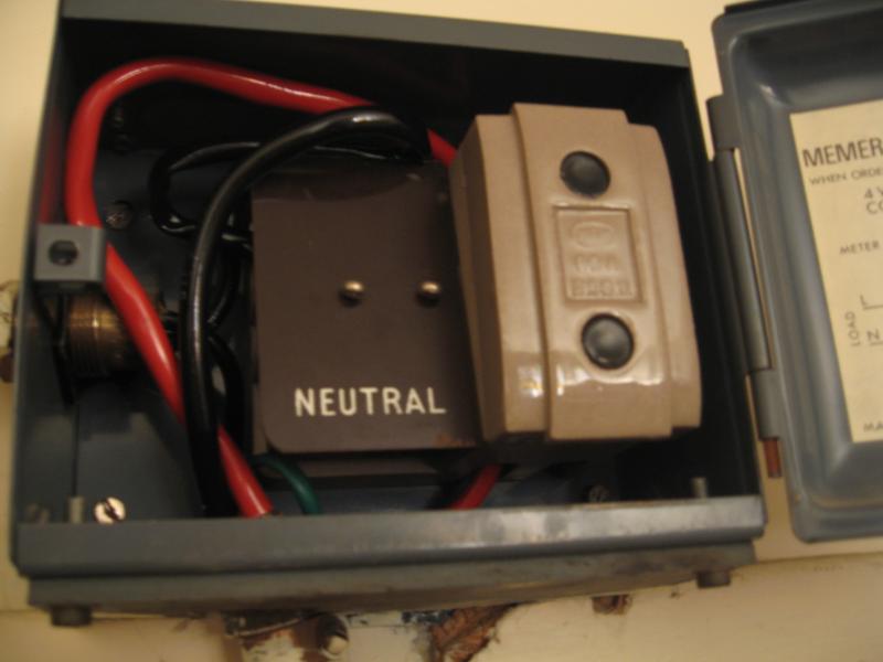

Yo - sorry - I hadn't looked at the last photo, and in the others it wasn't obvious that they are bellwire.
I think the white junction box may well be a bell transformer, hence the two bell wires coming out of it.
I hope the burglar alarm isn't supplied from the FCU by alarm cable, because that's what it looks like...
it seems to be the doorbell, not the alarm
and i found this, which i guess (because the wire disappears into a wall then pops out halfway along the communal corridor) might be what we're looking for?
[/img]
however the electrician has said he can replace the board without finding the isolator? something to do with disconnecting the henley block at the meter... judging by the earlier post i'm assuming that's not a great idea?
Not the best, and he would be contravening the Electricity At Work Regulations.

Is that a private meter? The seal doesn't look like a DNO one.
um. it came with the house, npower bills me and the juice comes through.
Do you actually own this flat ?
yes. and?
