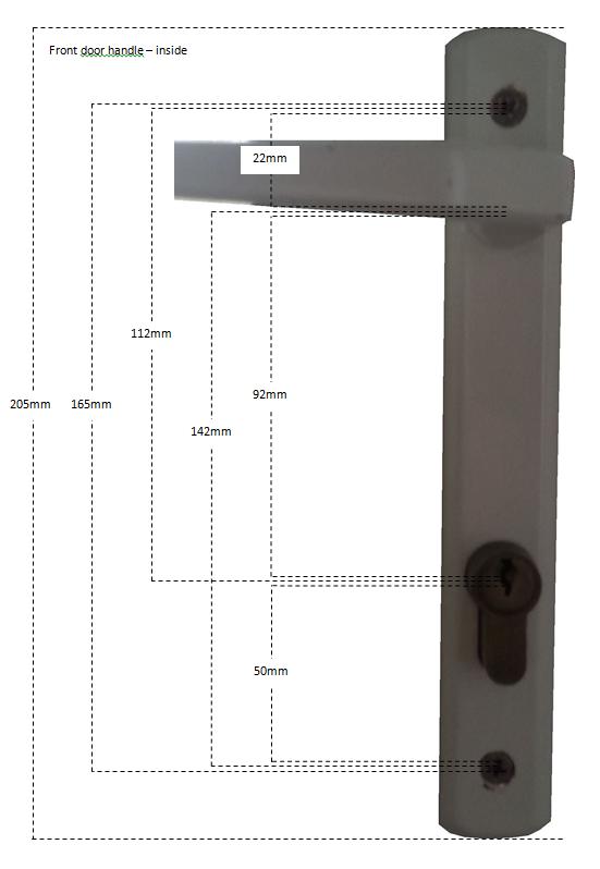

Hey,
I would like to replace my tatty, worn out window and door handles. The window handles I'm OK with - they're espag so I just need to measure the spindle length.

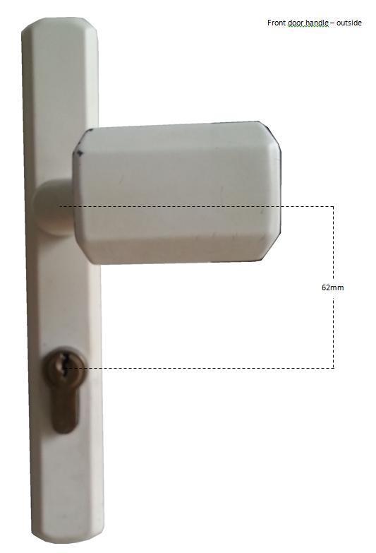

However, I'm having great difficulty finding replacements for the doors. Nothing seems to match up with what I have. I don't know how old my current ones are because I only moved in last year.

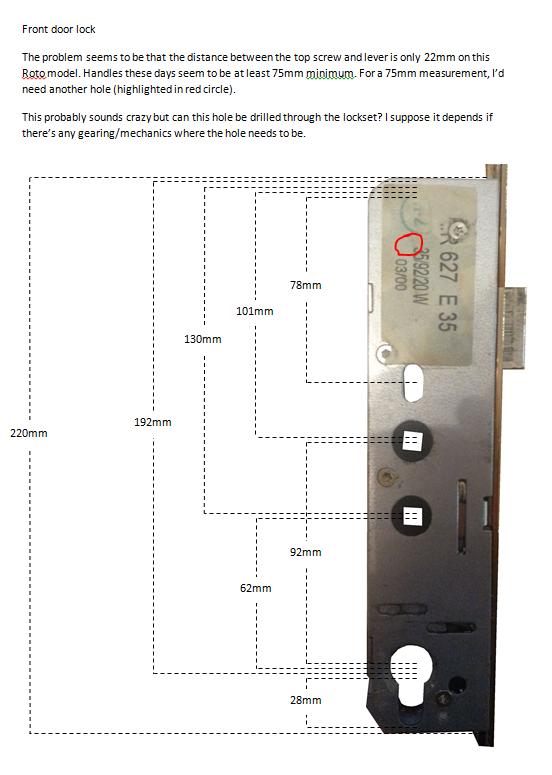

The front door lock is a Roto R627 E 35 - 35/92/20W

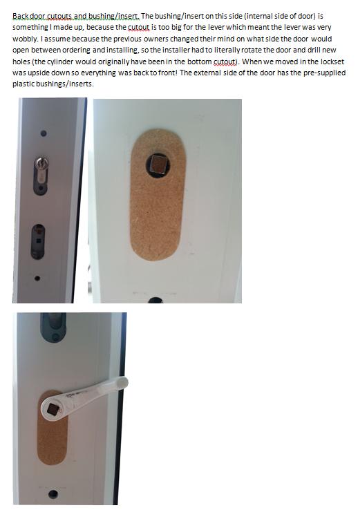

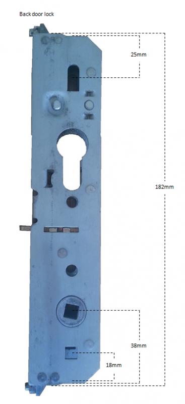

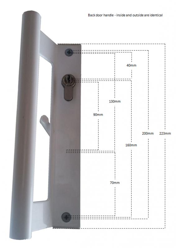

The back door lock appears to be a FUHR - not sure on model.
