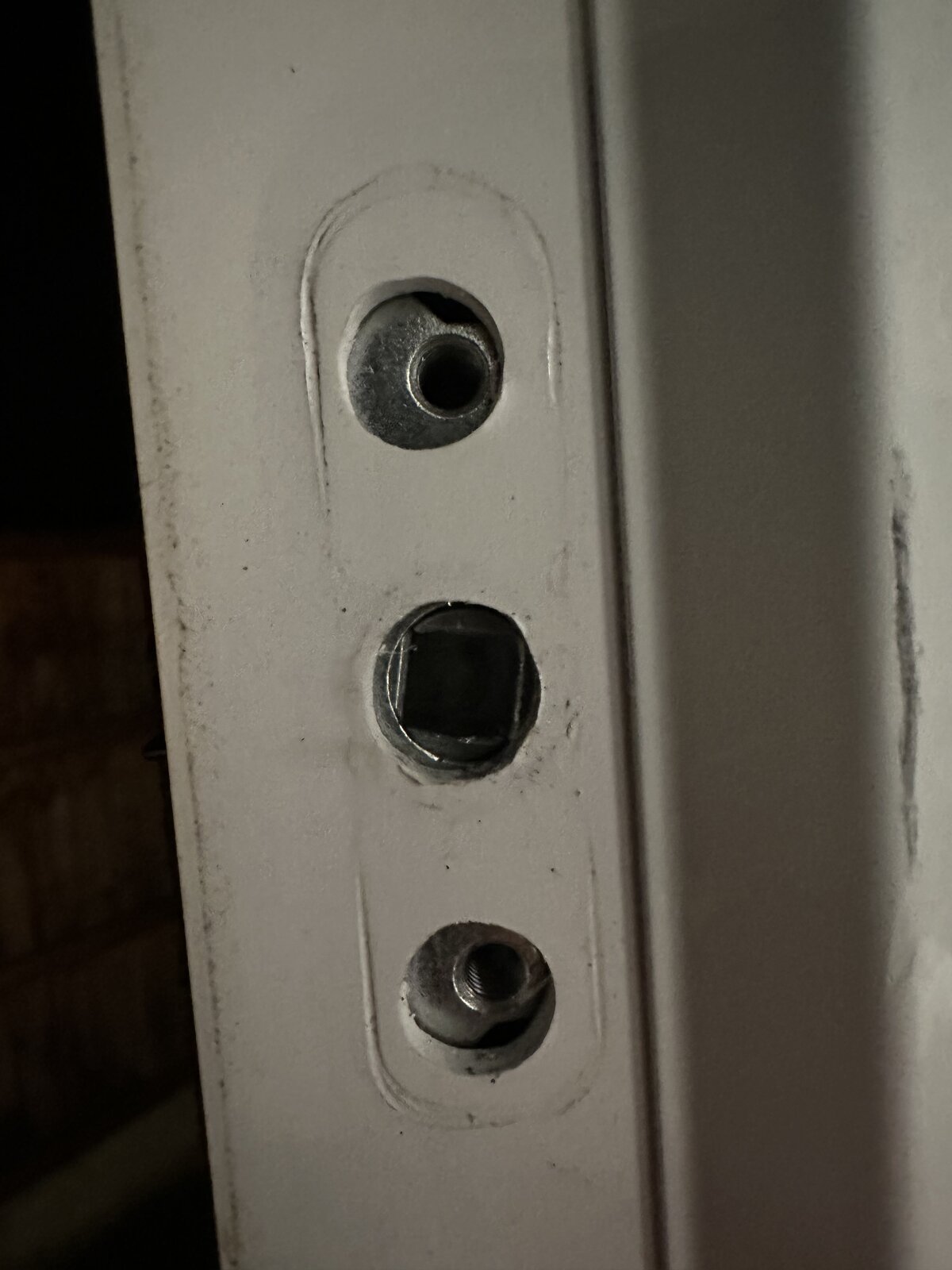

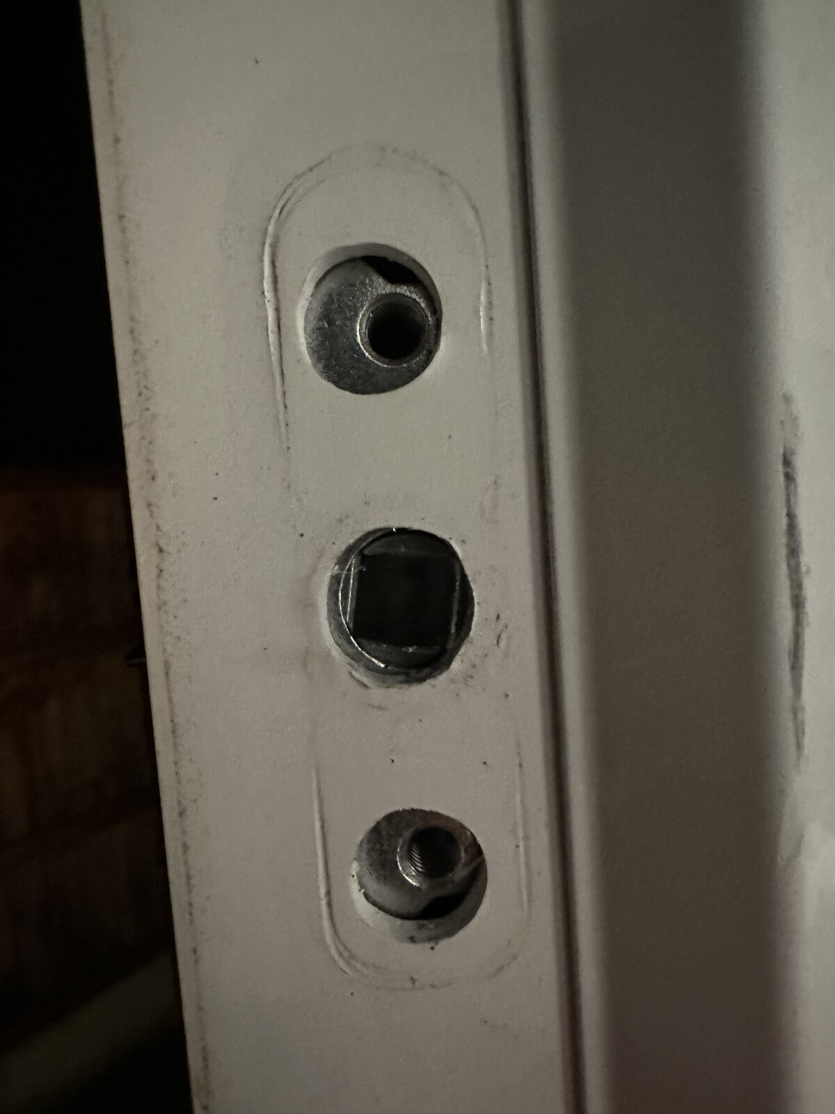

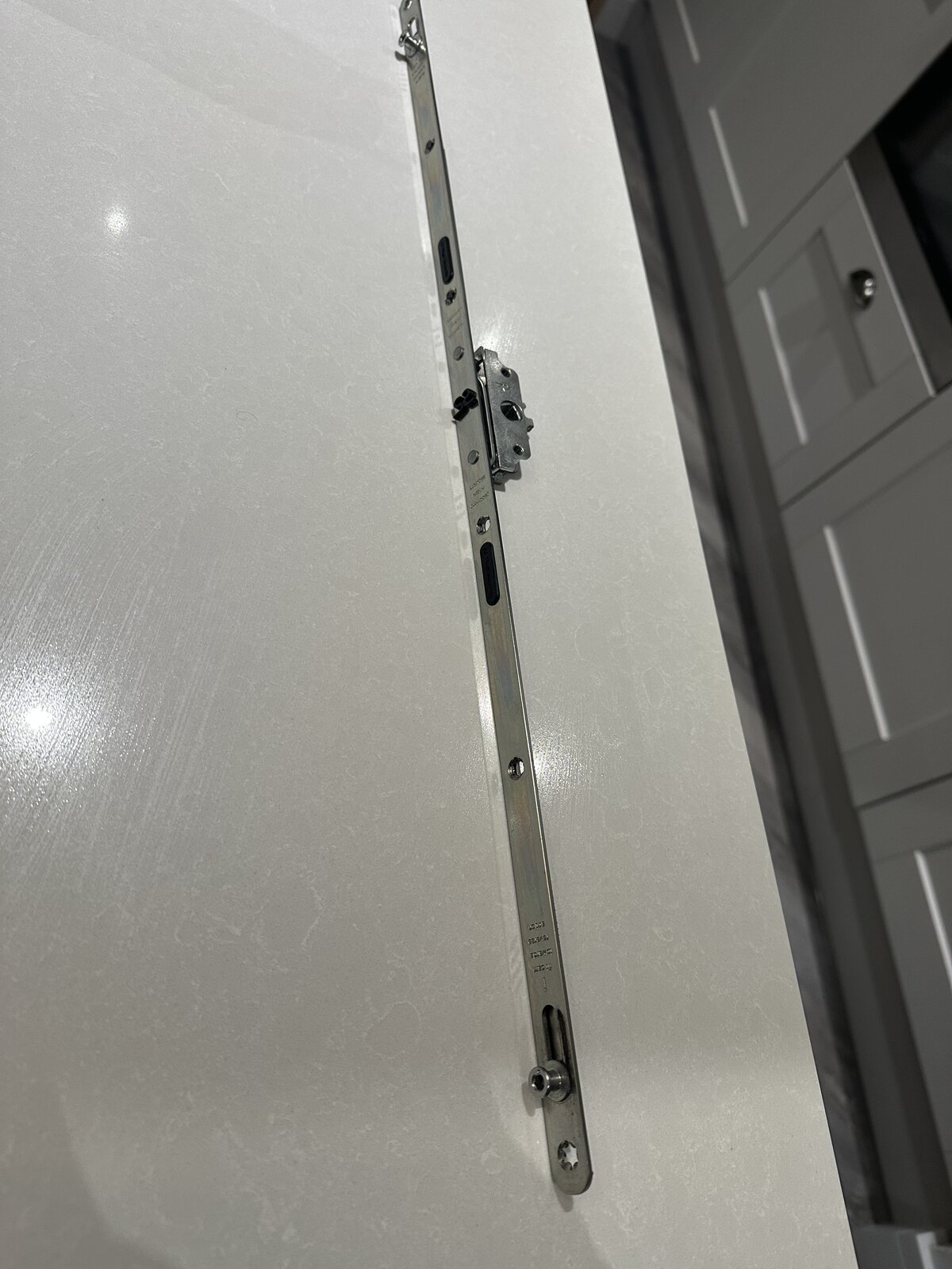

I went to close my kitchen window this evening and the handle closed but the window didn’t lock.
It felt loose so I took the espag off and realised that the spindle cog had split in half so the spindle can no longer grip to move the mechanism.
The espag is 600mm 20mm with the mushroom cams roughly 515mm apart (see image).
I’m competent enough to replace this but struggling to find one to match. It has a marking saying ‘S3’.
Can anyone advise or help please?
Thanks. I’ve managed to finally find what appears to be the same espag online.
Apparently it’s called a shootbolt gear.
Gonna call around tomorrow and see if can pick one up.
I'm hopping you found the correct replacement. If not, I believe what you are looking for is the one in the link below.
Kitchen windows usually use low height and these are made by S2 SAC Designer Locks.
