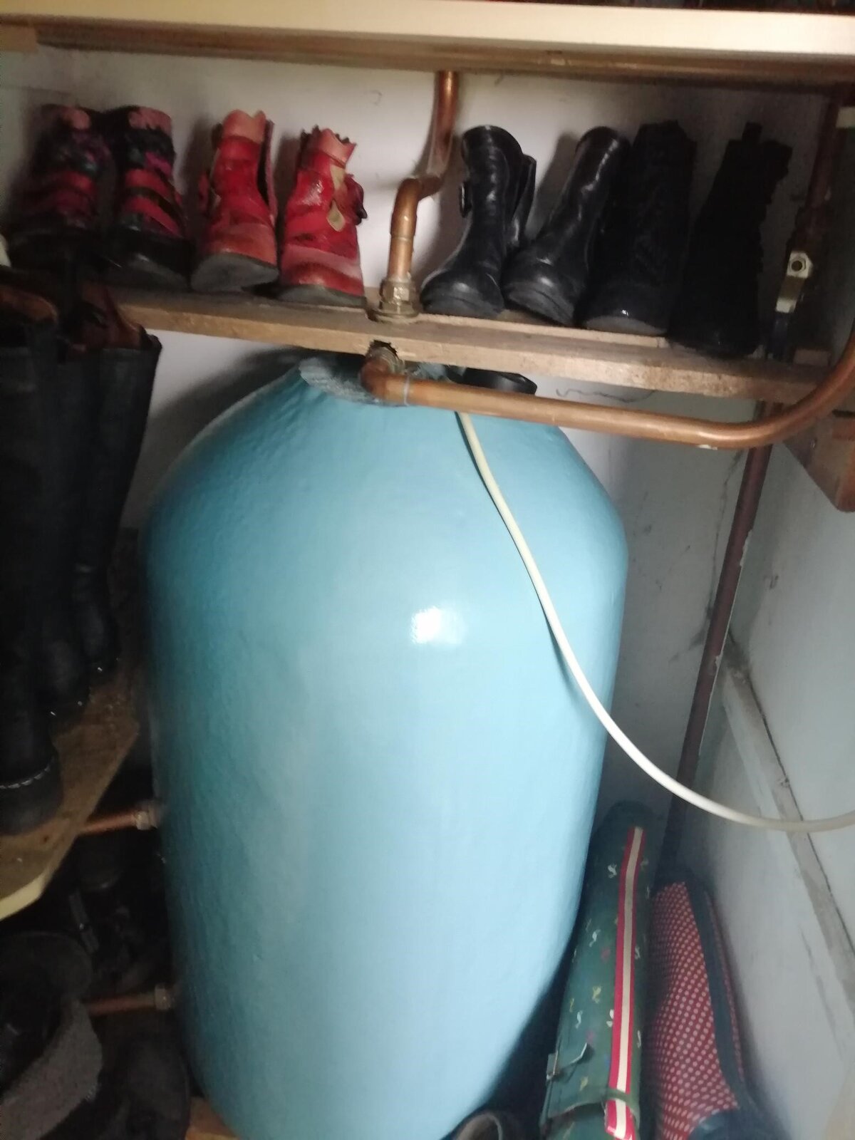

Hi All,
New to this forum so thanks for having me. I am completely DIY useless so bear with me!
I recently had a leak in my hot water cylinder that needed replacing. The house was built in the late 70's and judging from the state of what was inside it it might have well have been the original one for all I know.
Anyway, got a local plumber to come and fit a replacement, which he did, and took a lot less time than I expected. As he was walking out he said, hopefully it will work. When pushed by a slightly concerned me (had been out of hot water for a week and my wife was close to filing divorce papers), he said gravity fed systems were not really used any more and the new hot water tanks do not work in quite the same way.
Anyway, I turned the water heating back on and soon after the pipe leading from that back up into the airing cupboard was getting hot so happy days I thought.
Sadly my optimism lasted less than a few hours with the water in the tank getting no warmer than my wife's mood, so the hot water was obviously struggling to get up into the tank.
Any ideas on a fix for this? The plumber has suggested maybe a small pump could help push the hot water up into the tank but said he would have to look into it?
Thankyou!
Current cylinders will not work on gravity hot water. You will need the system to be brought up to a fully pumped standard, either a Y plan, or S plan. Your plumber should really have known this and sorted it out before undertaking any work.
If you've got a system which relies on gravity circulation, you need a cylinder which has a coil inside it designed to work in that way. They're still widely available either same day or next day at all good plumbers merchants but the correct cylinder must be used. Lobbing any old thing on there won't work as you've now discovered. Fully pumped cylinders use smaller bore tube in the heating coil, and often have rises and falls in the coil to maximise use of the available space. Gravity coils need large-bore smooth tube which descends continuously from the top (flow) connection to the bottom (return) connection.

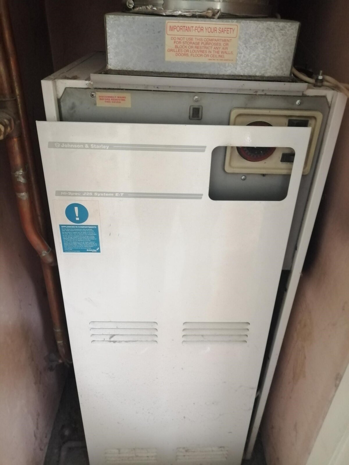

Thanks for your many replies - I appreciate you taking the time. The Boiler is a Johnson & Stanley Hi Spec J25 System E-T which also runs the heating via a slightly antiquated warm air system, but it does the job.

Rightly or wrongly the tanks in there now - would a small pump pushing the hot water up to the tank work do you think / any suggestions, etc. I don't have a pool of money right now to do anything major unfortunately.
Will upload some pictures below as requested.

It's quite common for older boilers like this to have pumped CH and gravity circulated hot water Chris.

Your options would be to either replace the cylinder with one of the correct specification, or fit a timer, cylinder thermostat, and circulation pump. I'd suggest that as your installer has mis-specified the original cylinder, it's up to them to replace it with the correct one free of charge.

but a better solution would surely be to convert it to fully pumped.
my old mum had a gravity circ cylinder which was very slow to heat, and uneconomical in summer as it relied on the timer and boiler stat. converting it to pumped fixed both those.
it also shifted a lot of sediment out of the pipes and coil, which showed in the Magnaclean.
