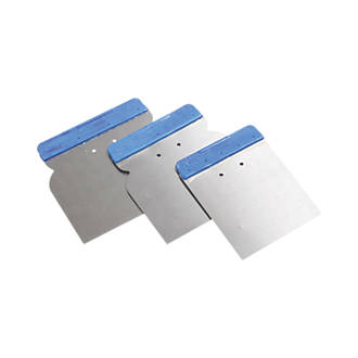

You can use fine surface filler on top of the lining paper, i would suggest you invest in a french filling knife set (which allows more control).
So fill indents, sand back, fill again, sand back, prime the filler and then overcoat the whole room.
French fillers look like
Worth bearing in mind that you can line again on top of the lining paper, providing you do so at 90° to the first layer, i.e. if hung vertically, hang the next layer horizontally, or vice versa.
Funny enough I just bought a set of french filling knives this morning. Thanks for the advice on fine surface filler. The incoming light makes the imperfections really stand and I can see now there are more than when I first looked. I will try the filler onto the paper itself, but as there are so many indents, I may be tempted to carefully remove a few sheets of lining paper and work directly on the bare wall.
As there are so many indents, can I smooth out the filler with a damp sponge?
I wouldn't sponge filler.
Go proud with the filler, it dries quite soft and making a block for the sand papering will remove filler surplus quite quickly.

View attachment 106902 Correct prep on the bare wall would have have been better.
The Poundshop sells them, 4 blade sizes for a quid. There are branded as the Tommy Walsh ones.
