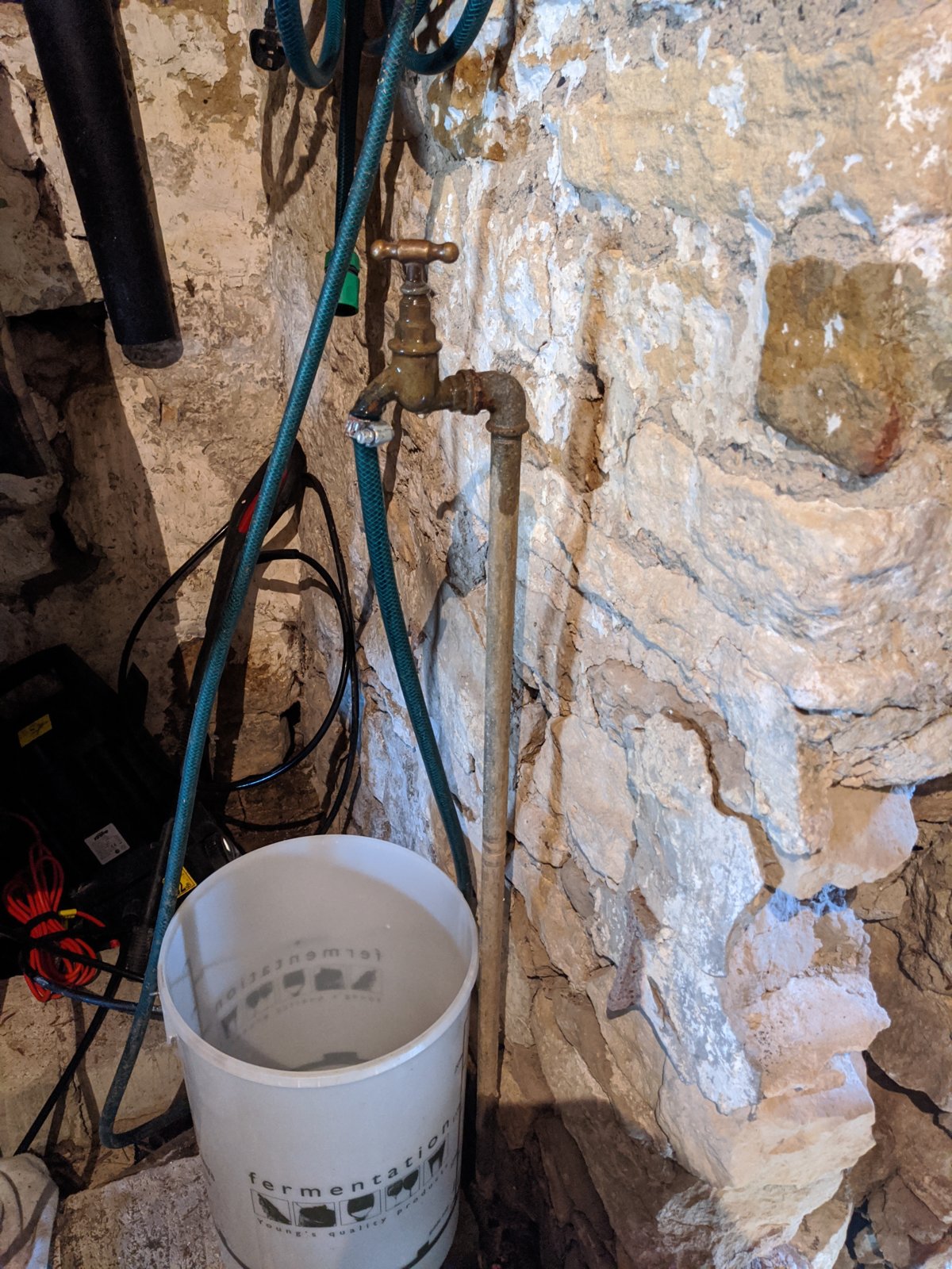

Hi all, this is my first post.

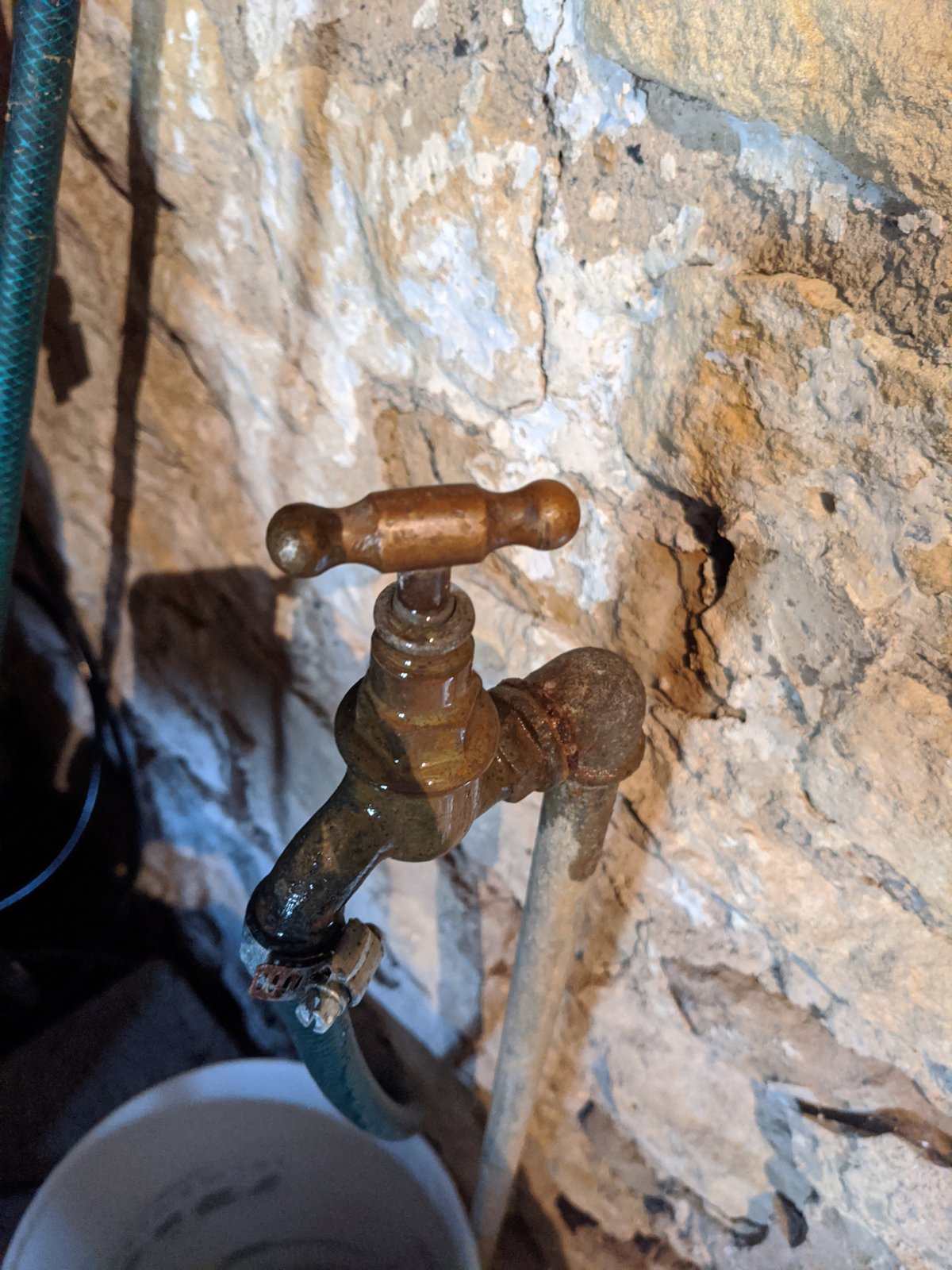

I have a tap in my workshop that is old and faulty. There is no way to isolate it from the water supply (I live up a hill and the water comes from a spring). The tap is on long exposed pipe I can tap into. How can I add a tap on the pipe without drowning my workshop? If it goes wrong the water will never stop. Any advise appreciated.
What diameter is the exposed pipe? Also you’d need backflow protection (I’d have thought).
Does the pipe come from the house which has its own stop cock?
Is the pipe copper, lead or plastic?
Pictures and more detail would help
Blup

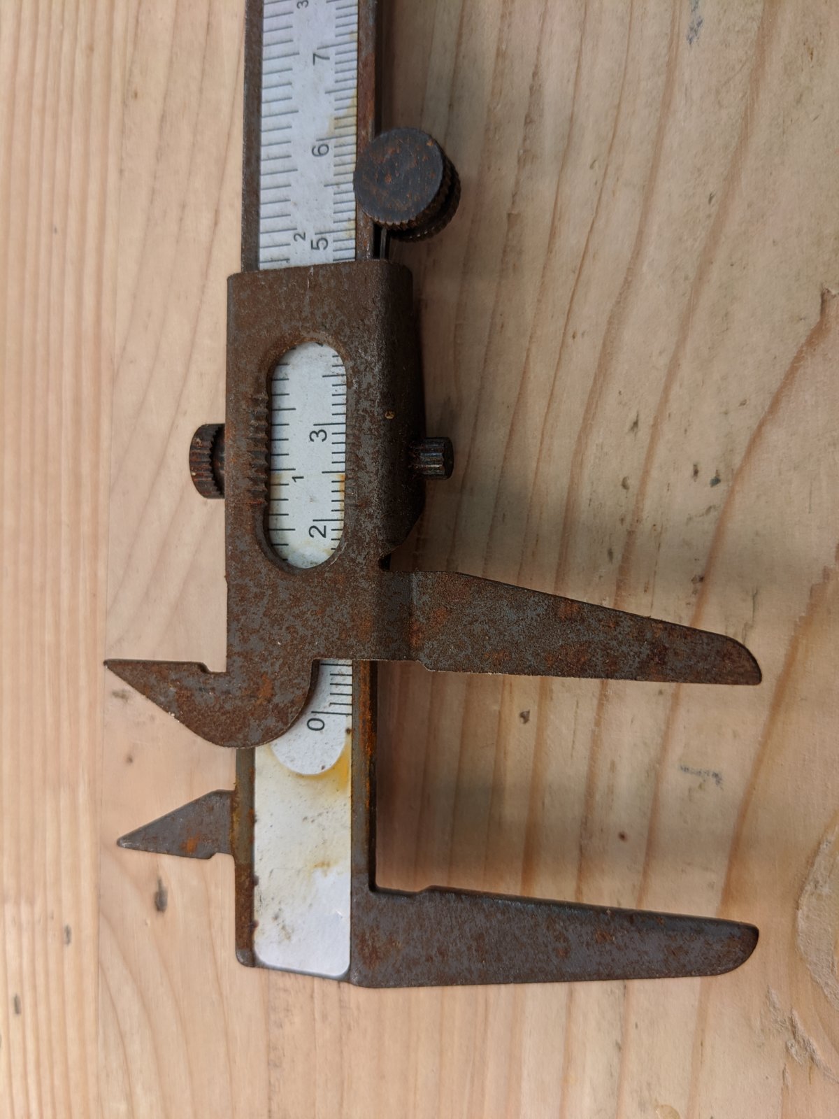

Here are some photos.
There is a stop tap in the house but the workshop comes off before it. There is no tap in the street like a town house. I'm not on mains water so none of the normal stuff applies I guess.
Pipe is 22mm.

That maybe a little more difficult using a freeze kit as it’s iron pipe. You’d need adapters, which would then extend the pipe further up the wall.

The water flows by gravity down a hill? How about isolating where the water enters the pipe from the spring. Irrespective, the workshop needs an isolator valve in the main water pipe.
What's the pressure like? I'd be tempted to do that live if you don't mind a little bit of water escaping
Thanks for the tips guys, there is quite a lot of water pressure and the floor slopes into the workshop. If I turn the spring off it will stop water for every house in the lane as it comes to me first. I'm not even sure how to do it or where the spring is as it's on the estate land.
It sounds like a big job suddenly.

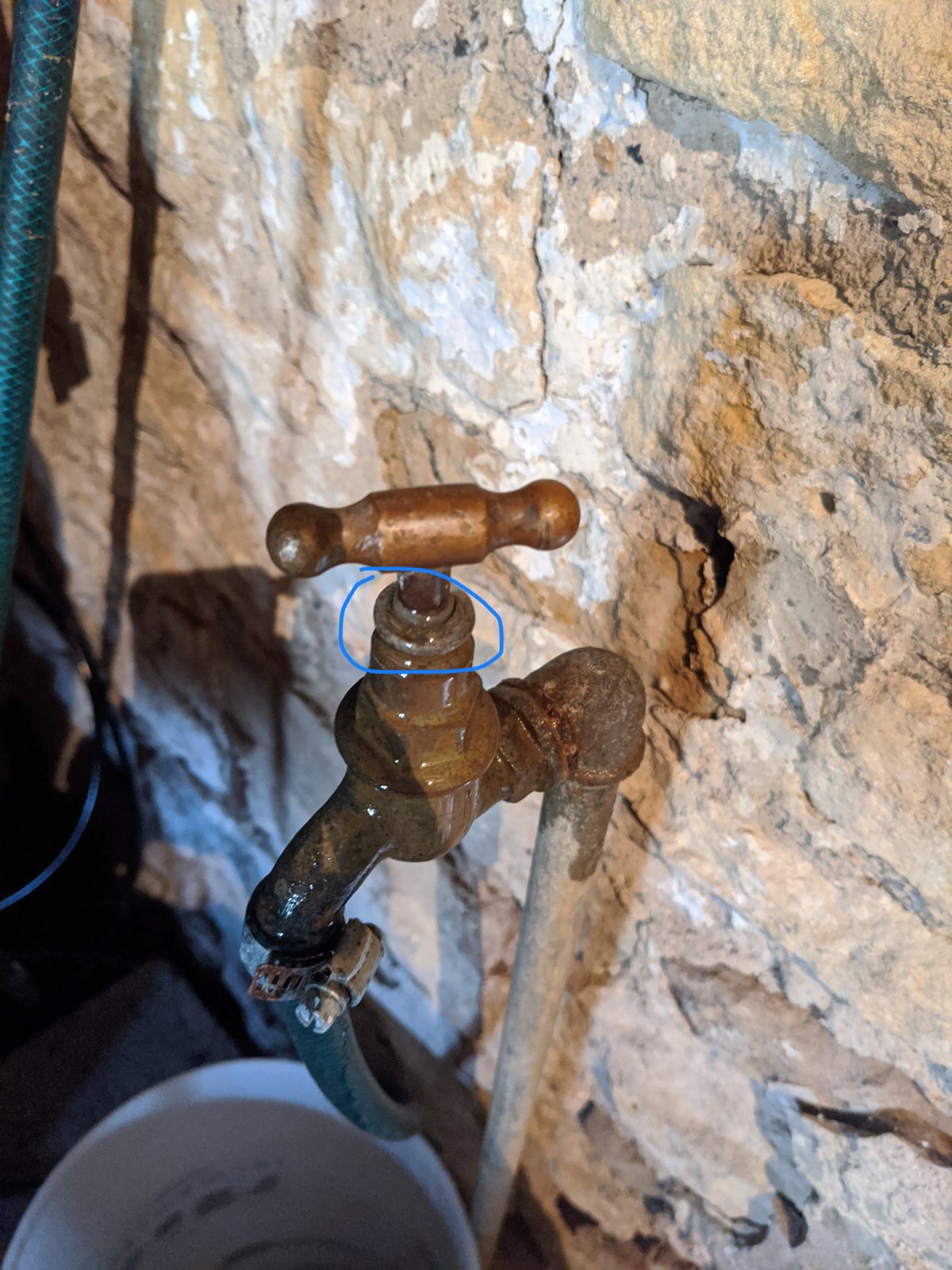

How about repairing the tap. when I turn it on water gushes out of the area where the capstan meets the bib. is it repairable in situ with water gushing out?
If it’s just here (circled blue), you should be able to back the gland nut off, and wrap some thin ptfe tape or loctite 55 into it, in a clockwise direction and then tighten nut up. Should still have backflow protection though.
