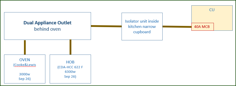

New oven - with conflicting connection information.
is there an assumption that both appliances will never be working at full power?
Right. It’s called “diversity”. The elements are controlled by thermostats and cycle on and off; the average load is well below the max.

This good news for me then (I've never heard of diversity in this area, so thanks for the education) - I already have a cooker connection unit that has two feeds out of it, but was concerned about the capacity of the feed.

The living space has recently all been replastered and re-decorated, plus the CU has no spare ways in it, and there is no space for a new CU, so adding a new feed specifically for this oven is not an option.

There is an isolator in the cupboard, I could fit an FCU there and that was one of my plans, but other posters here have advised an FCU is not needed if I connect to the cooker feed.
Hello All, I did some investigating last night.
There is an isolator and 6mm cable from it pinned to the wall behind the cupboards so access is not an issue.
There is space behind the oven for a Twin appliance connection unit (which I already have), so my current plan is to fit the connection unit behind the oven, feed the cable from the isolator into it, then run both of the appliances from the connection unit:
I did some checks with an online diversity calc, which advised the diversified load would be around 27A
Hopefully this plan is all OK.
