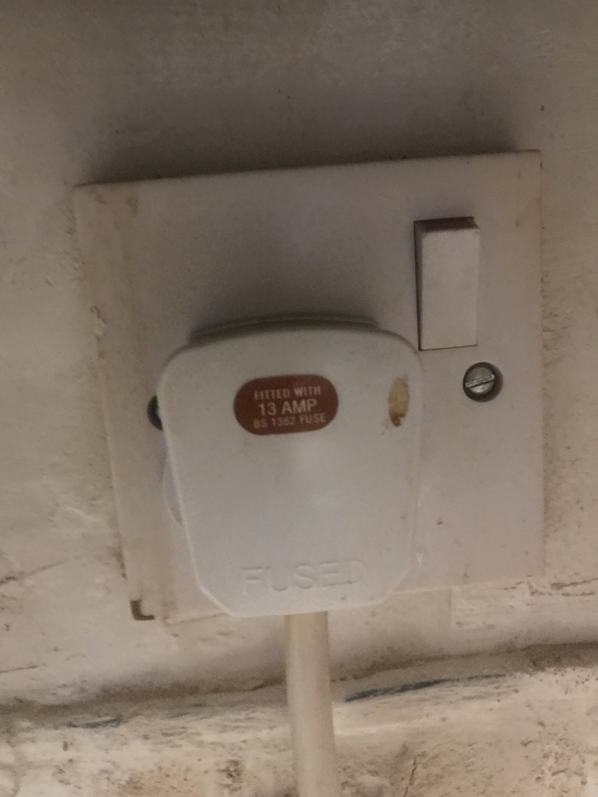

Wondering if anyone could help, I’ve got a oven with plug on it which is plugged in behind the oven
Which has a switch to turn on and off on the wall
My new oven is hard wired so needs to be wired in, how does this work and is it a big job?

I’ve been advised by a electrician to put a plug on the new oven instead of wiring it in as it’s only just over the 13 amp, the oven is 3.45KW and said it will be fine, is this safe and won’t cause no damage?
I would advise against it.
Whilst it can be argued that it is technically acceptable, (some) plugs don't really like a full 13A, let alone a bit more.

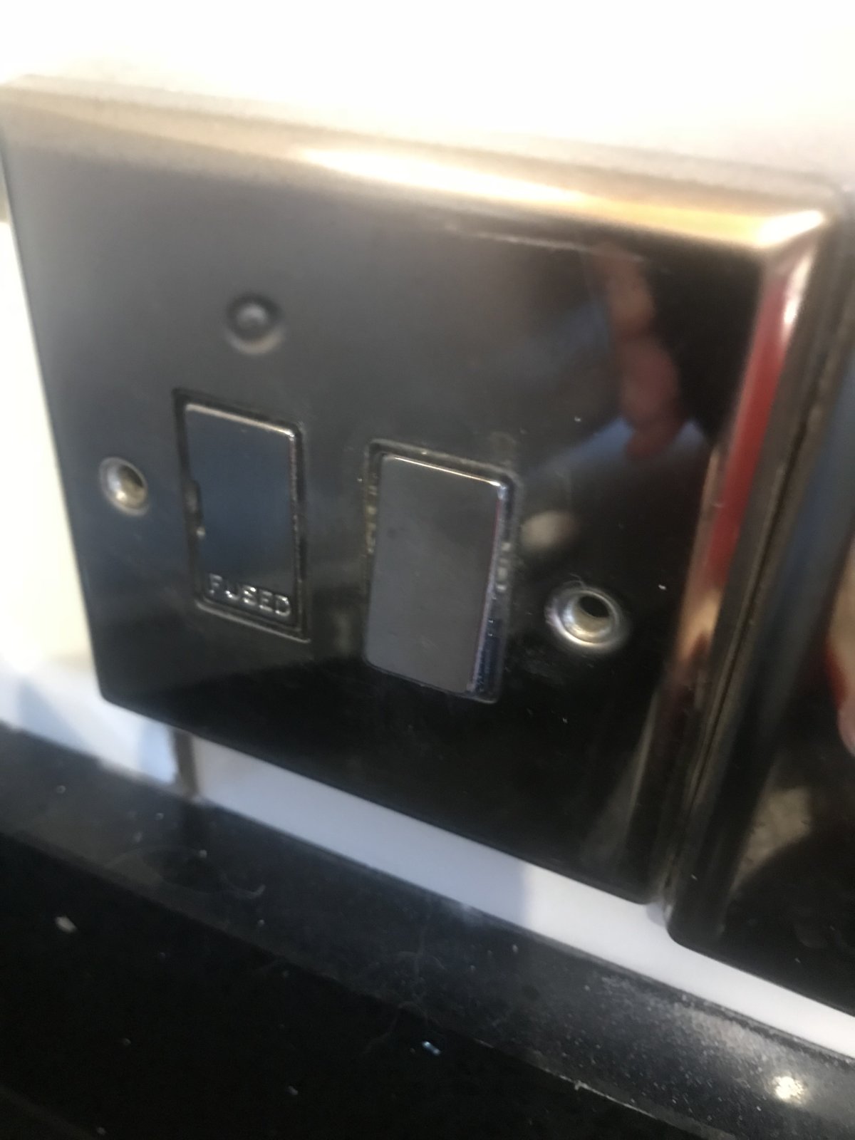

Do you know if there’s much work involved in changing a plug socket around that’s connected to a fused spur to be able to hard wire it in instead of a plug?
Thanks for the replies
Probably not much work. But you still are limited to 13A max, which is more than the oven’s rating.
13A is the largest fuse for an FCU, or a BS1363 plug.

That “switch” on the wall is a switched FCU and will need to be replaced with a 20amp double pole switch. Then you can hard wire the oven in.
