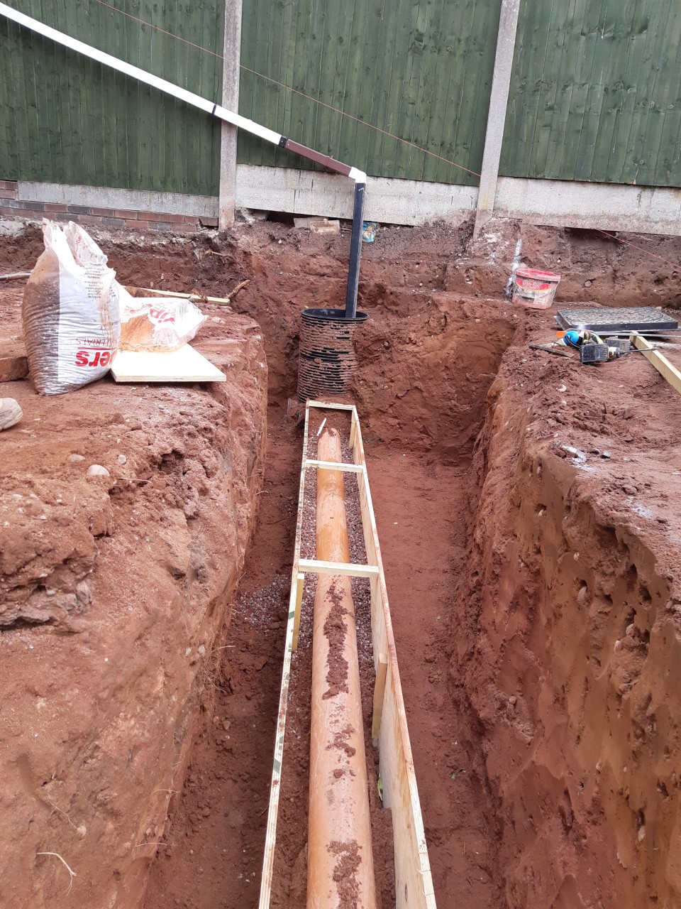

Our latest jobby...
..we have 21.2m of trenches. Just shy of twelve cubic metres of concrete was poured.
At a standard say 500mm thick foundation at 600mm wide this would equate to about seven cube, being generous with the crooked sides etc.
At times the concrete was 1m deep. Not because it needed to be but because it costs less than block-laying. As I have shown, the house foundations are about 150mm or so. Please don't comment on building related issues because you have not the first clue.
