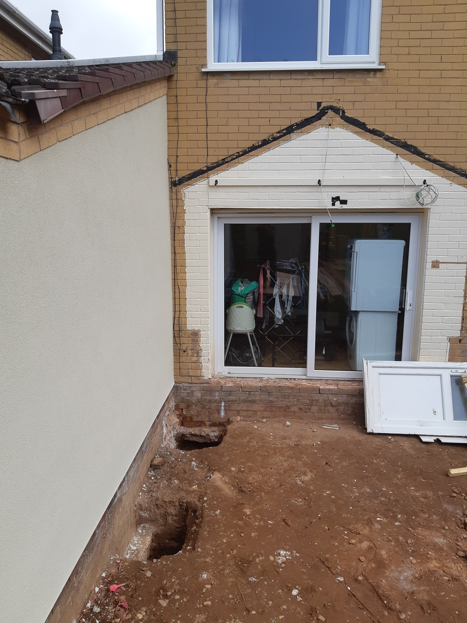

(New) Porch pulling away from house

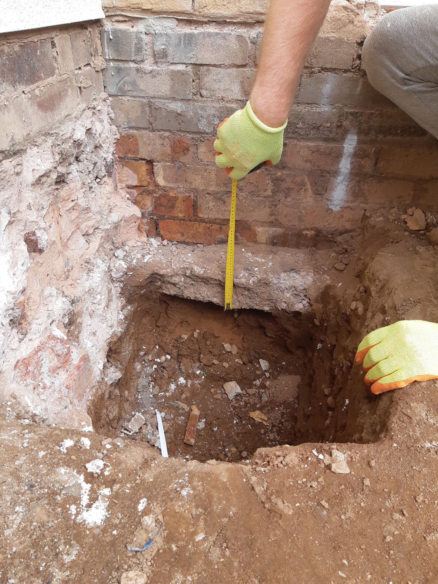

Would you build your own house on 200mm footings?

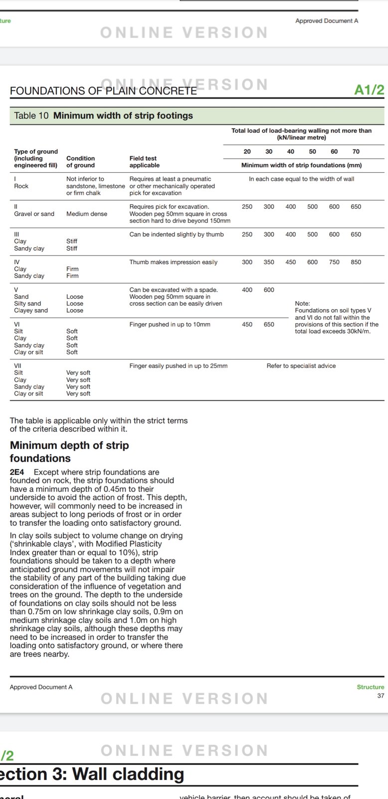

Just to clarify the incompetence shown in this thread, see this table kindly provided by noseall?,and take advice from a qualified person (structural engineer or building control officer).
Page 36/37.
https://www.gov.uk/government/publications/structure-approved-document-a

Nowhere on that shows minimum depth of concrete, just width and underside of concrete to protect from frost.
The houses i'm building now have trench foundation 600mm wide 225mm depth, trench dug to 1000mm,which is pretty standard.
That's because at 1000mm there's solid ground which allows the 225mm concrete.
That's why fundations must be considered accordingly to the ground.
A 200mm will do for all approach will inevitably end up like the porch in this thread.
