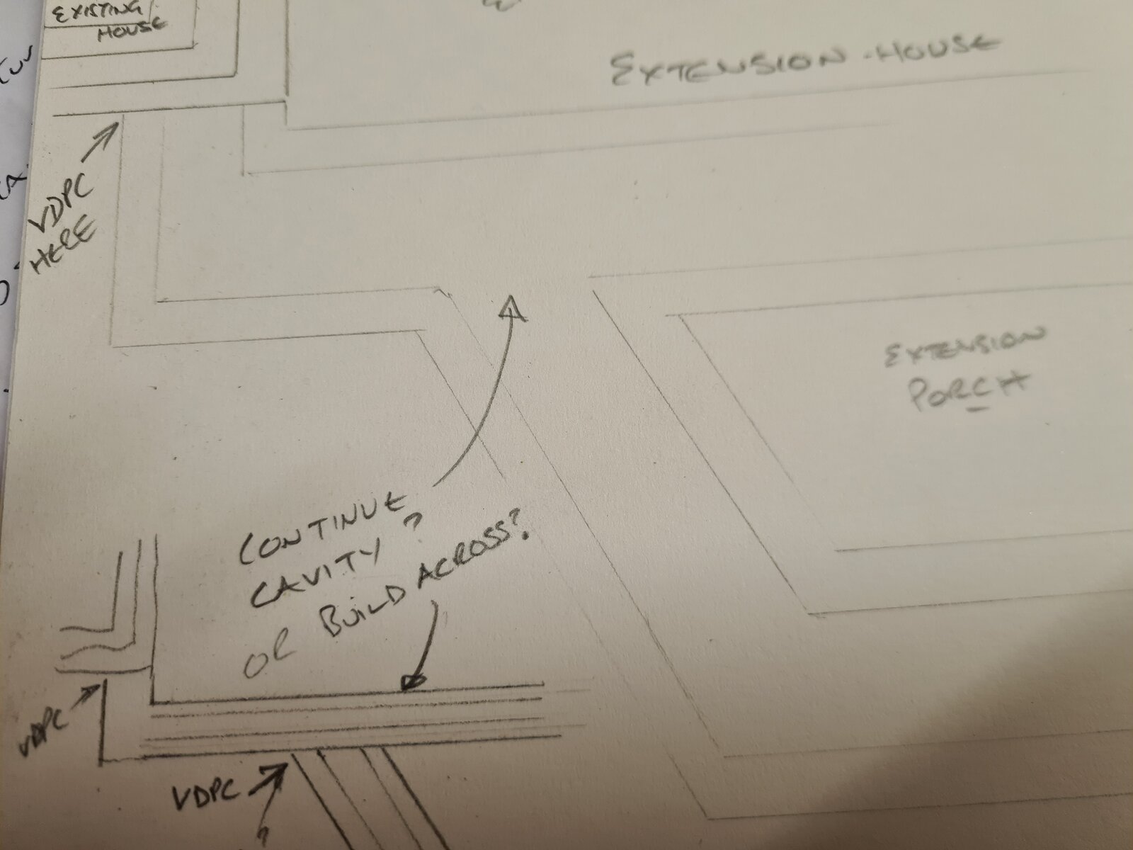

Is it the done thing to continue a cavity into adjoining walls? The main extension has a porch and originally I was just going to build the house wall then 'attach' the porch with wall starters or brick bond to the porch walls and have two separate cavities.
But now I'm wondering if I should make the cavity a T Shape?/continuous?
No, but you should insert a physical vDPC where an external leaf becomes an inner leaf.

No, a vertical DPC is cut into the cavity in-between your wall starter not like an expansion joint.
Some cut a 50mm sliver all the way down to house DPC, some just cut a slit with grinder and slide in the DPC.

Not sure if its the answer to my question but suspect it probably is.
This is all new brickwork. I never considered this junction detail when drawing the plans.

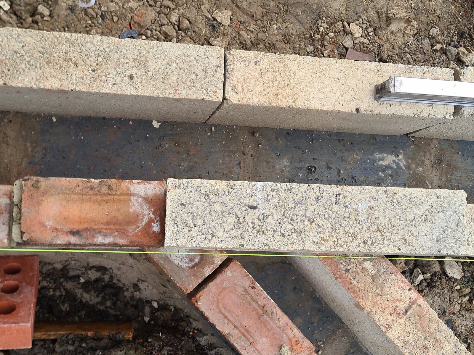

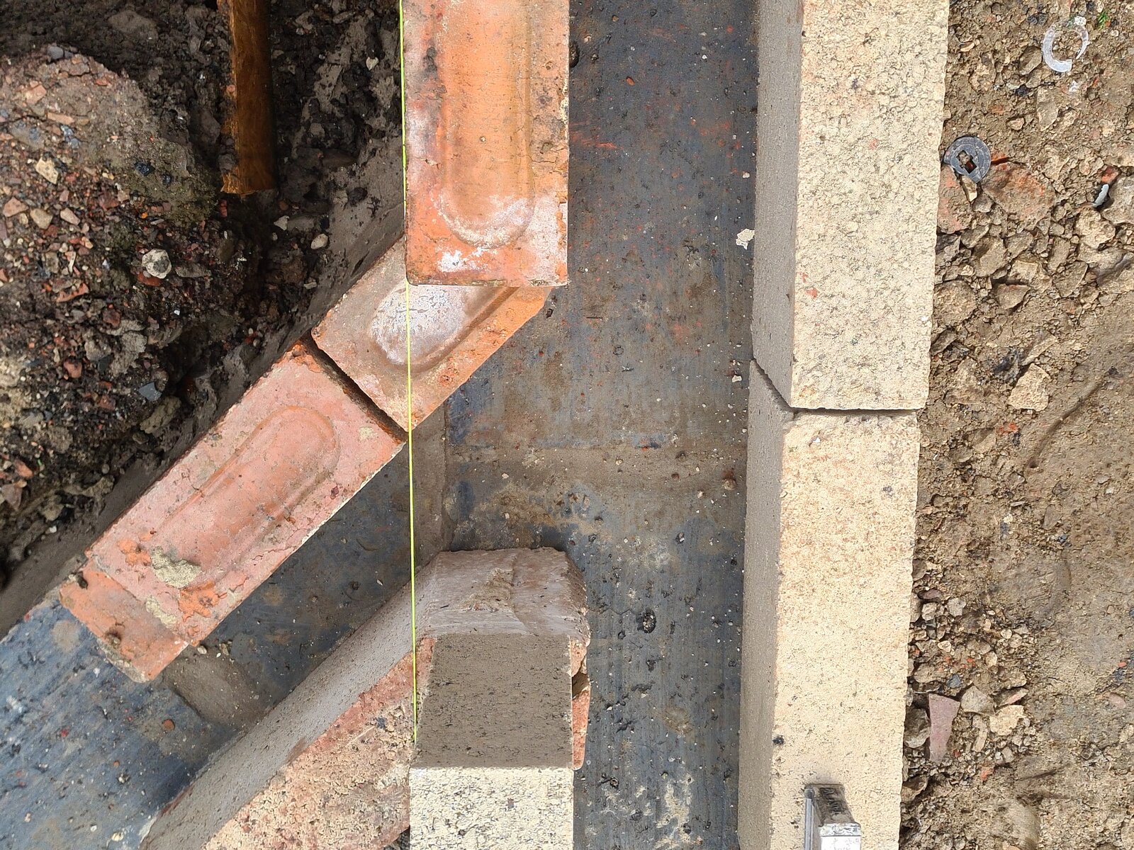

I'm still unsure about this detail.
Should it be like a or b ?
Any opinions..
