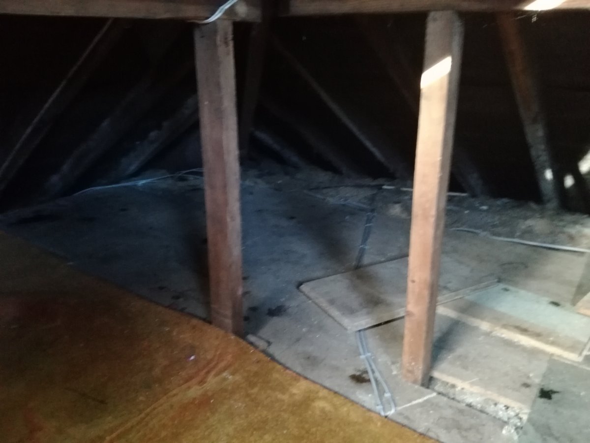

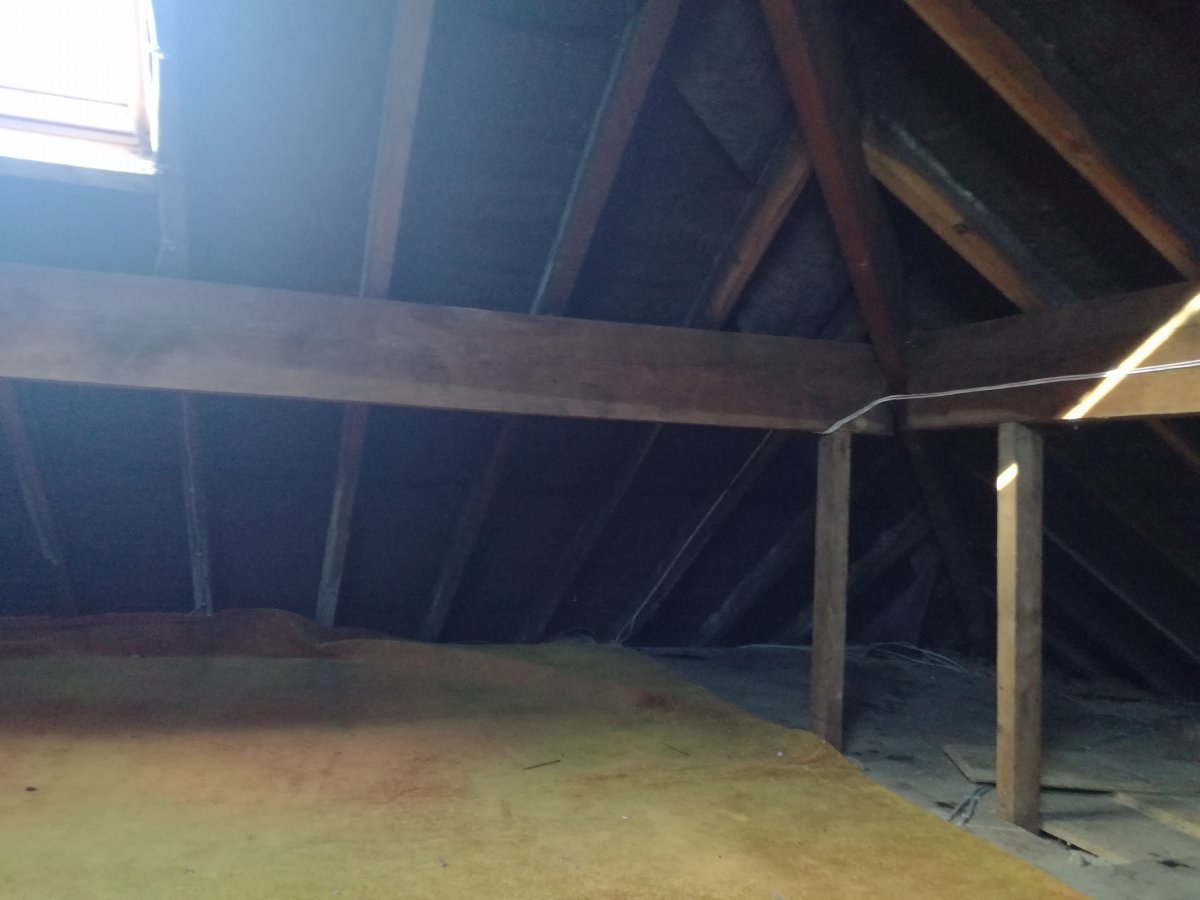

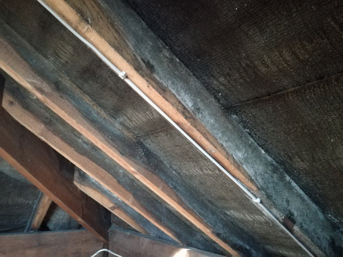

Hi all, im due to have work started on my new roof tomorrow. the house is a 1930s semi. been there couple of years now, the membrane is not breathable so moisture collects on it and drips in to the floor and causes the wood from the roof to get wet and its currently looking like it has mould all over it. house still has original tiles so having all those replaced aswell. i am hoping once the new roof and membrane is on this should stop any damp problems. i havnt really spent any time in the loft but ive just been up to clear some stuff out before they roofers turn up tomorrow and i have noticed that my purlins are supported by four bits of wood and two of these are just proppped under and not screwed in or fixed. they seem to be under quite a bit of stress and are on a slight angle so this is causing me a bit of concern.
i am also planning on having the loft converted once the roof is done. it was partly been done by the previous occupants its mostly boarded out with some really old crappy looking fibreglass under. what are peoples onions on me taking this fibreglass out completely? will i need to replace it or will it be best leaving it out so the house can breathe better and heat can circulate to the loft? heres a few pictures

The boarding may just be on the original ceiling joists, so couldn't be relied on for the basis of a loft conversion; check the size of them first.
The supports aren't leaning to any great extent, so don't worry about them for now. Looking at the water discoloration on the rafters, suggest to me that it may be due to leaks higher up the roof rather than condensation problems. Has the fibreglass been pushed right up against the soffits, and stopped the airflow into the roof which would have dealt with the condensation issues.

Your purlins are landing on a hip rafter - each purlin seems to be supported by a RS 2" x 4" - you might have much to worry about if the roof is point loaded above the purlins during its renewal.
Have these remedial details been accounted for in any proposed design?

condensation without a doubt. It has 1F felt as underlay this certainly aggravates the problem when not properly vented.

The roofer says that these supports have been added after at some point and will add support a bit but are not essential. He has done a few other roofs on this street so I suppose he should know. I just don't get how the purlin would be supported it that 2x4 wasn't there . I expect it runs the full length of mine and my neighbours property. It's suported by the brick partition between our properties but nothing else apart from these Battons?

Interesting scenario Mart, we had a recent post regarding a similar setup, and there was a disagreement on whether the support was actually supporting the perlin.
