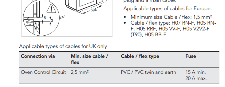

The new AEG BE300360KM Built-in Oven 0.79 kW/h/Output 16 Amp.
Found this:
I can't find the actual rating. They don't seem to like giving it these days.
There should be a sticker on the oven somewhere - inside the door?
So, would seem to be usual 15A/16A appliance.
16 x 240 = 3.84kW max.
+ 7.9 for hob = 11.74kW = 49A
so design current of 22A.
