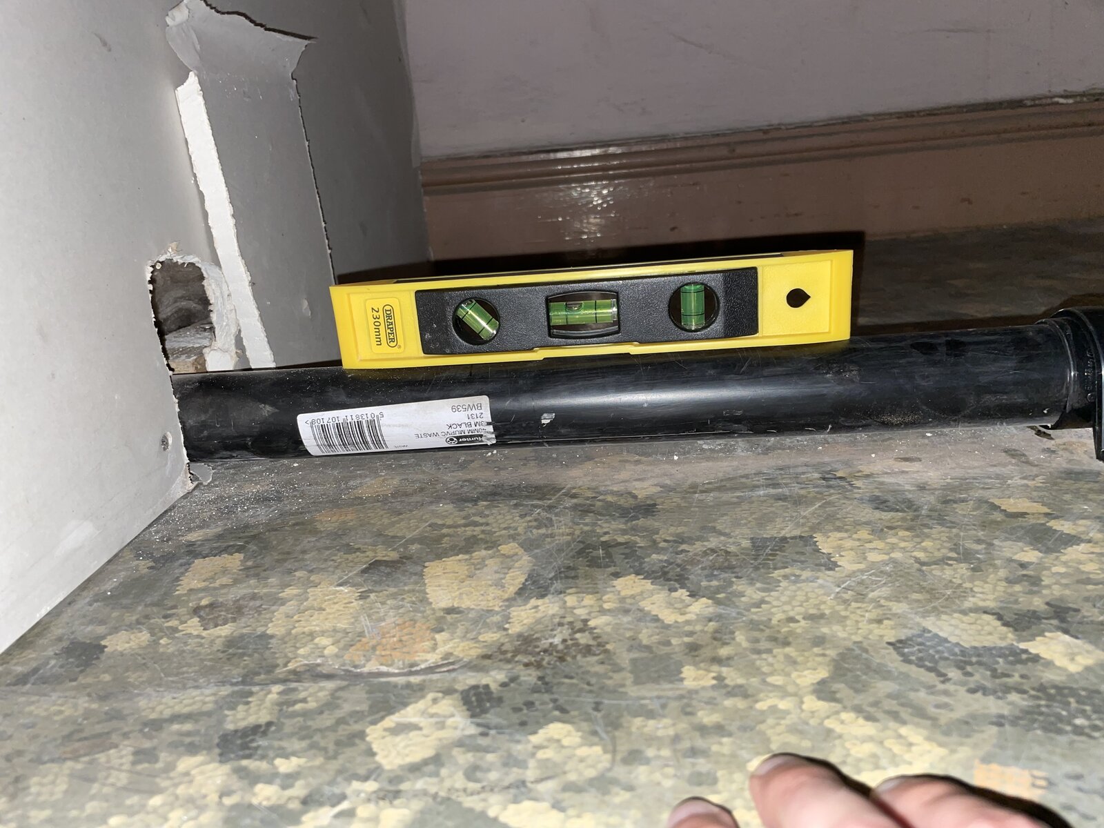

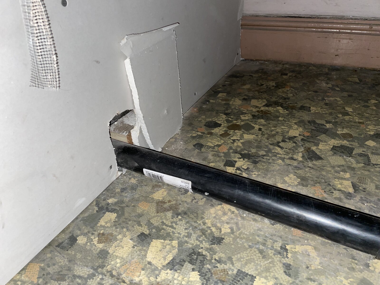

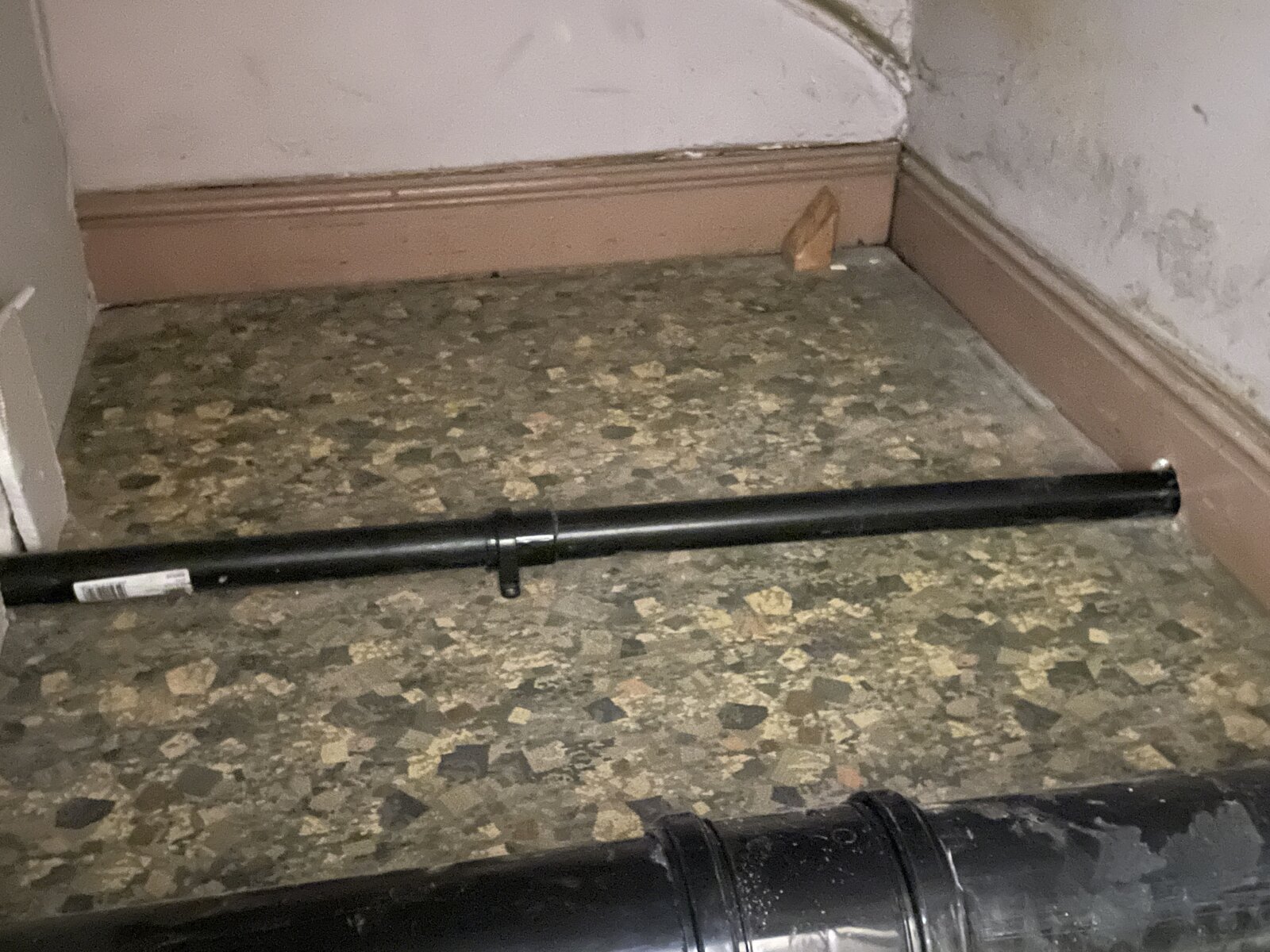

Here are some photos. The tray has been raised with a riser kit so there must be some fall on the waste. It runs for a meter (if that) through an eaves cupboard and then straight out into the soil stack. 46F6ED79-FAFA-4135-BAB0-8FE8BF1AFF83.jpeg3FEBD3F1-AE0C-4457-95AC-C895A8CB0D34.jpeg7FE4A936-9E6A-4FF4-903A-1AF652B76362.jpeg87534F13-90CD-4163-B74A-8690DE1B4997.jpegE375A3BC-EFED-4A23-875A-C5E313E7EC8D.jpeg
That pipe doesn't look like it has any fall at all. From your pic it looks perfectly level. Is that the case?
It’s has a very slight fall according to this spirit level and would have thought it has more of a fall from the shower tray given it’s on legs?
Is the lack of significant fall likely to be the issue and not the trap?

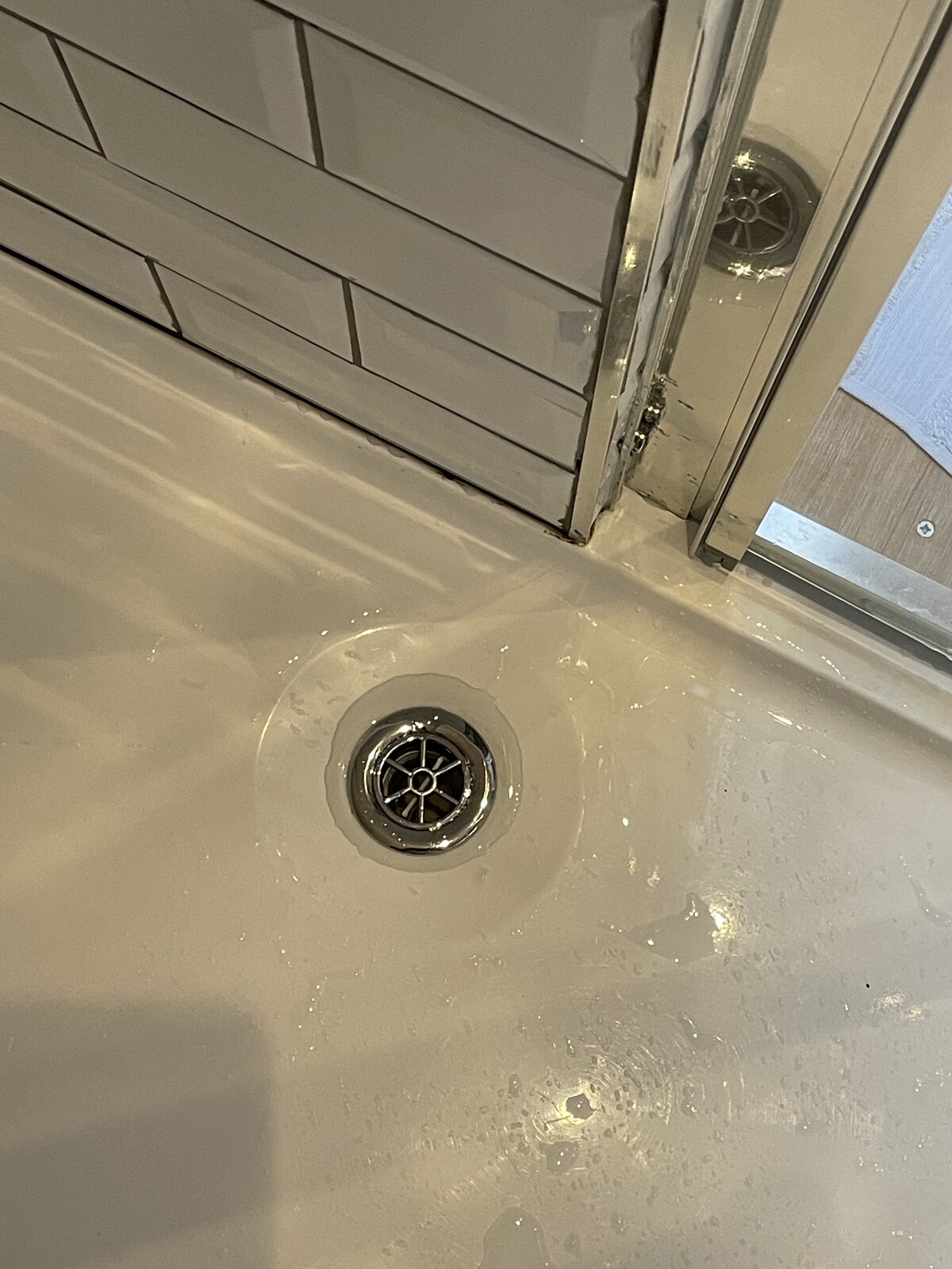

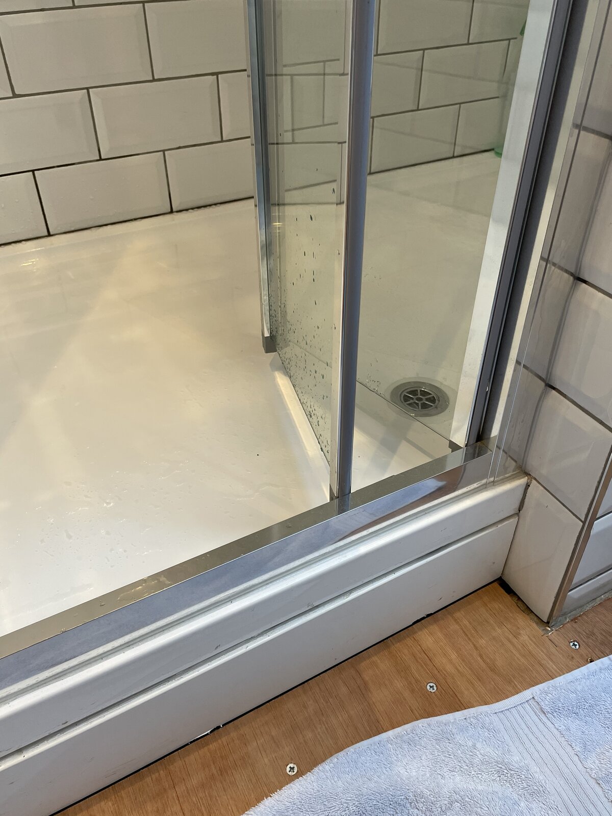

It would be the 1st thing I'd check. Can you post a pic of trap under tray?
The side panel is siliconed on so would rather leave that for now and remove if I need to get the plumber back.

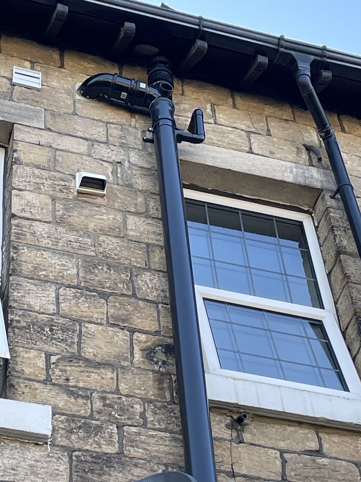

Tilers mess is quite likely, especially in that double elbow arrangement at the stack. Which looks like gutter pipe to me....if you have separate surface and foul water drainage that might be another problem...
EDIT Nope, I'm wrong, that is 110mm.
You'll need to keep on top of hair etc in the shower trap, any sort of build-up in that double elbow will be impossible to clear without scary chemicals

You have a Durgo (AAV) fitted to the top of the soil stack.
Change it to a proper vented stack that goes around the eaves and above the roof.
Your issue is caused by air trying to escape out of the shower waste, whilst water is going down it. You have a cushion of air that the waste water is trying to push past.
Like trying to quickly pour water out of a gallon container... You get a glug, glug action.
How long is that run and why is the pipework sitting where it is in that room? That just isn't right at all. The biggest concern is that the 'plumber' actually agreed to fit the waste like that. It should at least be run along the wall alongside the soil pipe seems to be in there too?

As mentioned your stack isn't fully vented either so the minute the waste pipe fills it'll struggle to flow properly due to back pressure, that and it'll be trying to overcome the trap seal too so it has a lot to push against without much pressure from the water until the water fills the tray. See it all too often, small tray waste, too long a waste pipe run, waste pipe not large enough to help with the flow and not enough fall and then it's compounded with a AAV on the top of the soil pipe. Was it a 'bathroom installer' or a plumber that performed the work?

The room the en suite has been built in is an attic bedroom and the pipes in the photos have been run through a small area of the eaves which was previously sealed off and is now accessible via an access door they have had put in. The run is 1.2 meters max.

To easily test whether the stack needs positive venting or not by removing the AAV(durgo) off the top and see if that then allows the tray to drain properly. If it does then the soil pipe needs an open vent and will need taken up and over the gutter.
