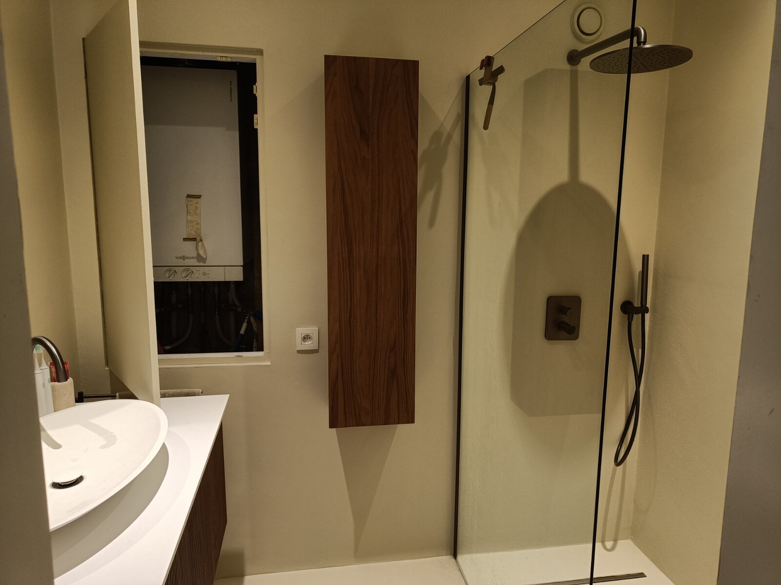

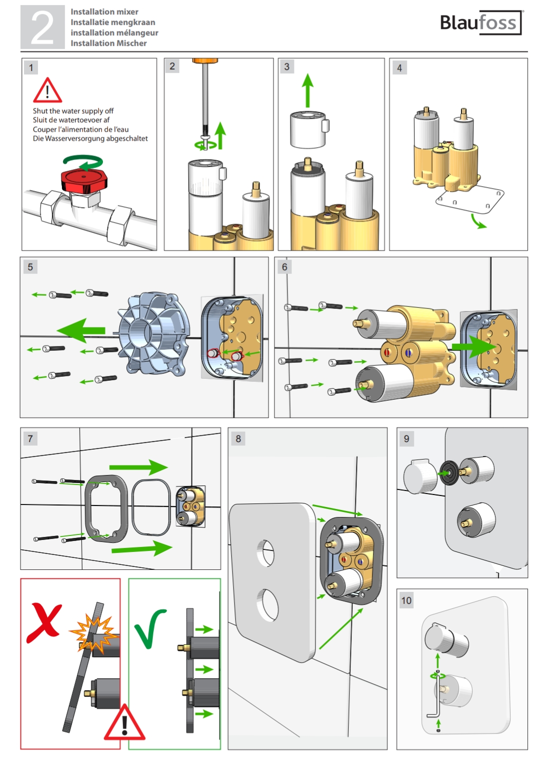

We recently renovated our bathroom and installed one of these: https://www.x2o.be/nl/blaufoss-smar...-kraan-brushed-gunmetal-kra-79636-95415-92943 (You can find the technical documentation in the Downloads section at the bottom of the page.)
Our combi boiler is a Viessman Vitopend 100.

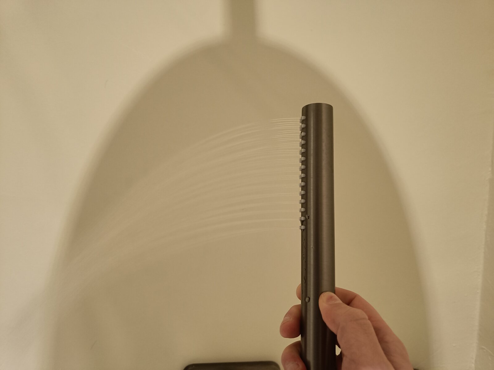

Then, the hand shower arrived. The moment we installed it, we noticed the (hot water) pressure was rather low. (It is possible it wasn't any better before, but we could never really tell with the rain showerhead.) More importantly, there was no hot water at all on either of the two showerheads.

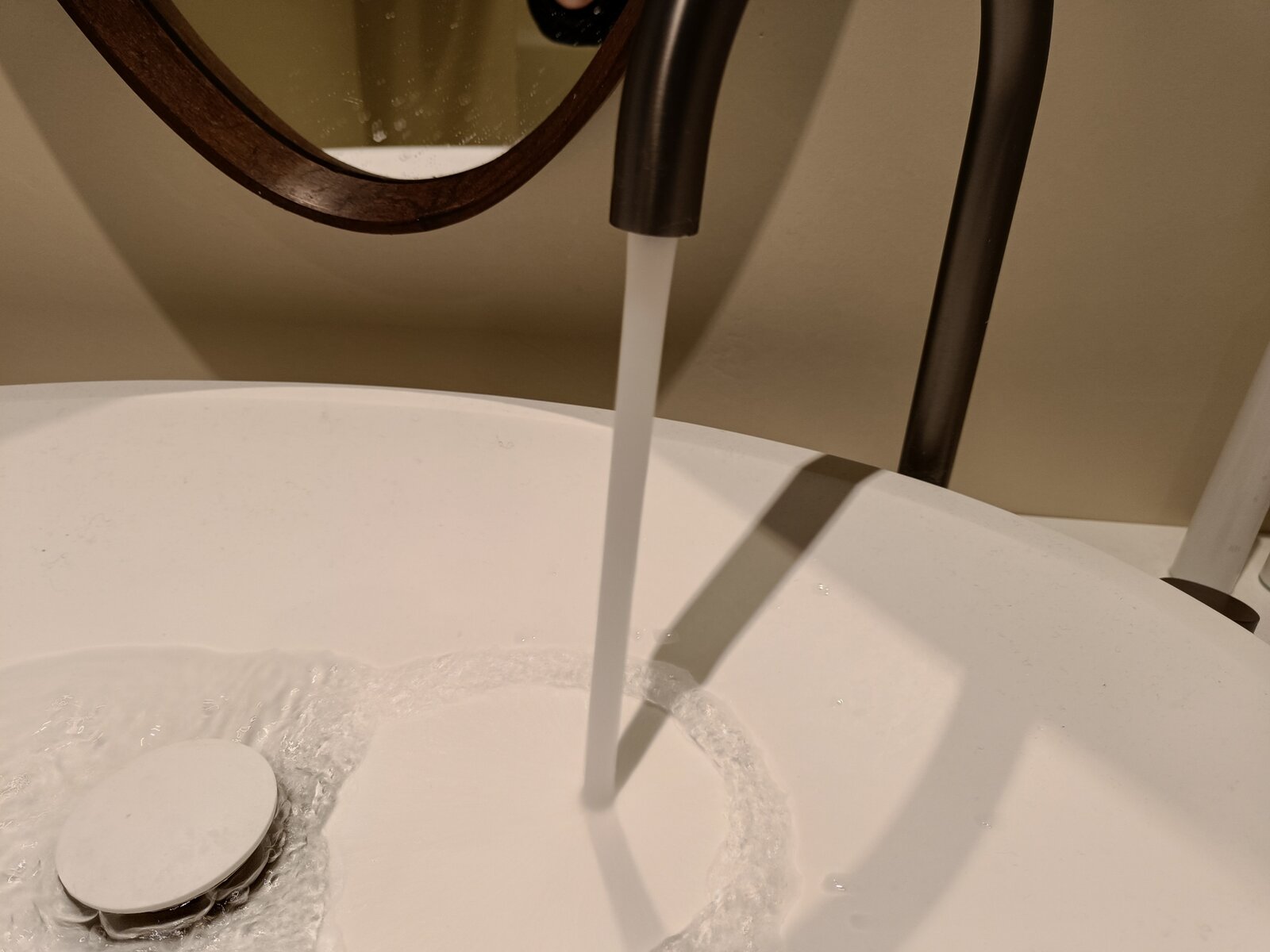

(Meanwhile, both the pressure and the temperature on the bathroom sink were great.)
