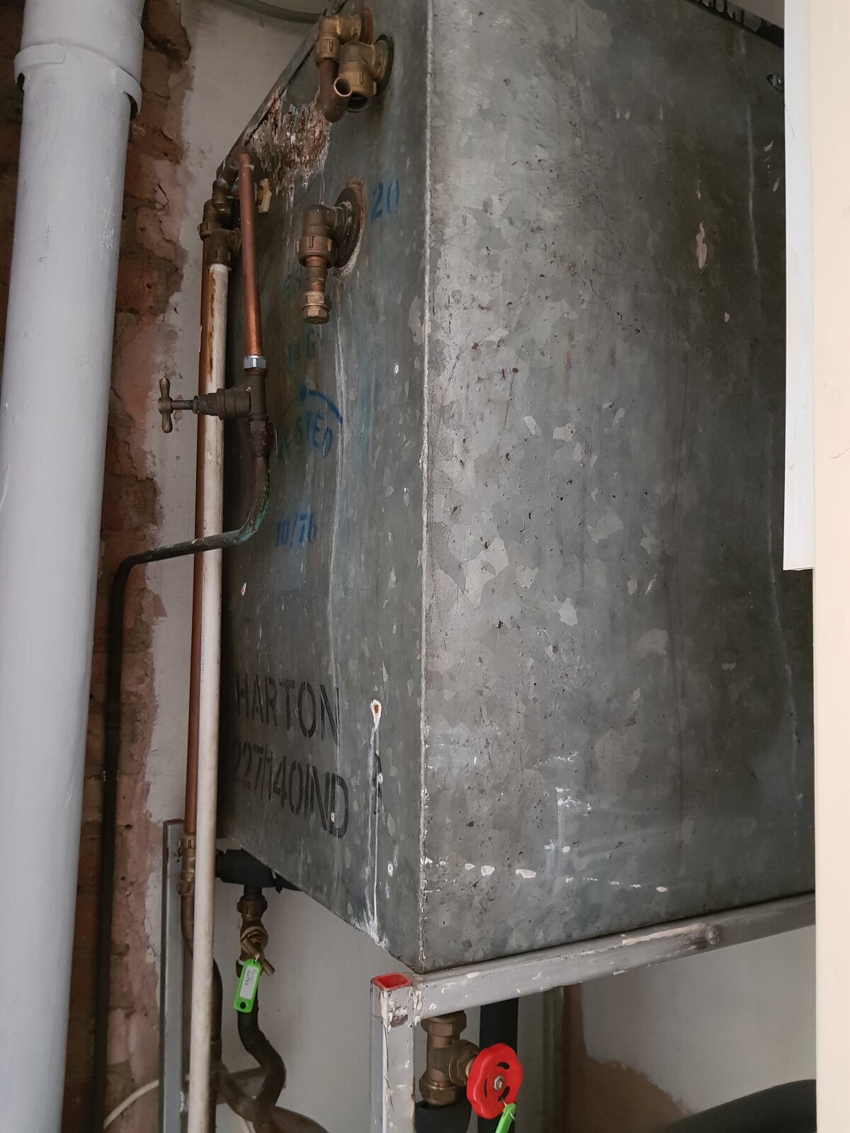

Struggling to find exact info on capacity of the cold water, an online calculator based on measurements tells me it's 250L
It has 227/140 written on the front?

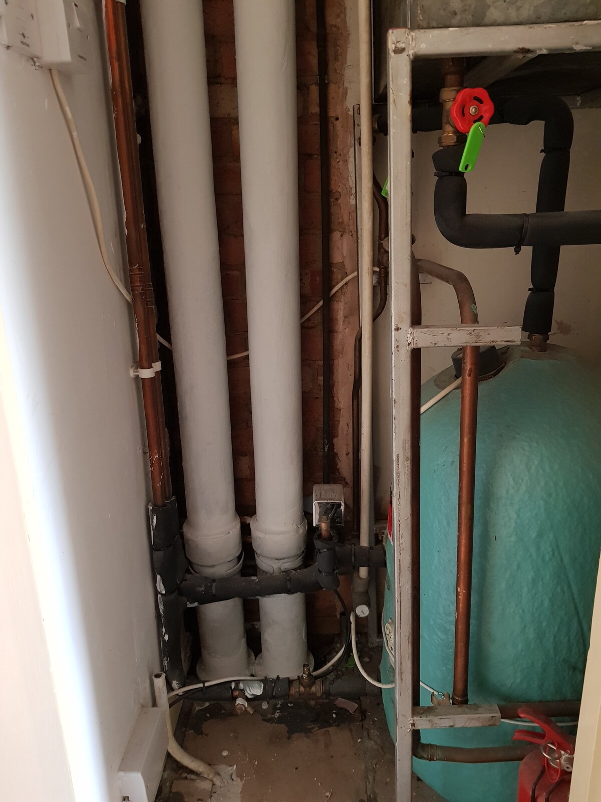

1. If the water tank in your airing cupboard is the only stored water you have, it is likely to be a small cold water storage cistern over a large hot water cylinder.
2. If the above is the case then it is unlikely that you will have sufficient stored water capacity to fit a pump.
3. Photograph of the hot and cold storage would be useful.
4. Otherwise, as Exedon.
Thanks, this is the hot and cold water tanks. The water storage isn't huge...
My husband is suggesting we go for the Stuart Turner Showermate universal twin shower pump rather than the monsoon, I'm a bit unclear about the difference other than the difference in price.
1. I doubt you have the storage for a pump. Measure the width, length and height of the cold, the diameter and height of the hot, and calculate both volumes. Assume the cold is 80% full and the hot 100%.
2. The Monsoons are better made, and you can get spares for them, which you can't for the Showermates.
Looking @ the pictures you have a galvanized cistern and that mark by the writing on the side is the metal rotting through from the inside. Like a 1960's car. You need to appraise the setup before you buy a pump.(n)
