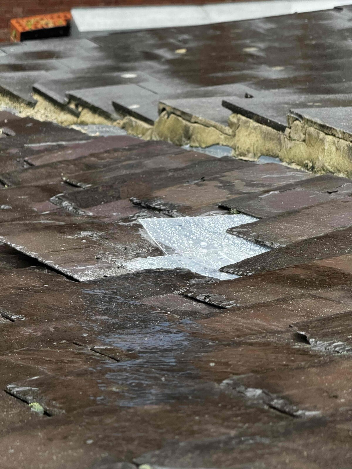

Nails /lats failing & tiles dropping, I've had to repair minor leeks in the roof/ridge every year for the past 3 and every guy that repairs it says it all needs replacing, also a badly fitted verge(?) between mine and the neighbours roof on the rear (which incidentally is a mess of concrete tile badly done by the builder who lived there, so really all needs doing).
Looking at re-using what I've already got makes good economic sense but -
I won't know what's good until it's off so won't know an amount to order new, leaving the roof exposed and roofers waiting while they arrive. How did this work for anyone who's done this? + the slates are 117 years old already, will there be many worth keeping?

I've attached a pic, taken from a velux, so you can see what I'm dealing with, it's from last week pre the latest repair.
Thanks!

They don't charge more if you put more pictures of your roof you know! From the picture I can see, they look ok.

its a Welsh slate and are reusable.
you'll need reclamation to match in , or just do front in one and another slate at the back , New Welsh is out the question, then go for a Glendyne Canadian or a good Spanish ,we had the dubious pleasure of using most available international slates I've only mention slate i would put on my own house.

Spanish look the best option, re-using what I've got on one side then new on the rear. Just need to find an good, understanding no bs roofer at a reasonable price :unsure:
Haha - I know, they're the pics I got before I came to this forum so don't have any to show for opinion gathering. I will get more then return when I'm closer to pulling the trigger on the job.
