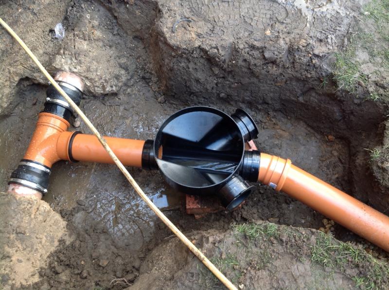

New soil pipe
What on earth is that combobulation?
You should have dug the trench aiming directly for the new junction on the existing clay pipe.
The new plastic chamber bottom should have been fitted in place of the new junction and your new pipe going into one of the new chamber inlets.
That whole 'mess' you have there is over complicated and is a liability now that you have stuck that flexi-connector in the way.
Nose is right that is a terrible set-up. You should as he mentions replace your
T-branch with that chamber and then direct your new pipe into one of the chamber inlets.
If your heart is set on not replacing your branch with the chamber an acceptable compromise would be to at least have your chamber on a straight length of pipe coming out of your branch. Then simply extend your new pipe to meet the chamber and use the appropriate 30 or 45 degree bend to make the two line up.
That way if the pipe blocks you can rod the branch from the chamber. As you have it at the minute if you had a blockage (which you would using that flexi in that shape) you could never get a rod around those bends to clear it.

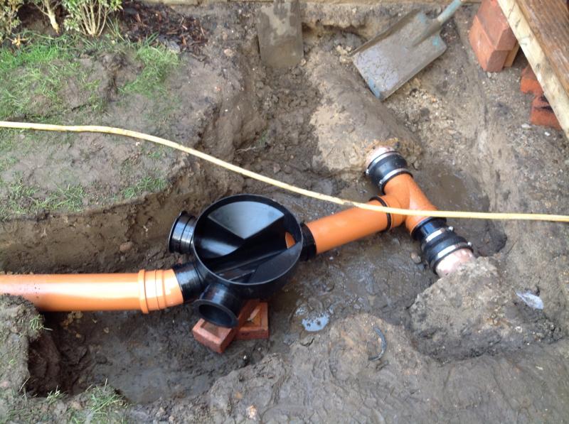

:) do you think that there is some people who put flexi pipe undeground what about this conection I Realy don't want to dig around that clay pipe also there is another acces chaimber I instaled on to View media item 53888
Much better, that will be fine. The perfect solution would be the chamber on the clay pipe run but what you have no shouldn't give any trouble. More importantly if it does you at least have a chance to get a rod round that branch.
You'd be surprised what some folk think is acceptable when it comes to drainage, believe me....
That looks quite a neat job, if you've got the falls right then you shouldn't have a problem. I'd put some concrete under and around the chamber base though once you're settled on position. Stops it moving.
I`d put that inspection . right up against the branch - then a jet could go both ways if needed - you won`t get a rod round that branch :wink:
