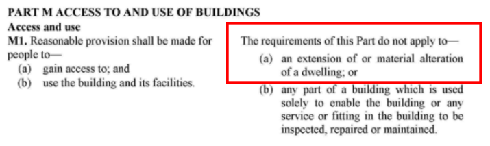

What would the height from the ground be for a new switched spur be please?
Current regulations only apply to new builds and complete refurbishments.
If you really want to do this, it's above 450mm and below 1200mm.
In fact don't even apply to complete refurbishments. Only to new dwellings which would be new build or conversions from another use.
You can't make them worse than before though, so no lowering sockets that are already low
The heights are only recommendations.
There is nothing regarding heights stopping people doing whatever they want in their own house.
I am not saying I would refuse on principle but if someone were having a house built for themselves then it is up to them.

The law says otherwise.
