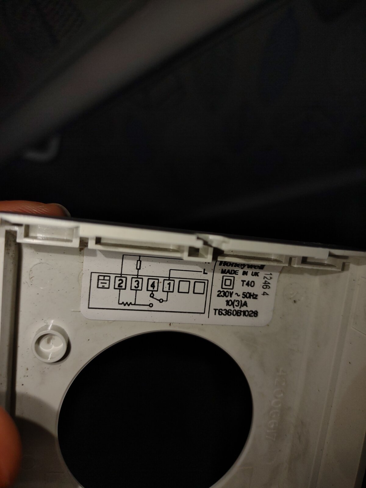

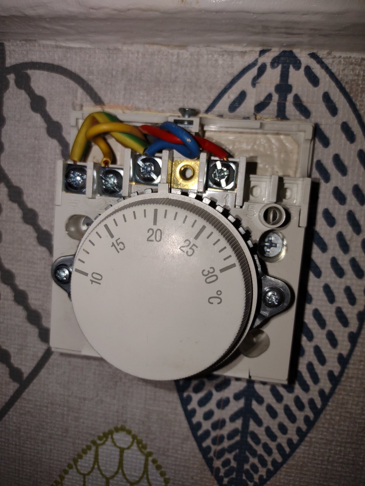

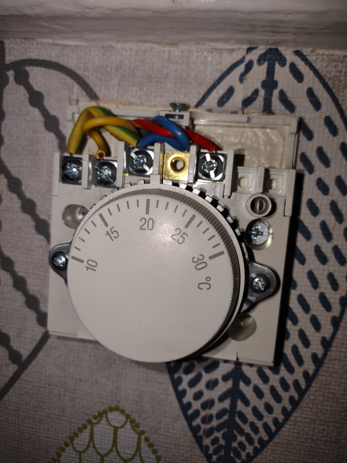

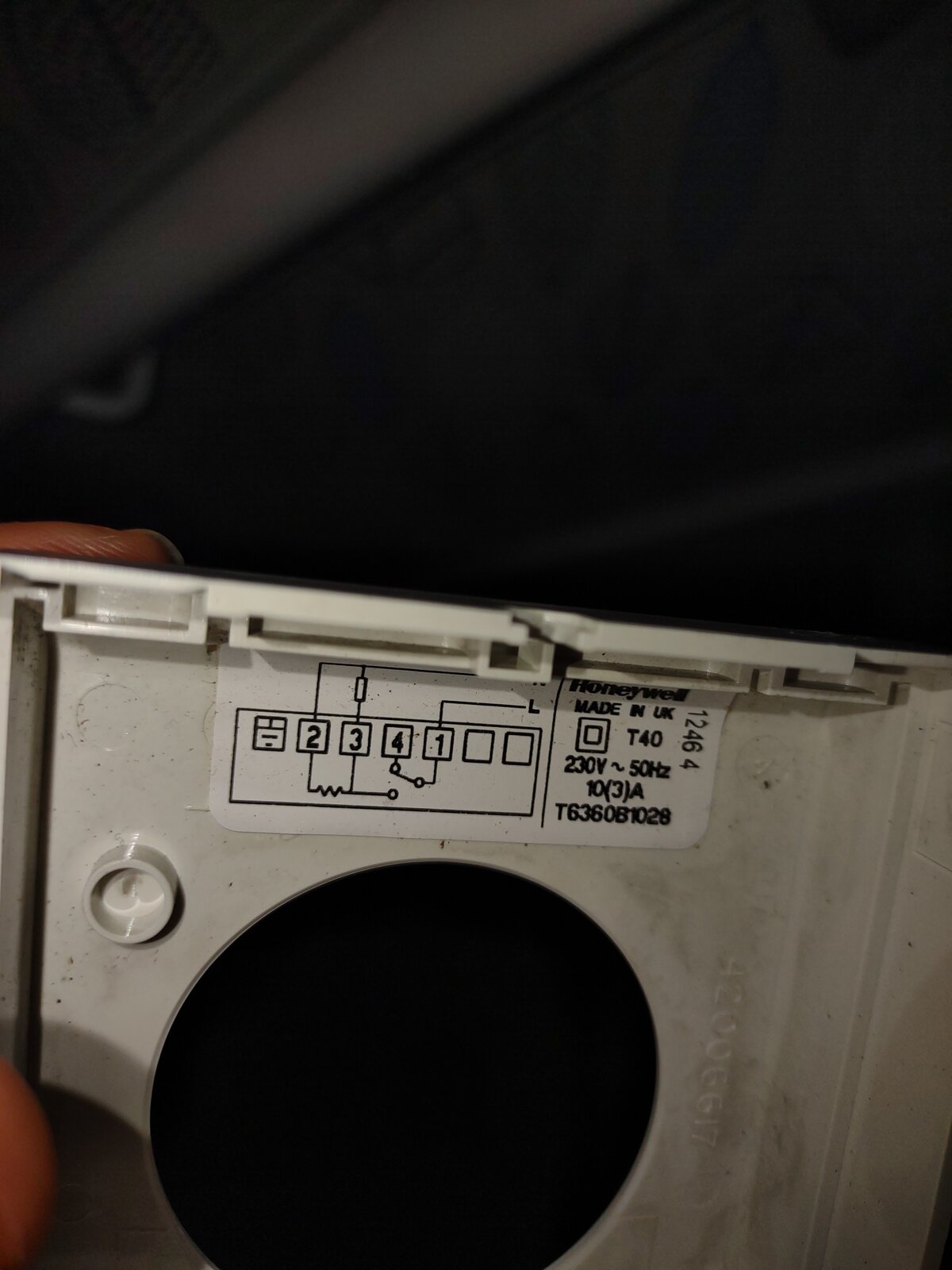

As per title, having had a new thermostat fitted, whenever the heating goes to run, pop goes the fuse.
Any ideas? Picture attached.
Apparently it's a three wire installation.. but there's four

Well,
3 is Switched Live and
2 is Neutral
So it appears that they are the wrong way round - assuming whoever did it hasn't done the same at the other end - but then it wouldn't trip.
Thanks, switching them round should sort it?

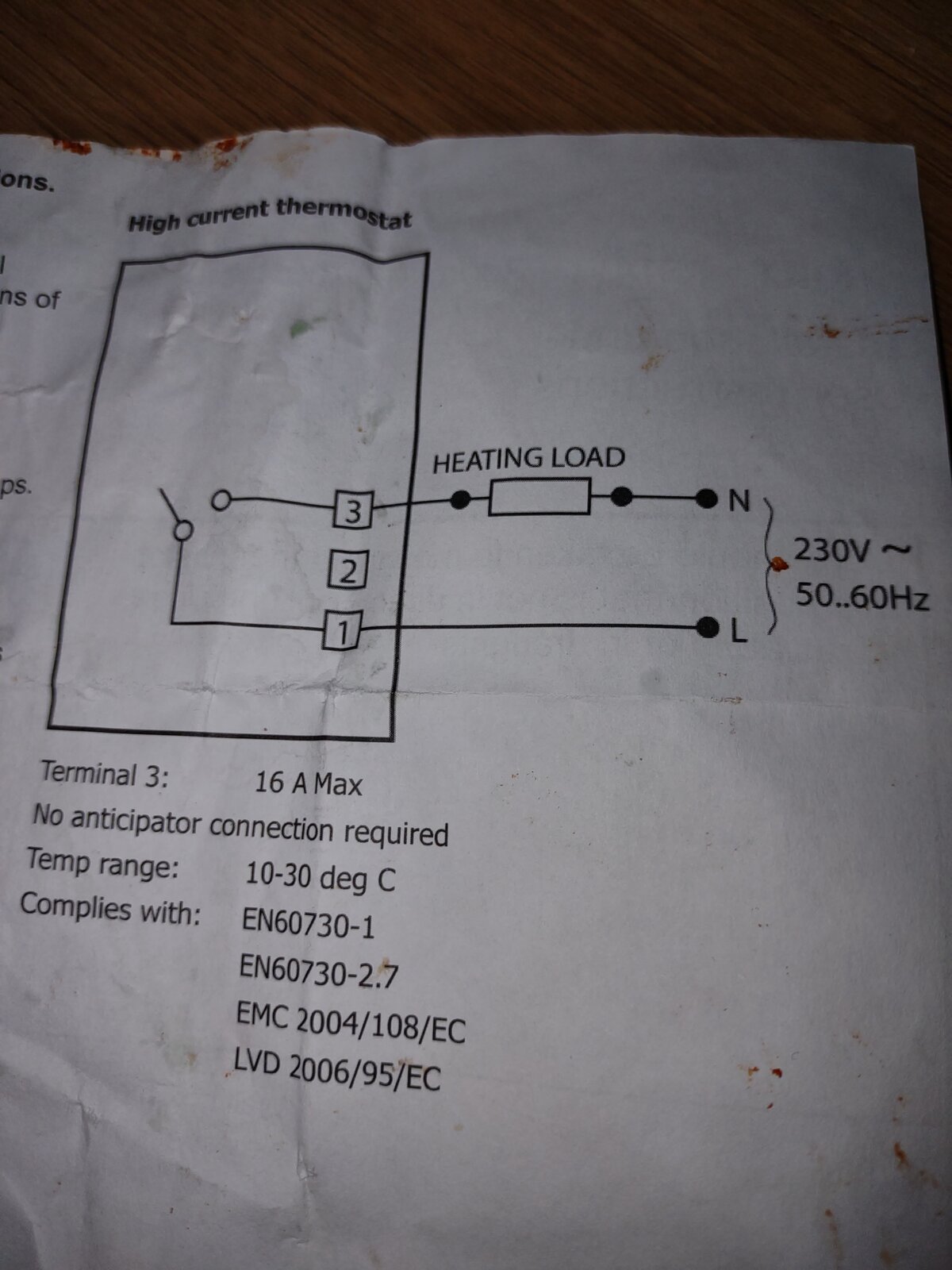

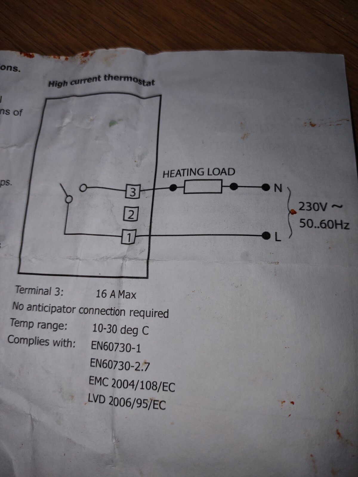

Here's the instructions btw
Well,
2 is Neutral
assuming they have used blue as Neutral?
Op - what boiler is it?
