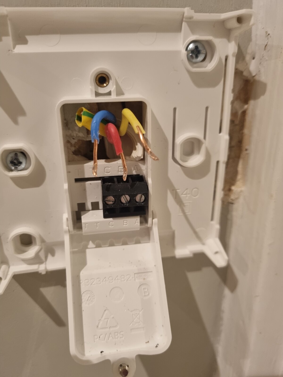

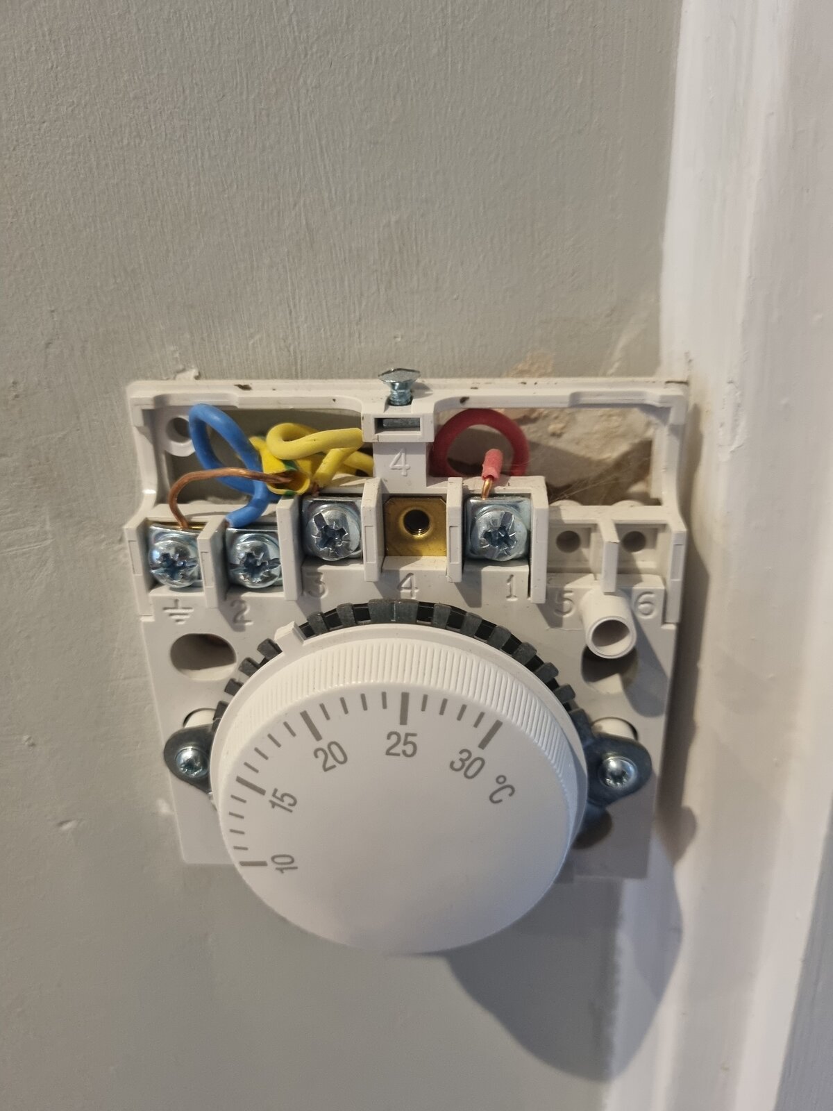

Hi, trying to replace an old thermostat and can't figure out the correct wiring. I've tried different combinations but I always seem to trigger the mains switch! I've attached a picture i took of the old one before removing it! Any help would be appreciated! Thanks

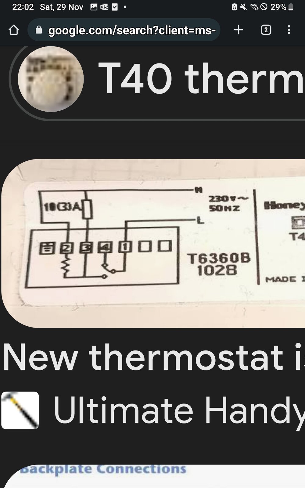

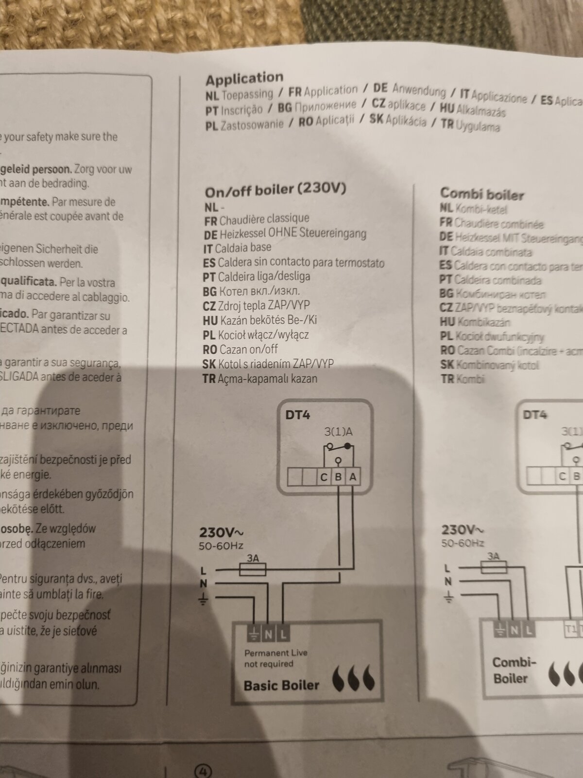

It's likely the red and yellow pair do the switching whilst the blue is a neutral , if so you need to be carefull where you connect the blue

Cheers rocky, I've tried that but still it still triggers the mains for some reason! Can't get any power on the boiler or the main thermostat next to it!

Are you connecting the blue wire?
Did initially, also tried without connecting, same result!
Ok, it’s one of a few possibilities: your new thermostat is faulty, the existing thermostat was wired up incorrectly, you have a short via touching copper wires or have created a short by introduction, for example driving a nail into the wiring on the thermostat route (I’ve encountered this once)
