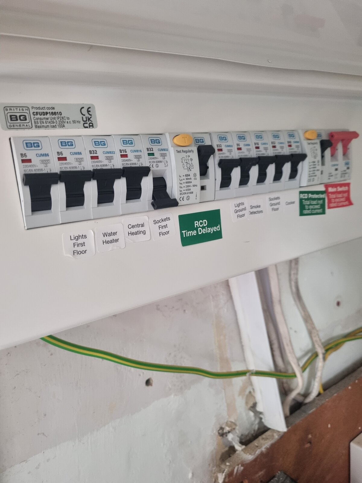

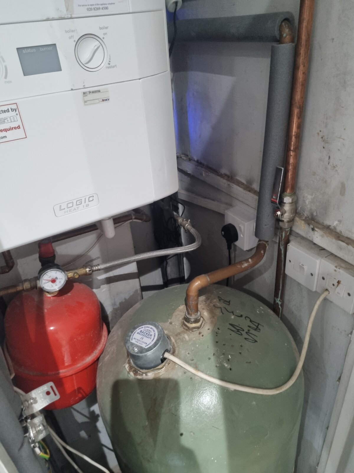

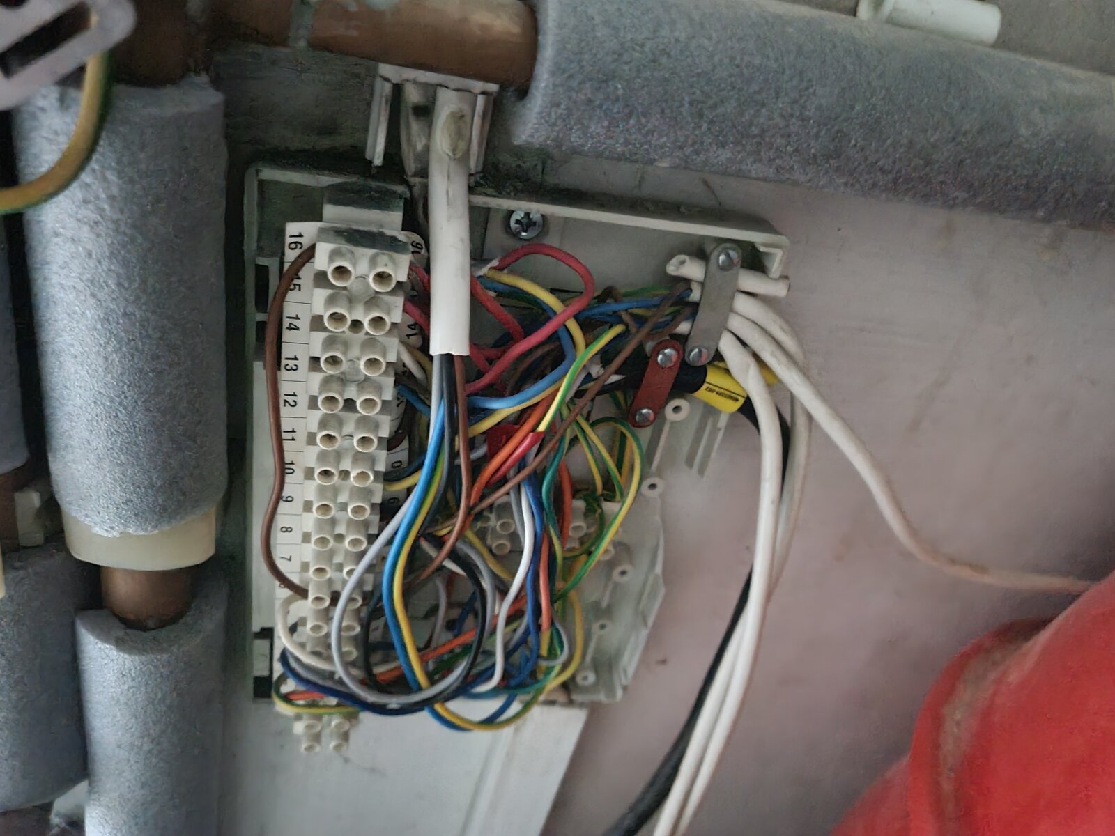

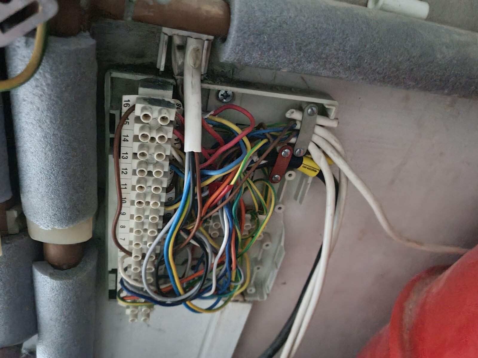

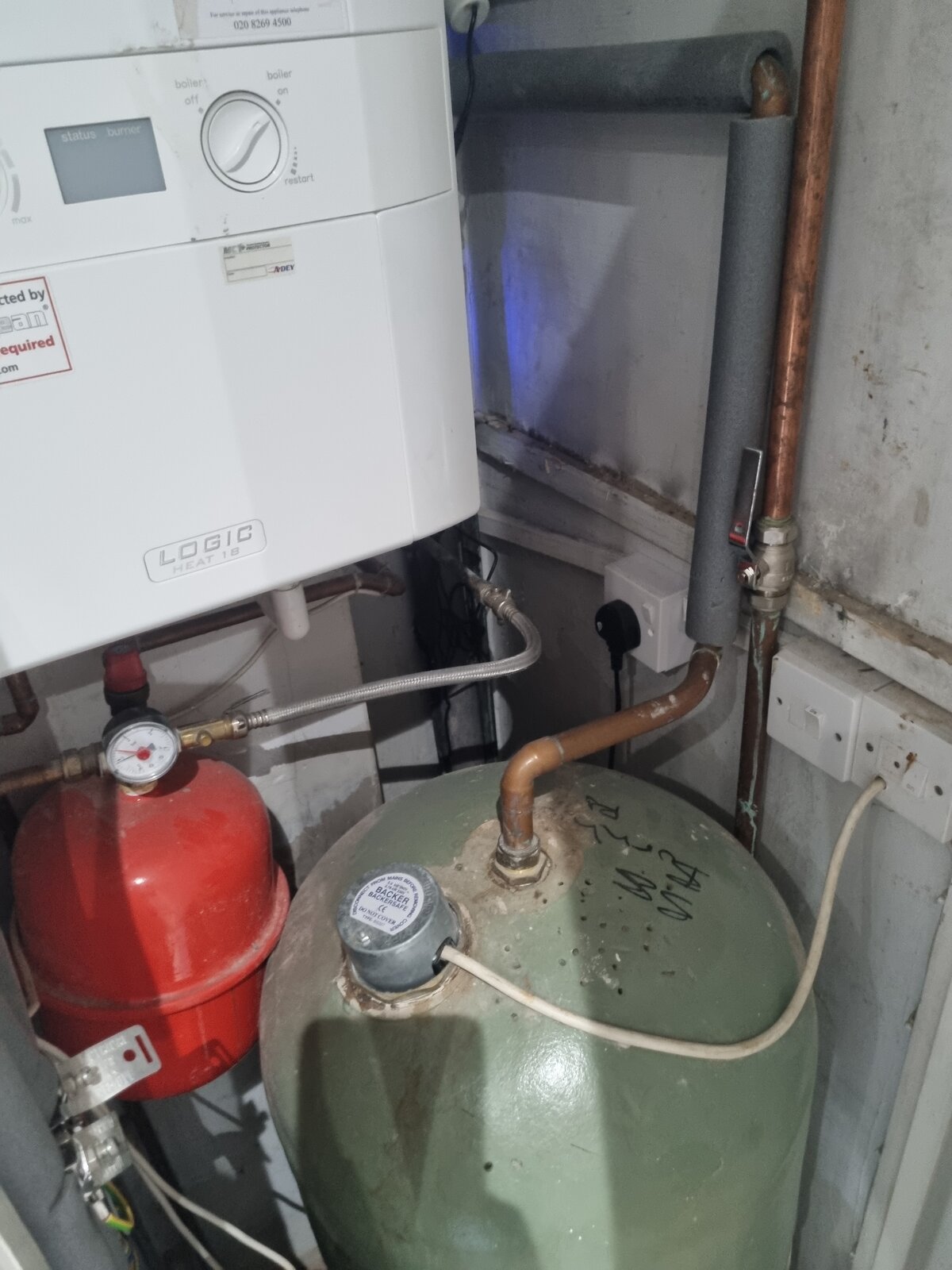

Here's what's tripping! Guessing the boiler must be somehow linked to the 1st floor sockets! Also attached a picture of the boiler cabinet and some other wiring that's in there!

Do yhe first floor sockets work?

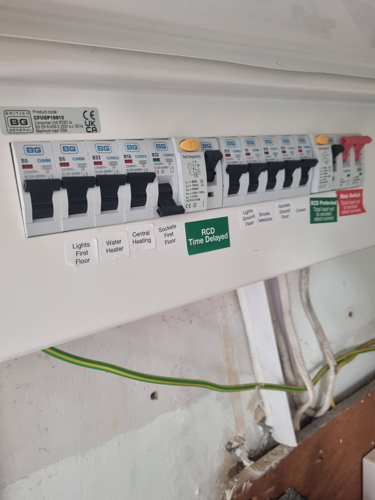

Wonder if that cu is mislabelled ! Could test some of the switches on the left to see if they do what they say. By turning them off.
Have you seen the boiler light up since you have been trying?

Where does the black cable in the single socket go to?
Nope sockets on first floor not working! I did try have a look, but can't tell if I've gone through a wire! I thought I was well awar from the cables, unless they turn in the wall! Boiler not firing up at all, no power to it whatsoever!
I've tried that, no luck, the plug in the socket is a shower pump that i had installed last year! For some reason that's the only socket working fine! Socket must be connected straight down to the mains!

Plug a table light, in the socket, and then you can identify which MCB feeds that socket.
you must have drilled though something. or made other changes while you were doing the stat ?
Maybe you have drilled thru the upstairs socket circuit, and the boiler is feed off that circuit too.

Also take a close up picture of that wiring jumble at the top. Paying close attention to where the red yellow and blue wires connect. (terminal numbers) and keep it on your phone.
Can you trace the wires at the wiring center end and disconnect them, turn the mcb back on and then see if it stays on? If it doesn’t, then perhaps a coincidence and something else is causing the trip. If it does stay on, then it’s likely something on that run.

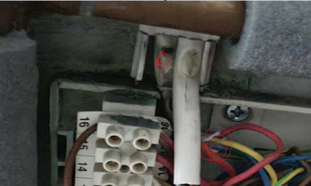

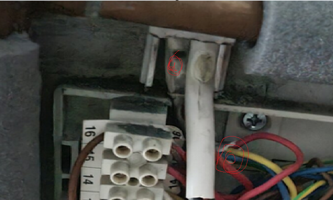

It looks as if it could be this one...
Thanks everyone for their help on this! Had to get someone in in the end! Turns out both the fuse near the boiler and the mcb had blown so had to them replaced on Monday!
