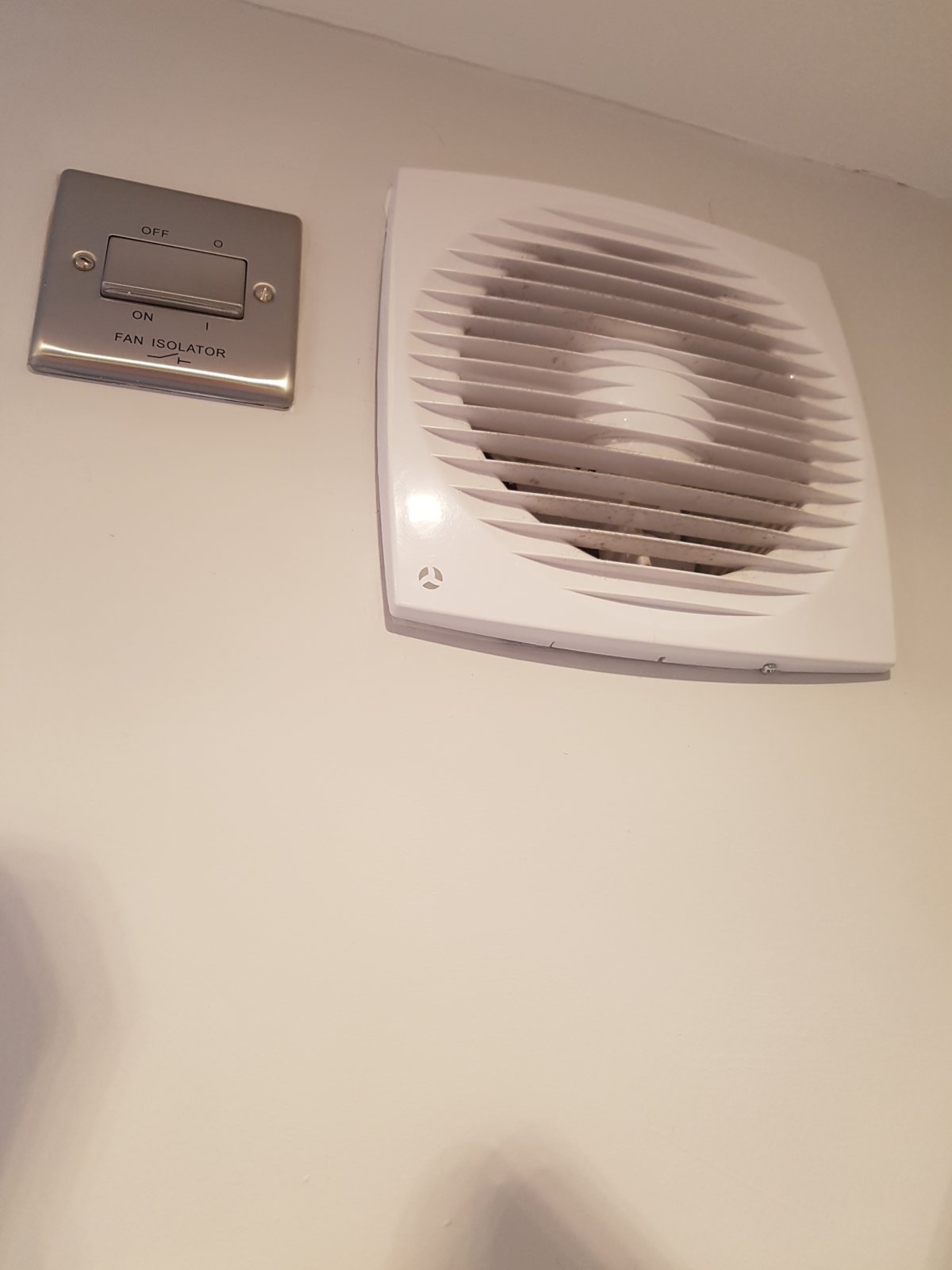

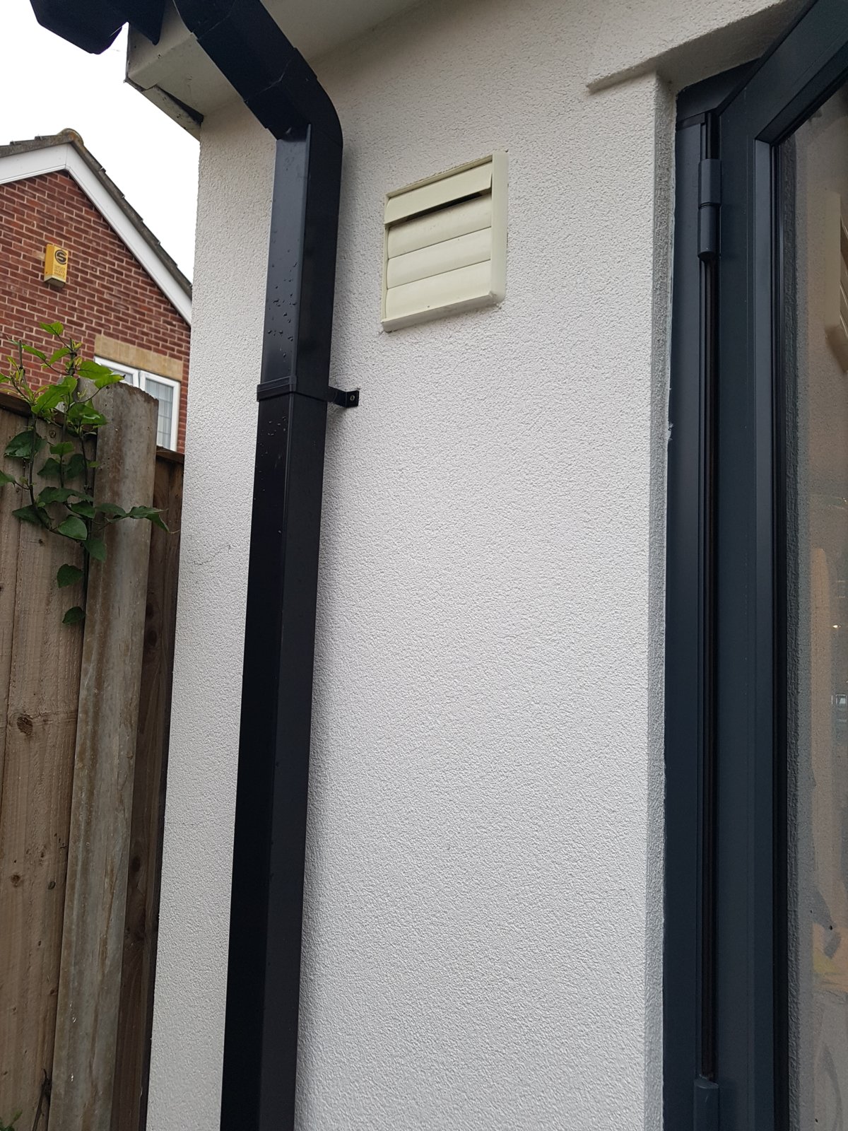

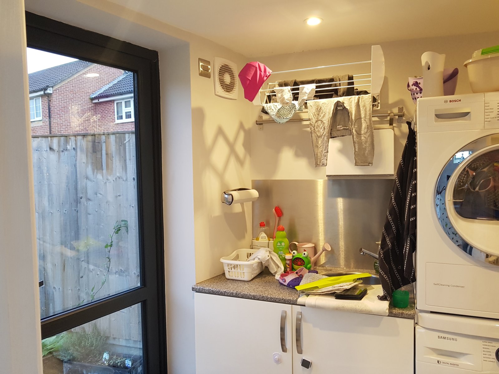

We had an extension built last year. But the utility room is freezing in winter (gets down to 10 degrees some days), despite having an adequate size radiator (room is 2 x 2.5m). This part of the extension is flat roof and adjoins the main living area and has a door onto the garage. There is a brand new glazed door to the garden but no separate window. As part of the building regs we had to have an extractor fan installed (diameter approx 15cm). I can feel cold air coming through what is effectively a hole in the wall. The garage door is a fire door.
When we mentioned to the builder he said there was nothing to do. I can't understand how a new building that had to meet building regs is so cold? What if we were going to use it as a playroom or similar - it would be uninhabitable.

an extractor fan should not let cold air blow in. If yours has no automatic shutters, get a cowl vent.

And why did you have to have an extractor; is it an extension to the kitchen. Trickle vents in the windows would have been sufficient, but the Airflow Icon fans have a shutter that only opens just after the fan starts, and then closes afterwards.

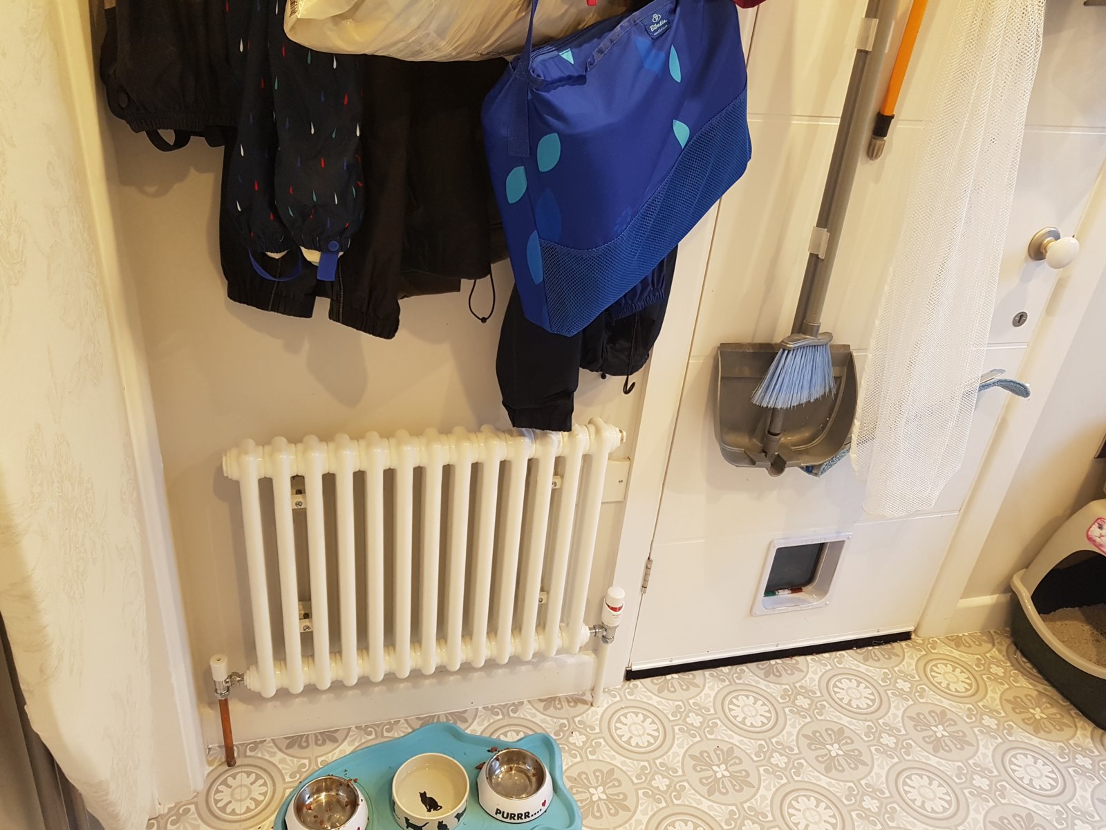

2 column radiator 500x628 1703 BTUs
The pipe work was laid as an extension from the existing radiators. We've got a new combi boiler which is sufficient for the number of radiators.

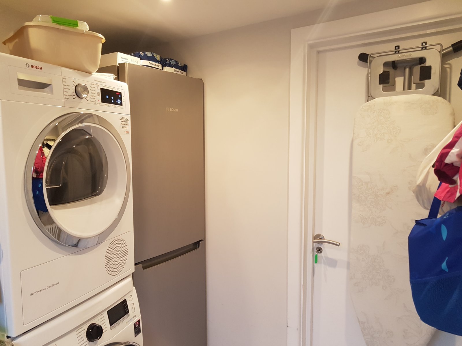

It has 2 external walls - one very small which has the external door and vent. The other is the length of the room. Then the back wall has the door to the garage. The other side wall adjoins our living room and has the door into the room.

The separating wall from garage to utility roo. Is breeze block and plaster board.

There's no window and as it is a utility room with sink a fan had to be Installed. It does have some flaps externally but these seem to just flap about. And there is draft coming through all the time. I was surprised at the size of the hole before the fan was installed.

So what was fitted above the block and beam floor. Fine for the fan as it's a utility room, but take a look at the Airflow fans to cut out the drafts; not cheap, but will solve one problem, but try blocking the fan up first and see if things improve.
You've got two column radiators, but they could be warming the ceiling rather than the room, and were they calculated for the size of the room, or they just fitted in best. If they didn't insulate the garage wall, then you'll get a substantial heat loss through there.

That's a big part of your problem. That wall should be insulated to the same standard as an external wall. It should have 120mm of foil backed insulation board or equivalent on that wall.

Fit a shutter to that fan.

There's only one radiator but we calculated the BTUs and this one was sufficient

The job looks good, but the radiator looks undersized. If the floors cold, then there won;t have been any insulation underneath it, but vinyl should be warmish. I know you feel the builders are reputable, but somethings going wrong, and they appear to have shrugged off the fact that the rooms cold, and that's a little odd. A 100mm fan should have been sufficient, and it could be that the wind direction is straight on the that wall, so you'd always get a draught through, and fitting a cowl wouldn't achieve much either. If you feel the walls, are all of the even, or is the garage wall colder.

We sealed up the vent and it's made a big difference. I still think there are other issues that need to be addressed and we've asked the builder to confirm what was done regarding insulation on all walls, ceiling and floor. But we're going to invest in an airflow vent at least for now. Thanks

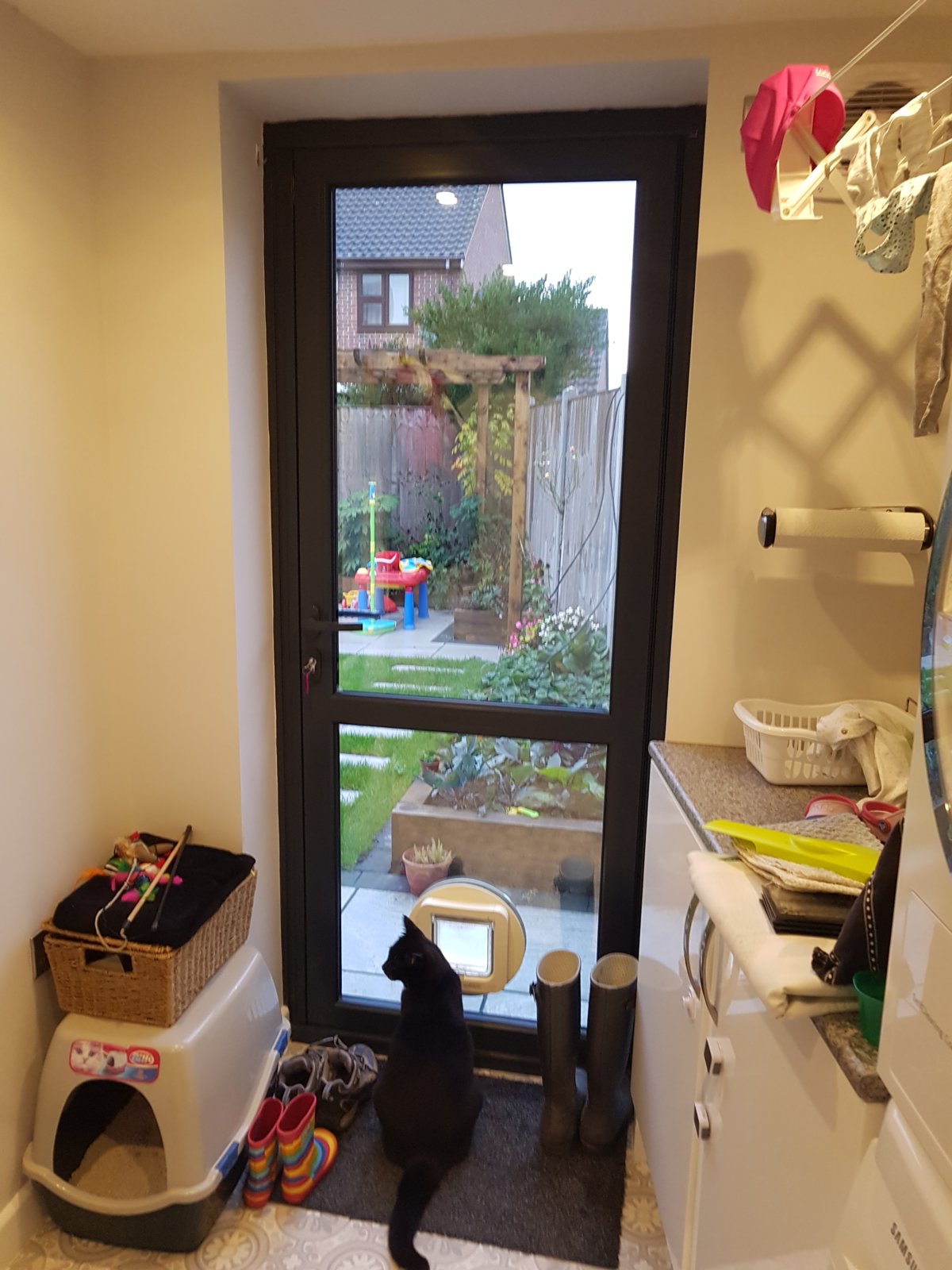

Are you getting cold in from the cat flap(s)?
We get breeze in around ours, and I also find the bloomin' cats manage to leave it swinging in the wind on occasion.
I did notice a small draft but it's good a shutting itself! As the flap gets older it definitely gets more air coming in
