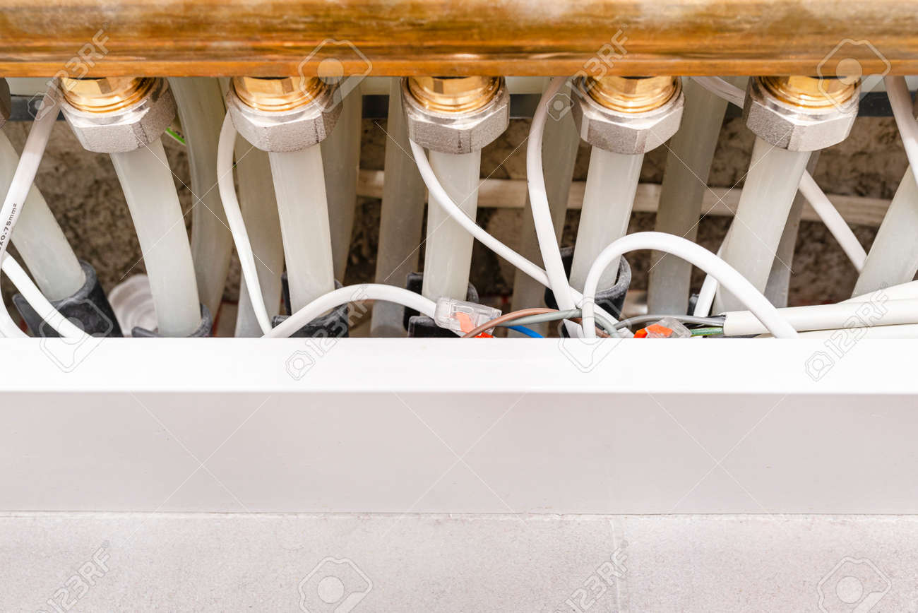

Meanwhile, in the real World, installations like this have been just fine for many years...
