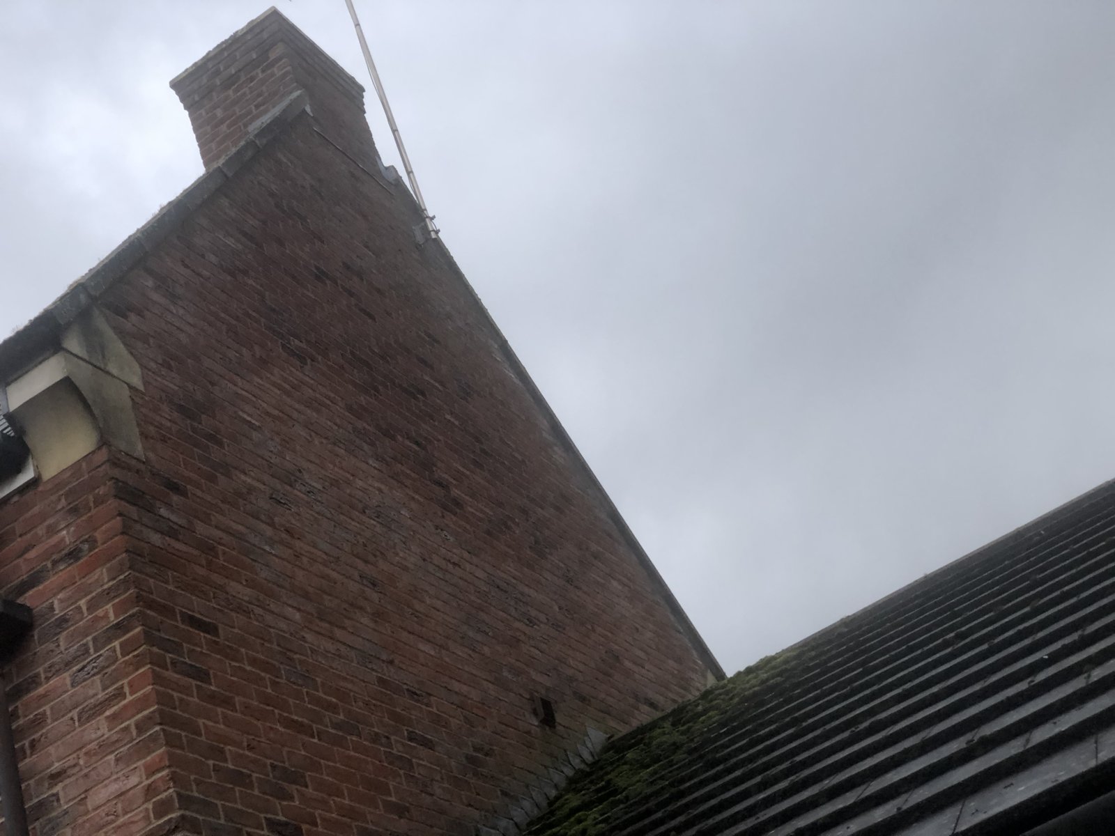

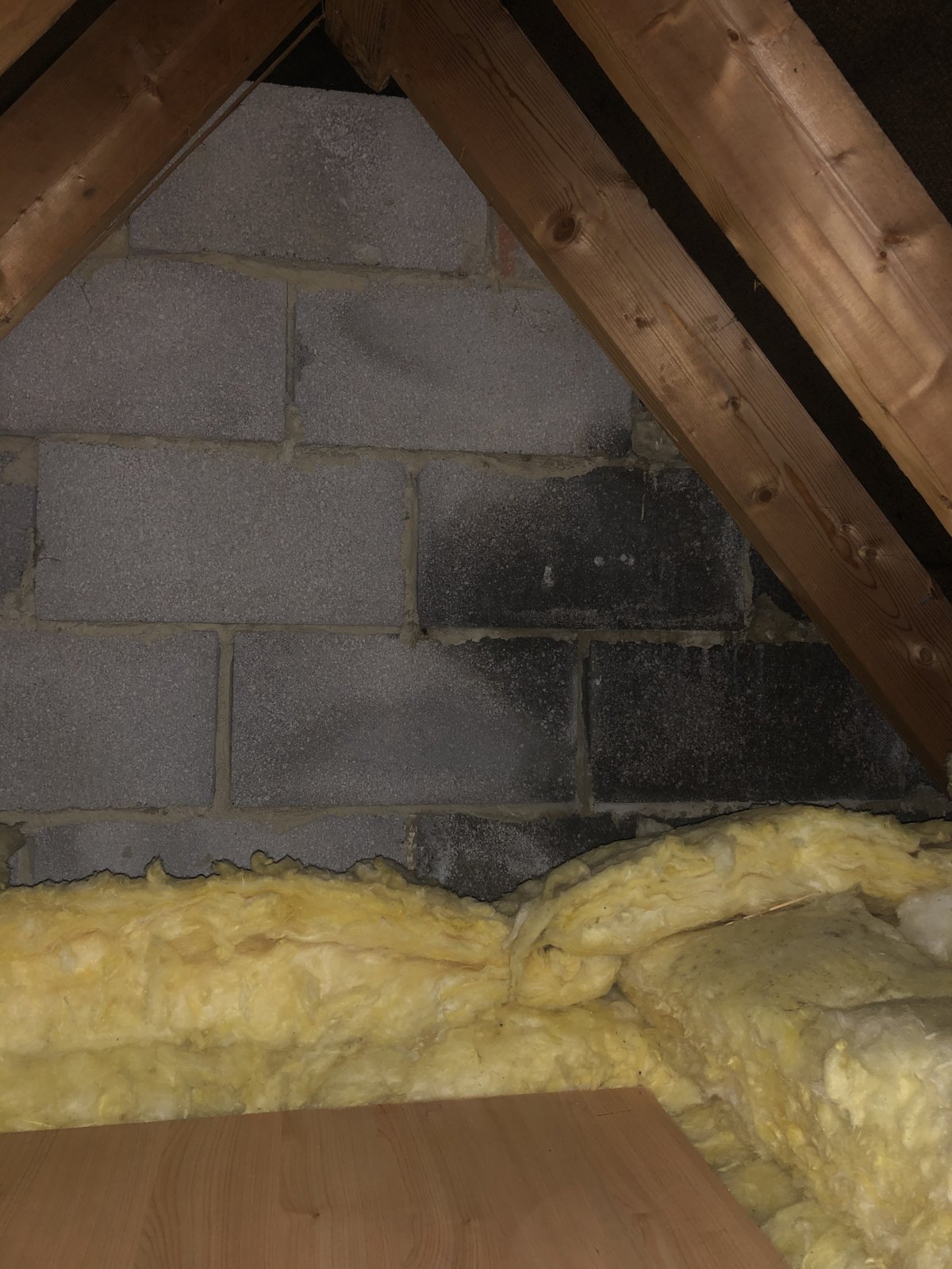

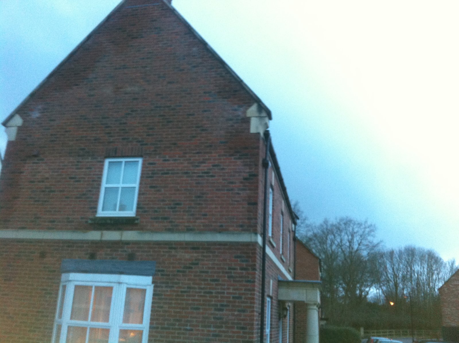

Both my gables ends are wet. Built 2005. Developers came out in 2007 and replaced lead flashing under coping stones. It was under lapping!!
Same issue in 2014. Nhbc came and placed small pieces of flashing around false chimneys. 2020 still wet. Out of nhbc. Only happens in strong wind and rain from certain direction I think. Now they don’t want to know. I’m arguing the house still isn’t finished from build or built to specific standard.
Any advice appreciated

Looks like there isn't much overhang on the tiles. Wonder if the water is just working it way off the end of the tiles and tracking back under then onto the walls.
It seems to have coping stones rather than tiles?
These are tricky to get right as water can get down between the joints; or the overhang and grooves may be inadequate or non-existent; or the flashing on the inner skin may be defective (the interior pic suggests that).
If the bricks are permanently damp, that will not do them any good long-term.
Tony the internal wall stops in roofspace,it must be boxed in above roofline.
Also in other thread you can see the lead is fully under copings.
Unfortunately NHBC warranty only lasts for 10 years and that is for structural issues. Dummy chimney stacks can allow water to strike straight down if they don't have a continuous dpc across the whole of the stack. My own house had water dripping on to bedroom ceilings from 2 dummy chimney stacks until they were rebuilt incorporating this full dpc. I knew the problem because I worked on an estate where we had problems with water penetration from dummy chimney stacks except where they had cast stone cappings. We made sure they were rectified with dpc's as mentioned. Your situation could also be incorrect detailing of flashings, cavity trays and dpc's to the parapet walls.
There is something wrong with the construction going back to the warranty period I would say but not sure on the legal situation for having it rectified now.
