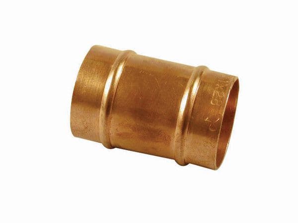

A better bodge/easyfix, in that nobody would find it, would be to cut the pipe and use two soldered slip-couplings; one to go over where the damage is and one to rejoin the pipe.
