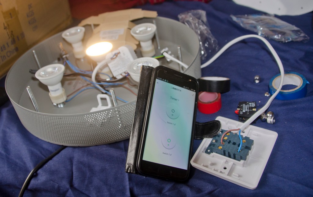

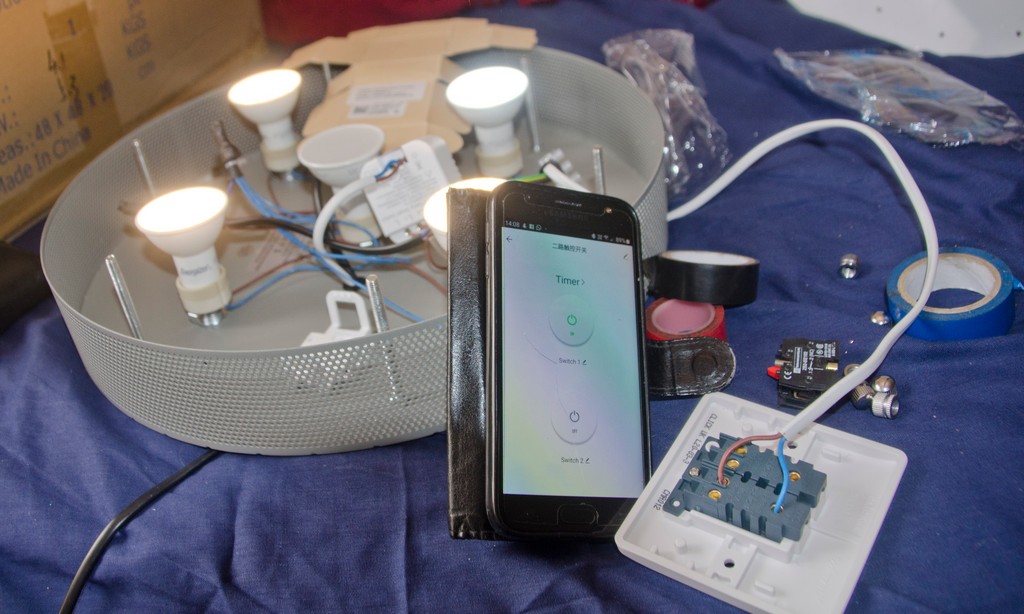

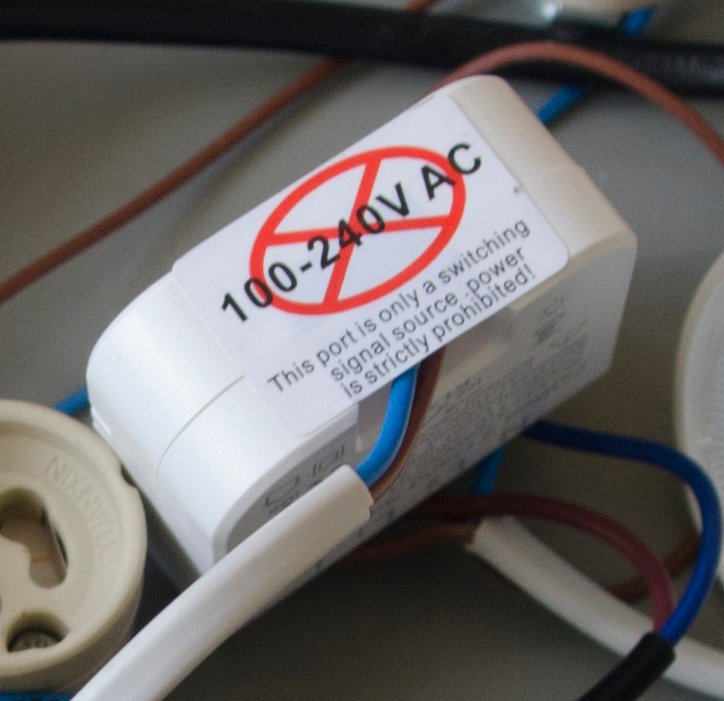

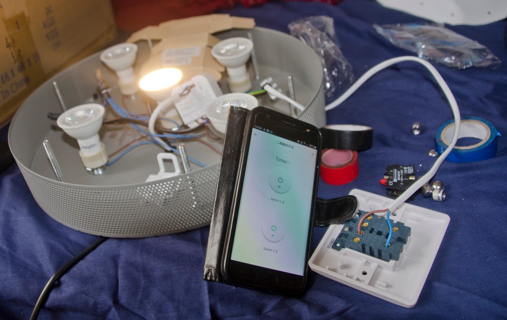

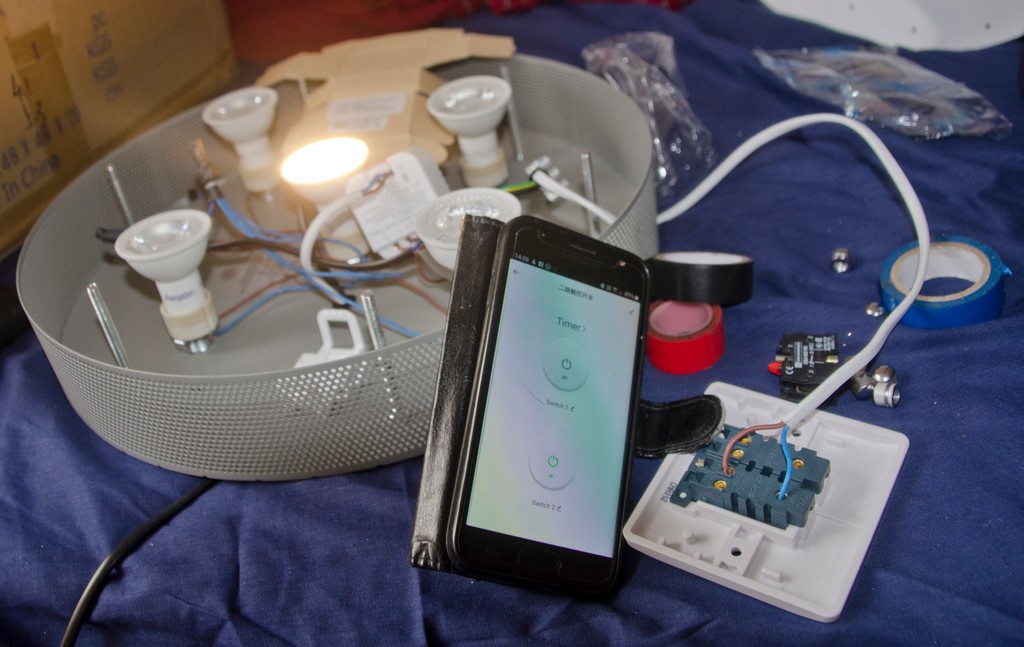

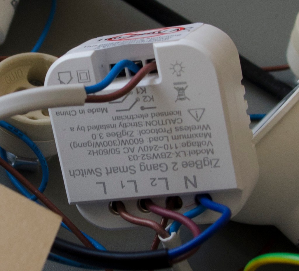

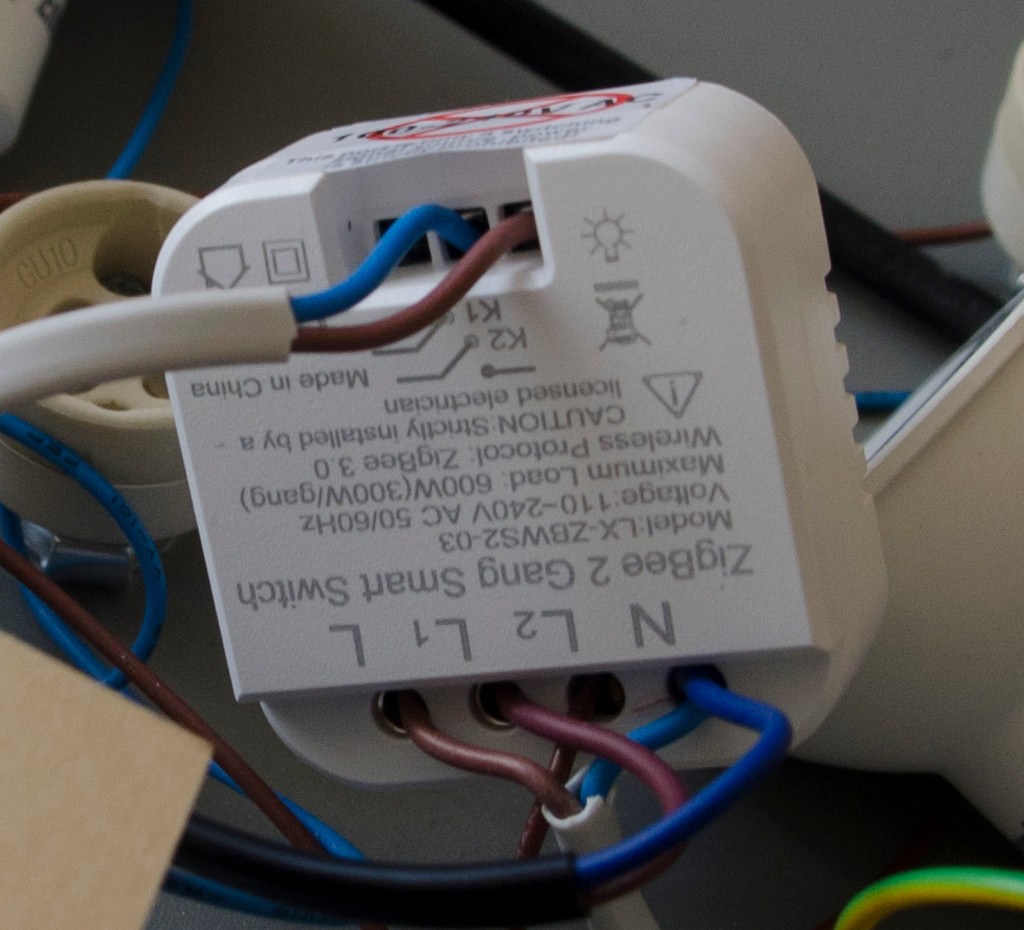

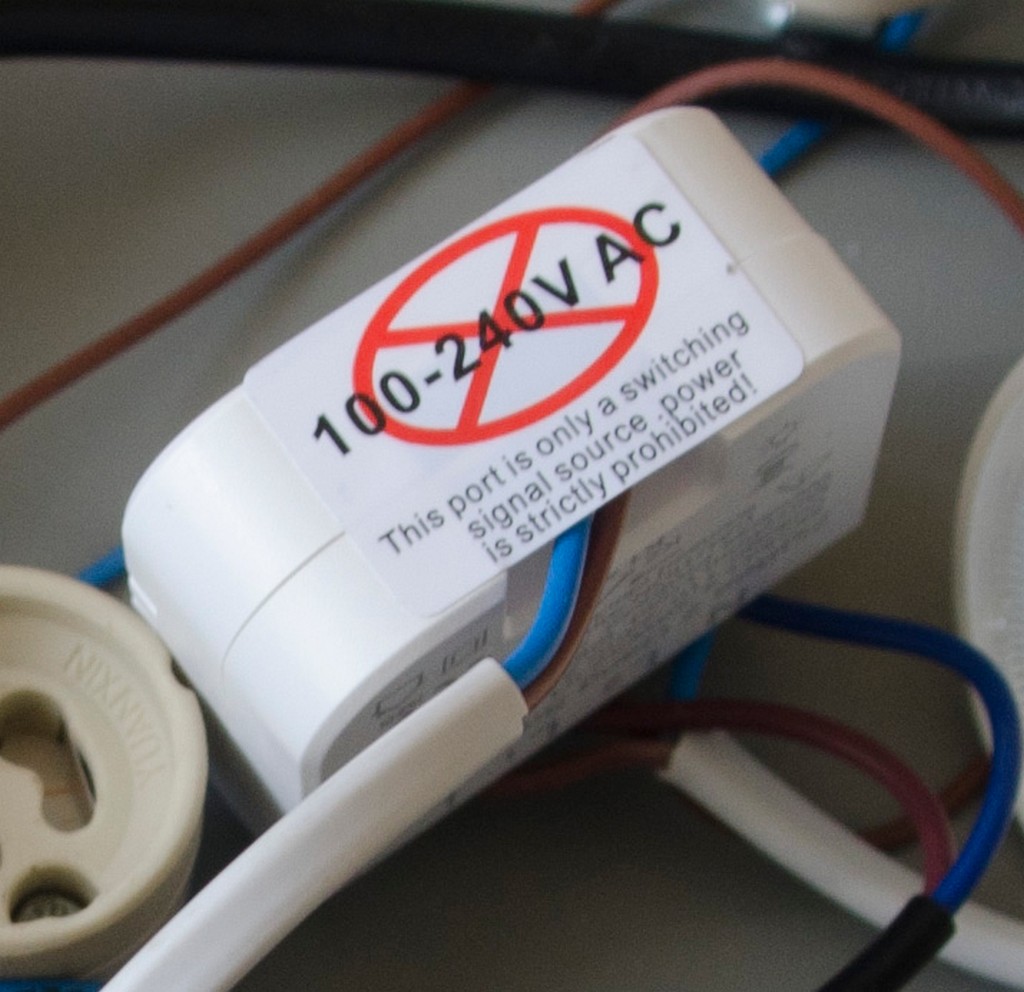

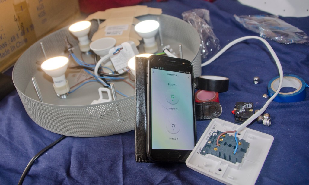

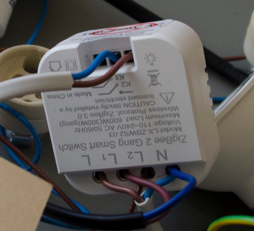

This DSC_6058.jpg DSC_6059.jpg is the lamp waiting to go up, wife likes the dangle bits that attach, but I have split the lights one inner and four outer and intend to use colour changing inner lamp. To do this I am using a smart relay, DSC_6061.jpg DSC_6062.jpg this means the light switch and phone work like a two way switch, so can turn off with switch and back on with phone, and also set times for auto switch on/off, not decided yet if going to replace the single gang switch with double, or only have wall switch work outer lights.
It seems our smart bulbs have a default setting, they remember if set to colour changing when switched on/off with light switch, but not dimming setting, or off setting, so switch off at wall then on switching on again full output on even if was switched off on app.
Smart light switches seem to default off, and smart bulbs default on. So a power cut for few seconds all smart bulbs switch on and all smart switches turn off.

This View attachment 248606 View attachment 248607 is the lamp waiting to go up, wife likes the dangle bits that attach, but I have split the lights one inner and four outer and intend to use colour changing inner lamp. To do this I am using a smart relay, View attachment 248608 View attachment 248609 this means the light switch and phone work like a two way switch, so can turn off with switch and back on with phone, and also set times for auto switch on/off, not decided yet if going to replace the single gang switch with double, or only have wall switch work outer lights.
As to if all makes are the same I don't know?
would this mean that I could have a regular switch on the wall and the relay manages everything from the loft?
Also, does the app work from outside the home and does this require any extra kit?
The relay is actually in the lamp, but near enough the loft, and would be easy to fit a box in loft to hold it. There is a regular switch on the wall, but it switches extra low voltage not the normal low voltage, in my case I need a zigbee hub to connect it to the internet, and I can control the light as long as I have mobile phone coverage.
With me it started with Lidi, they were selling off some zigbee lamps cheap, what I had not realised was they needed a hub, but it was not that expensive so got one. I think to date just seven devices, one which is a really handy remote control, I use an app called "Smartlife" and it works some items direct and some through zigbee hub and I can't remember which are which.
I tired to use Smartlife on the PC and it is a pain, it needs Bluestacks emulator running and takes an age to boot, Smartlife is not fast booting up either, which is why I like being able to use wall switches and remote controls as well.
