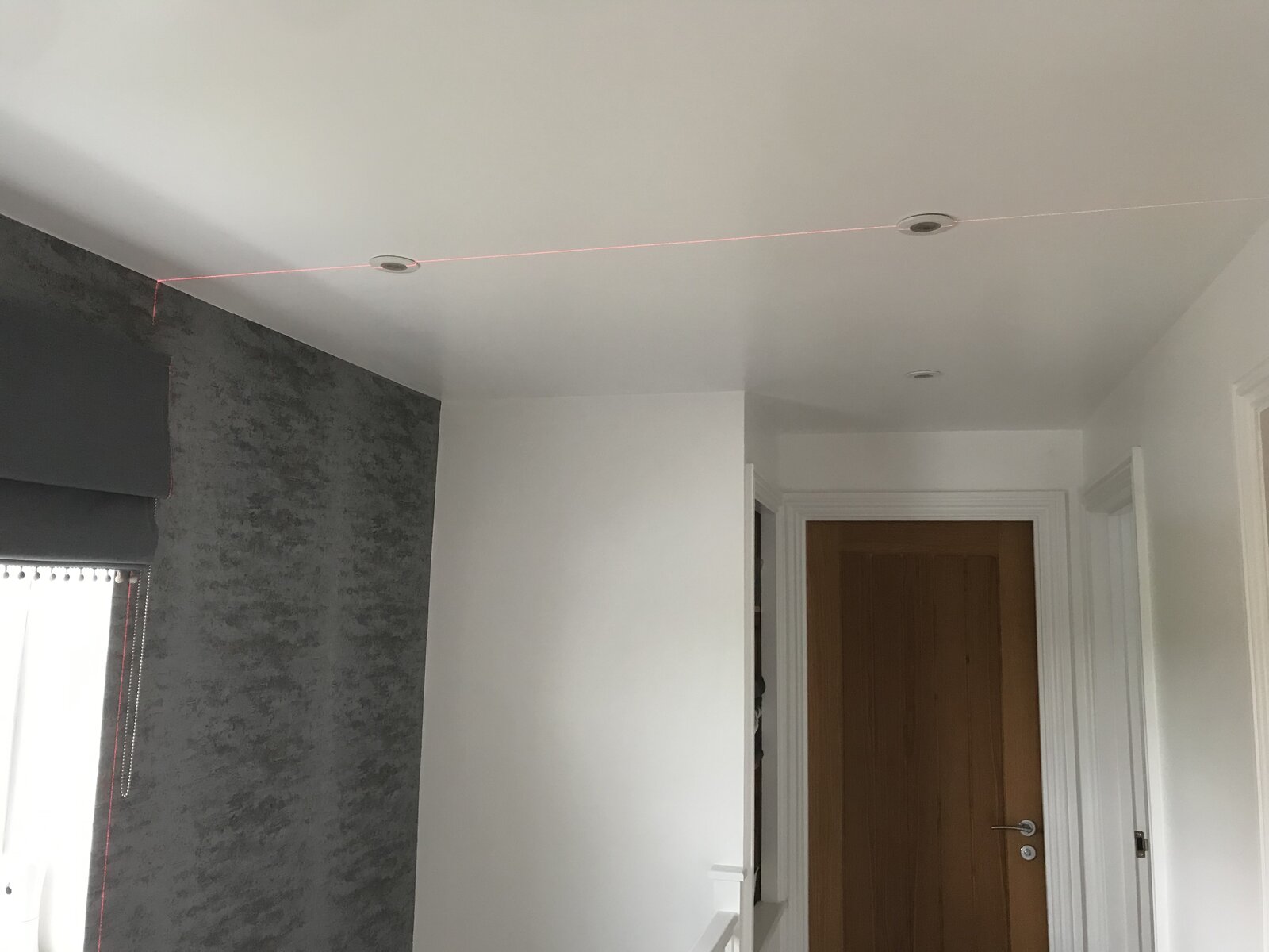

Would a 1mm 3 core flex with a 5amp fused plug suffice? I don’t have a 3amp in the shed.

I was hoping there is something printed on the cable but all I can find is this.
I was basing it on lighting cable which is 1.5mm/1mm T&E and protected by a 6amp breaker. I’ve only got one light on this cable.
Thanks for bearing with me
Well, 1.5mm² twin and earth is rated at 18amps (depending on the installation method).
For domestic lighting, 1mm² cable (rated at up to 10amp) is more than adequate especially with a 6amp CPD.
If you don’t have a cable catalogue, browse through the information on any supplier’s website. Here’s the link for 1mm² flex on the TLC site. Hit the “description” button and you will find a wealth of information.

Excuse the ignorance but if this cable is rated at 10amps, I would interpret that my plug fuse can be up to 10amp. However, presumably the light fitting also has a bearing on this? Let's say this for instance:
Fire Rated 240v GU10 Shower Downlight - White - IP65 | Aurora (EN-FD103W) (tlc-direct.co.uk)
I can't see where it states the amp rating. If this did have one and it was lower than 10, I would be inclined to fuse at the lower level.
I would appreciate your advice on this.

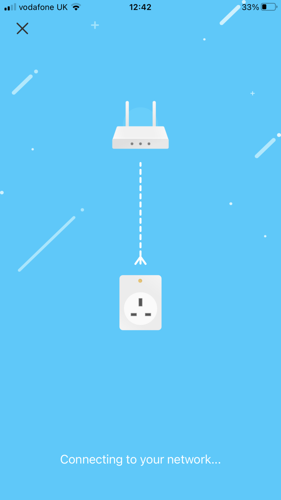

A thought: I have a socket in my loft. Could I have a ceiling light (low wattage) and then plug this into a socket with a 3amp plug?
The socket could have one of these smart plugs that I can then schedule and operate via the mobile.
I can then set a schedule for this to remain on through the evening and overnight hours.

Yes you can fuse it at 10a if you want to, the fuse is to protect the cable not the fitting. In Europe it would only be protected by a 16amp MCB and they don’t seem to have problems.

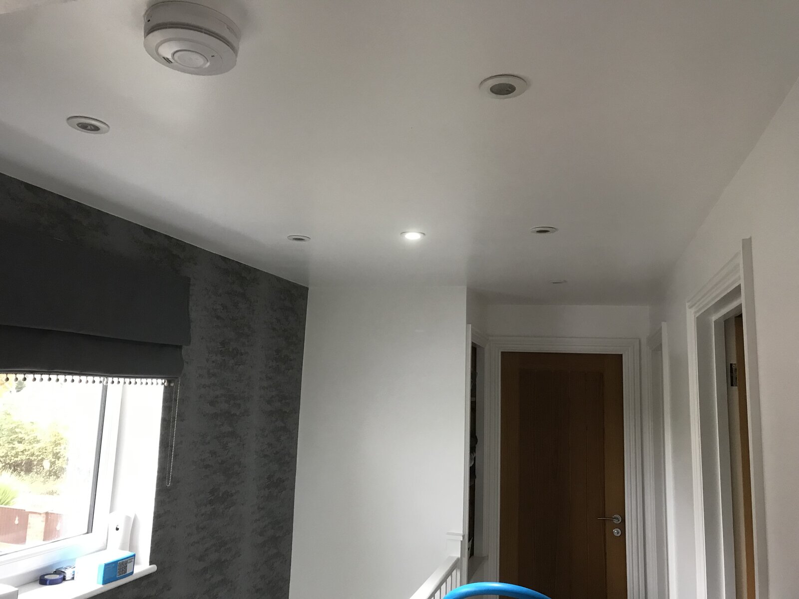

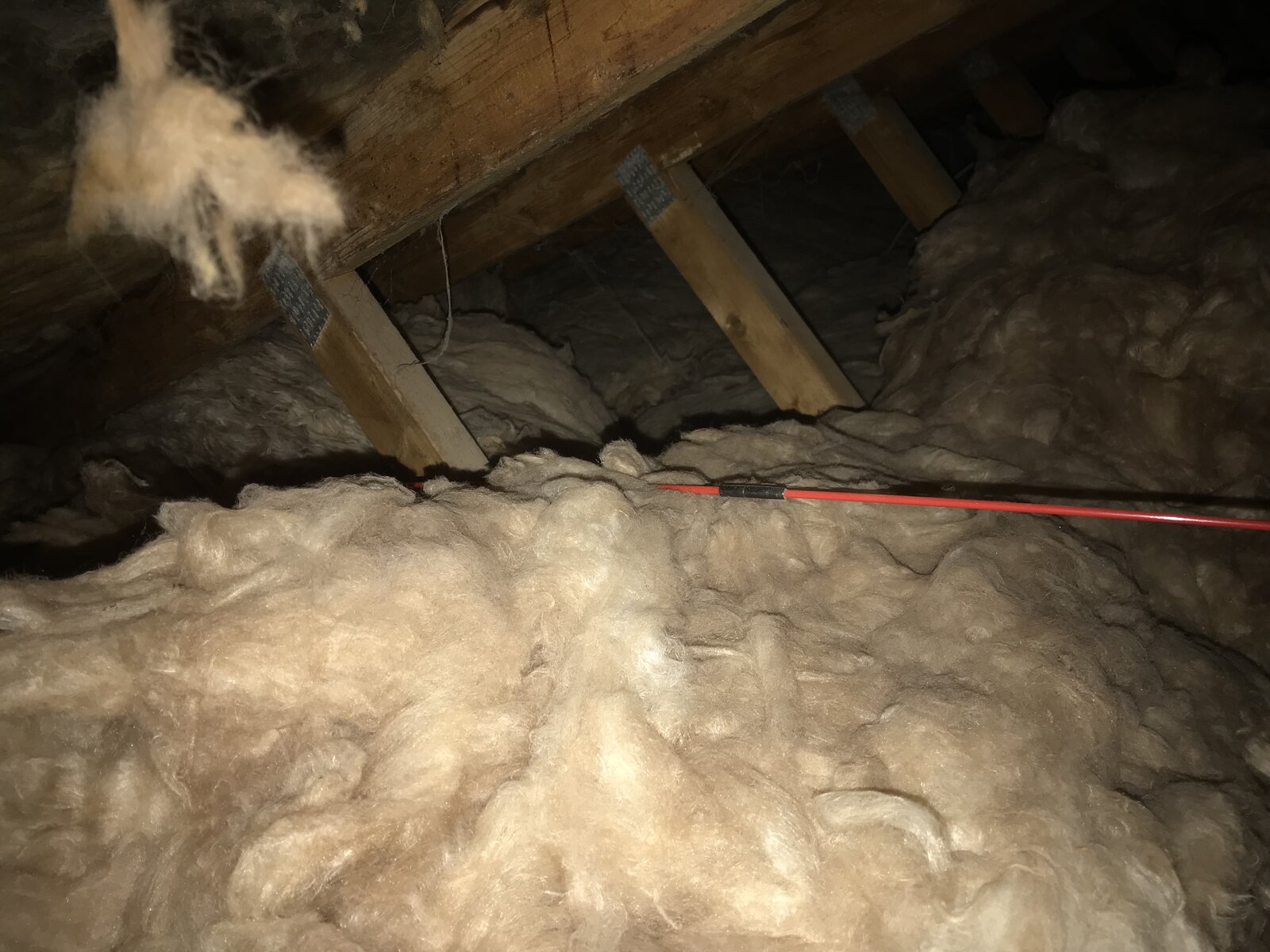

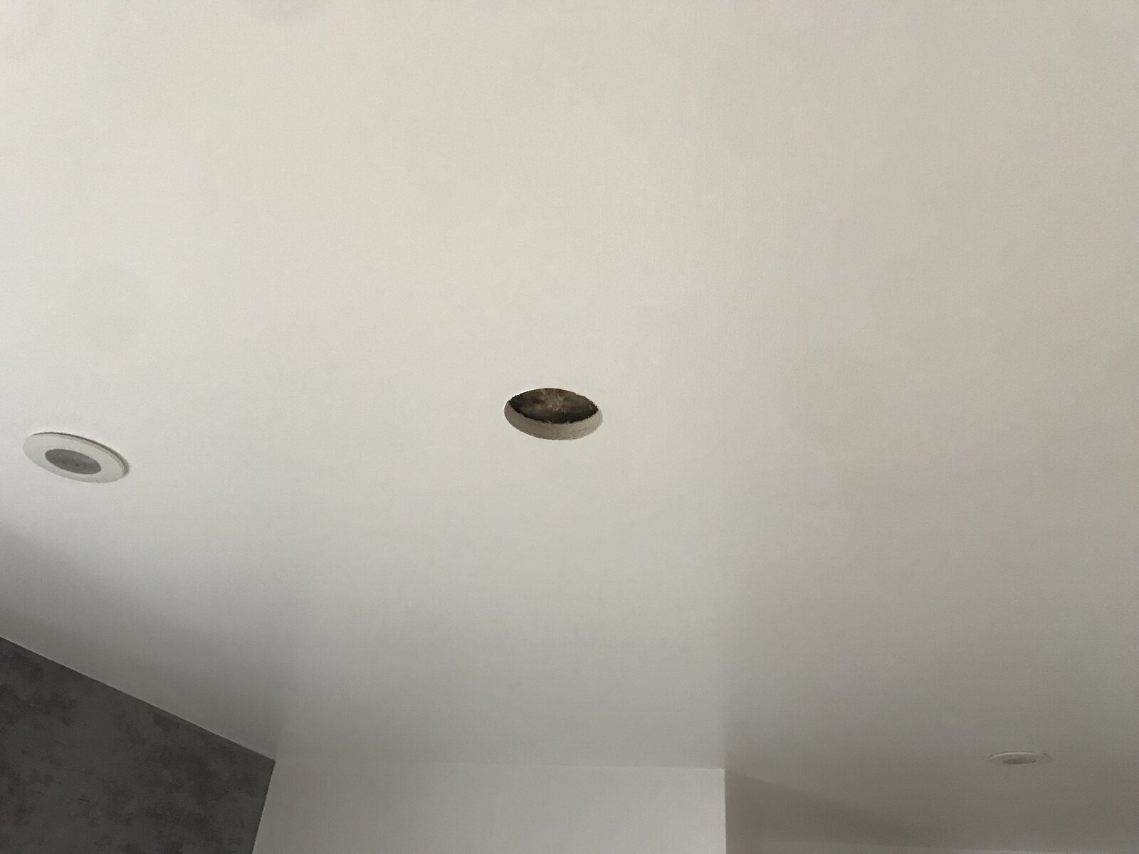

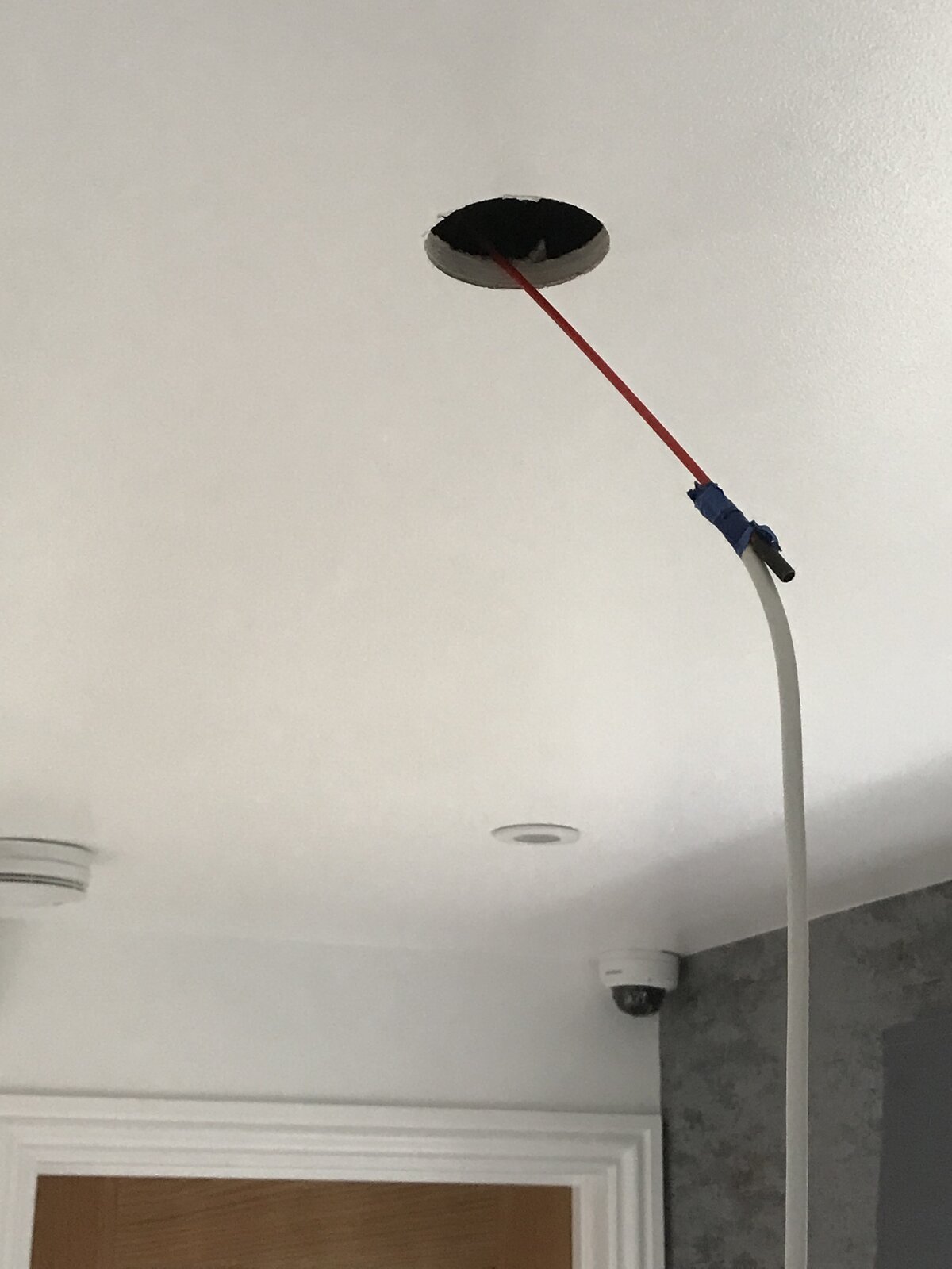

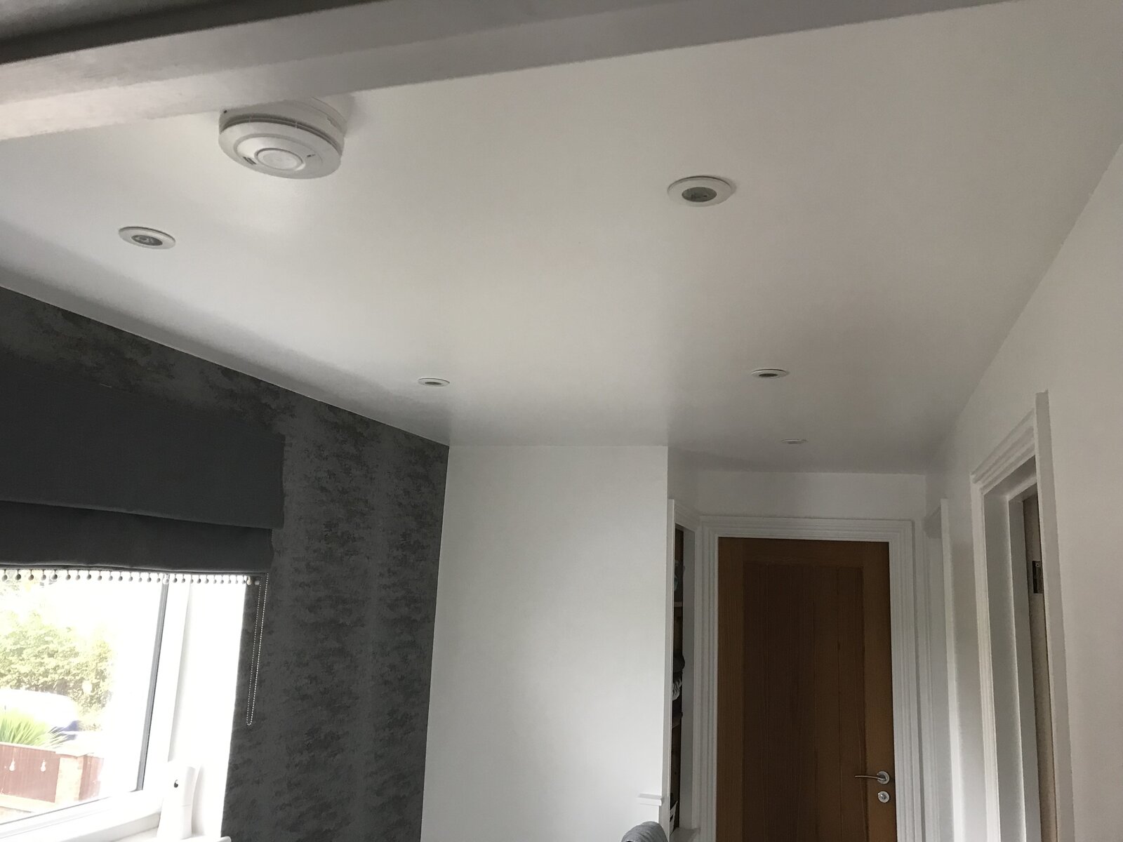

UPDATE: finished this earlier today and used a 3amp fuse in the plug. Could I have gone as low as 1amp (if it exists!) given how little the bulb is pulling?
Here are some pictures from the project.
Thanks for all your help.
