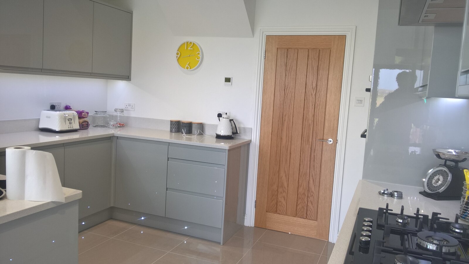

I’ve got a bunch of plinth lights and cabinet lights that came with a plug running off my lighting circuit. The light switch on the wall activates the socket under the kitchen cupboards (behind the plinth) and this then switches on all the led’s.
I didn’t want individual plugs for the lights. It would have been impractical.
