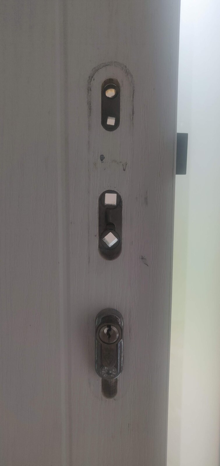

I checked again and could not see the main spindle hole being partitioned to use a split spindle but saw other ones which I have no idea what they are for, please see the attached piccie. The one currently in use is the third from top, the 2nd and 4th I have no clue what they are for.
Also, checking the door it seems the main body is good quality wood and the outer layer is plastic, so a composite door. We have no paperwork regarding the warranty of it so, not sure we could claim anything at all...

Right... Firstly thats a composite door you have there by the looks of it. Secondly , by using a split spindle (Lever /pad handle ) you will not be able to engage the multipoint locks nightlatch from outside , but would be able to do so with the key , from inside the handle would work as before. The way the split spindle works is by utilising BOTH spindle holes (middle holes of your picture ). If you take your current handle off and put the existing spindle in the other hole to where it is now and operate the handle you will see that the downward motion of the handle does not operate the ' latch ', but turning the key does. What happens with a split spindle handle (lever / Pad Handle )is that one spindle goes in the top hole , and one in the bottom spindle hole, thus giving you a split spindle effect. From memoery top hole is internal handle/spindle , bottom hole is external handle/spindle
Ok, I think I am getting there: hole number 4 operates the multilock but not the mortice latch, i.e. from outside, moving up and down the handle, moves the spindle in number 4 and this engages/disengages the hooks of the multilock but I'd need to use the key to retract basic latch. Is that correct?
If so, you guys are suggesting a dual spindle (just found out what its name is!).
If the 2nd hole in the picture is for a snib so it can lock the latch from inside without using a key, that be great!
I found this set "Balmoral Sprung Offset Snib Lever Pad Door Handle" but someone complained in amazon the snib didn't do anything (it does not say whether the set comes with a little spindle for the snib). Any recommendations? I'll obviously make sure the measurements are correct.
That sounds right.
The snib would be hole 2 , and what that would do is keep the ' latch ' retracted so that the door doesn't latch behind you if you went outside without the key.
I can't comment how good or not the handles you have seen are , it may be a case of the person who wrote that review didn't actually have the facility for a snib on the mutlipoint locks gearbox....not all do
Many thanks for your help everyone! Basically you explained the door does not need an extra night latch since it is already available, it's only a matter of changing the handle set.
