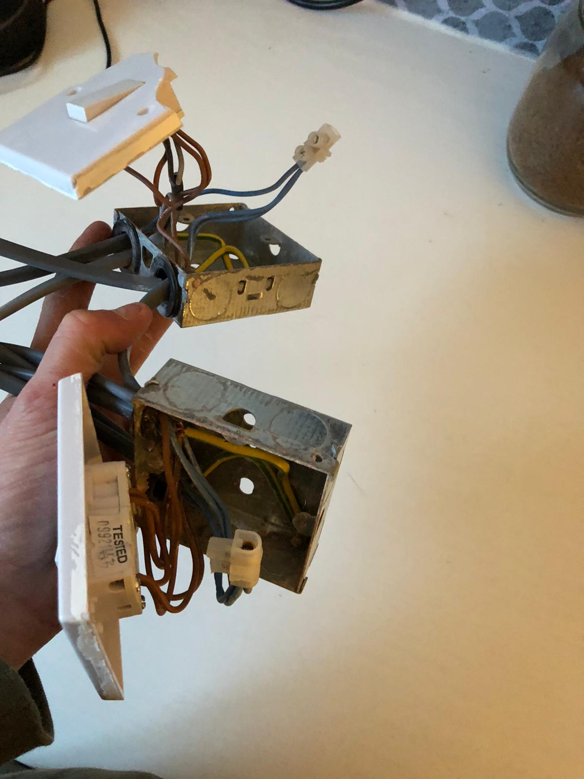

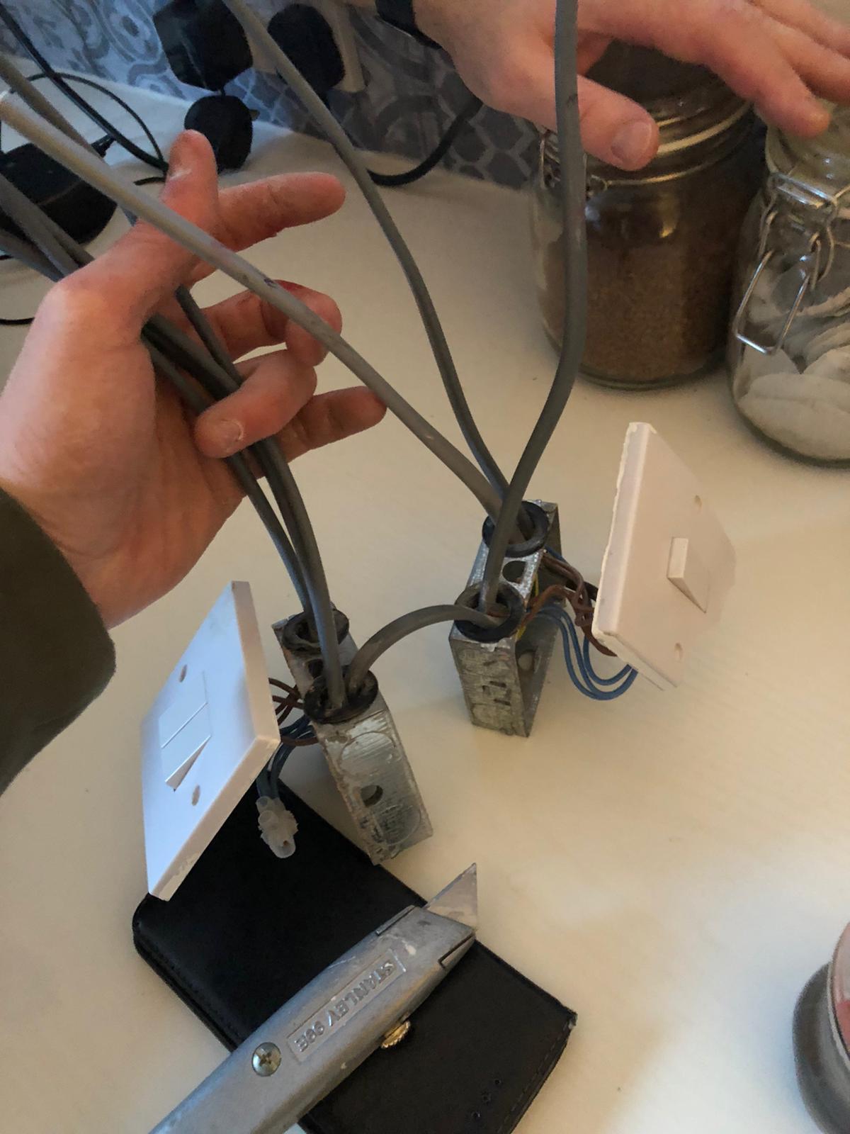

Had a 2 gang 2 way switch on 1 side of wall and 1 gang switch on other side of wall that has since come down. 7 cables in total. Was thinking of getting a 3 gang 2 way switch. Hell of a lot of cable so going for a 3 way 2 game double plate and deep back box. The 2 gang switch (1 switch for main kitchen light and 1 switch for kitchen spots) had a cable which went through wall into the 1 gang switch. Am I right in thinking its acting as a circuit supply to the single switch.. heres pics I have IMG-20210125-WA0001.jpgIMG-20210125-WA0003.jpg

Looks to me the single switch with 4 cables total is 2 way and 2 gang switch with 5 cables total is a single way and either 2 way or single way with 2 cable going off to 2 lights. Possible 3rd option is loop in and 2 loop outs. Let's have a picture of the back of the 2G switch to see which terminals are in use etc.
Which ever options you have there the link does look like the permanent supply looped around the whole of the lighting circuit.
Looking again I believe I see the 2 gang is 2 one way switches and all of the blues are connected together. I suggest you mark/number each of the 8 cable sheaths [7 plus the link] and the switches then record on a list where each brown, black and grey wire go:

1 mains going to 1 switch and looped live to other 2.
Single switch was a 2 way switch for living room light. Double switch was a 1 way for kitchen spots and kitchen main light. Mains cable wired to L1 in middle switch completed the circuit for rest of lighting circuit downstairs. Nightmare was made worse by some1 marking cable 1 and 7 wrong way round. Everytime I wired kitchen main light into 1 of the 1 way switches it turned the back outdoor light on. Until I realised. All earths together sleeved and all neutrals together. Managed to get it all in a 3 way switch with a normal back box. Some wires that.
