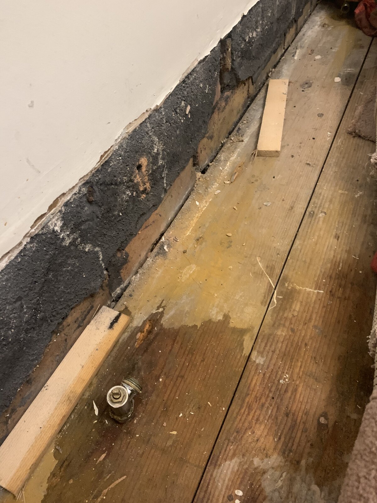

Another thing if anyone can help
When I had the spillage it was not this pipe. It was the other pipe spewing water out! This one seems to have a slow leak. I just turned the valve as tight as it will go. It had a tiny bit extra to turn.
I will leave this overnight but if the water hasn’t dried overnight, any idea what’s going on?
the pipe doesn’t seem very wet there is no obvious leak. I presume this is just a tiny trickle from the valve and may be ok when the rad is back on?
this accumulation is over about 24h, there is no noticeable leak from anywhere. The coupler is damp to the touch and the nut which holds the valve on is ever so slightly damp but it’s been resting on the damp floor

Leaks can take a little while to dry out, shouldn’t be dry by tomorrow. Perhaps call a plumber to remove the other 3, then get him or her to put them back on.

ps that water leak is almost gone. Now I closed up the valve it is much reduced this am thank god!
