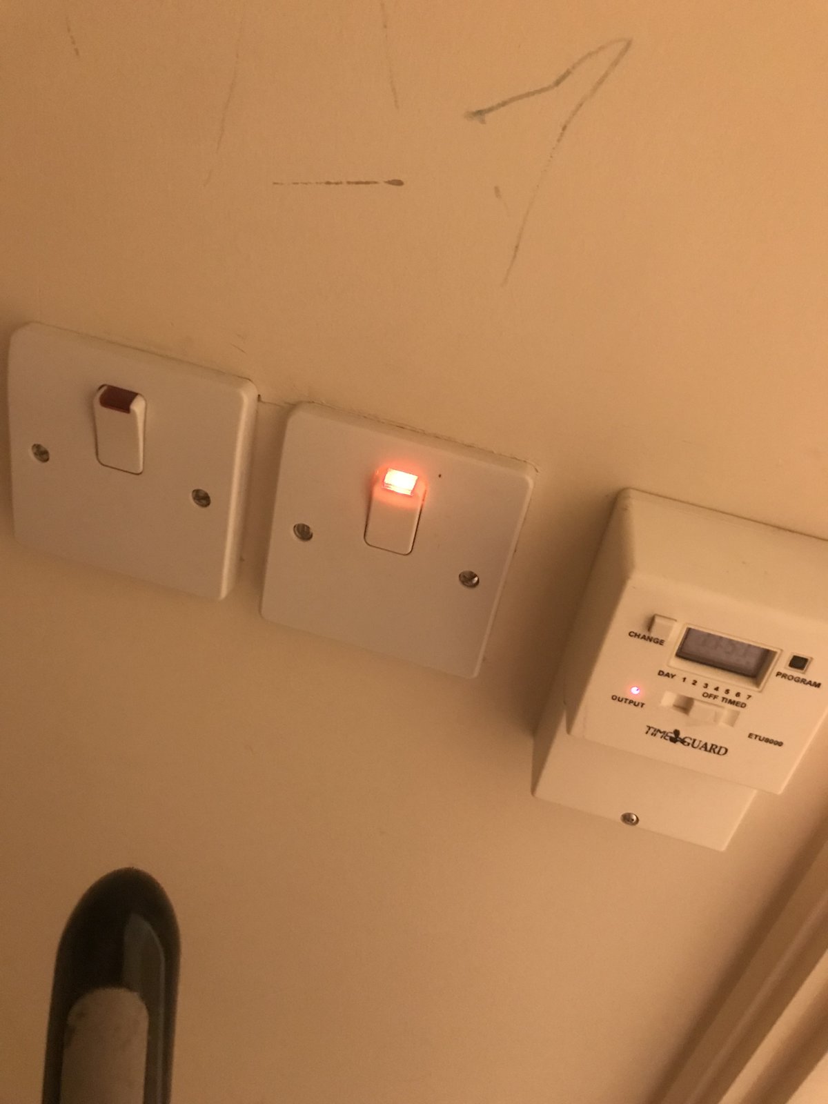

First time post and wasn’t sure whether to pop this in plumbing and heating or electrics.. I’ve just moved into a flat last week and cannot for the life of me figure out the hot water. I’ve finally managed to find a guide online to the timer that’s in use, but I still can’t get it to work.
The flat is entirely electric, and I believe I have an immersion hot water tank. Now on the wall next to these there are two switches with lights - both switches are on but the light on the left one is not.

your timer is set to off click it to the right and wait an hour or so and you will have hot water, when you set it to on the other neon should come on
I’ve also put it on override about four hours ago, still no hot water?

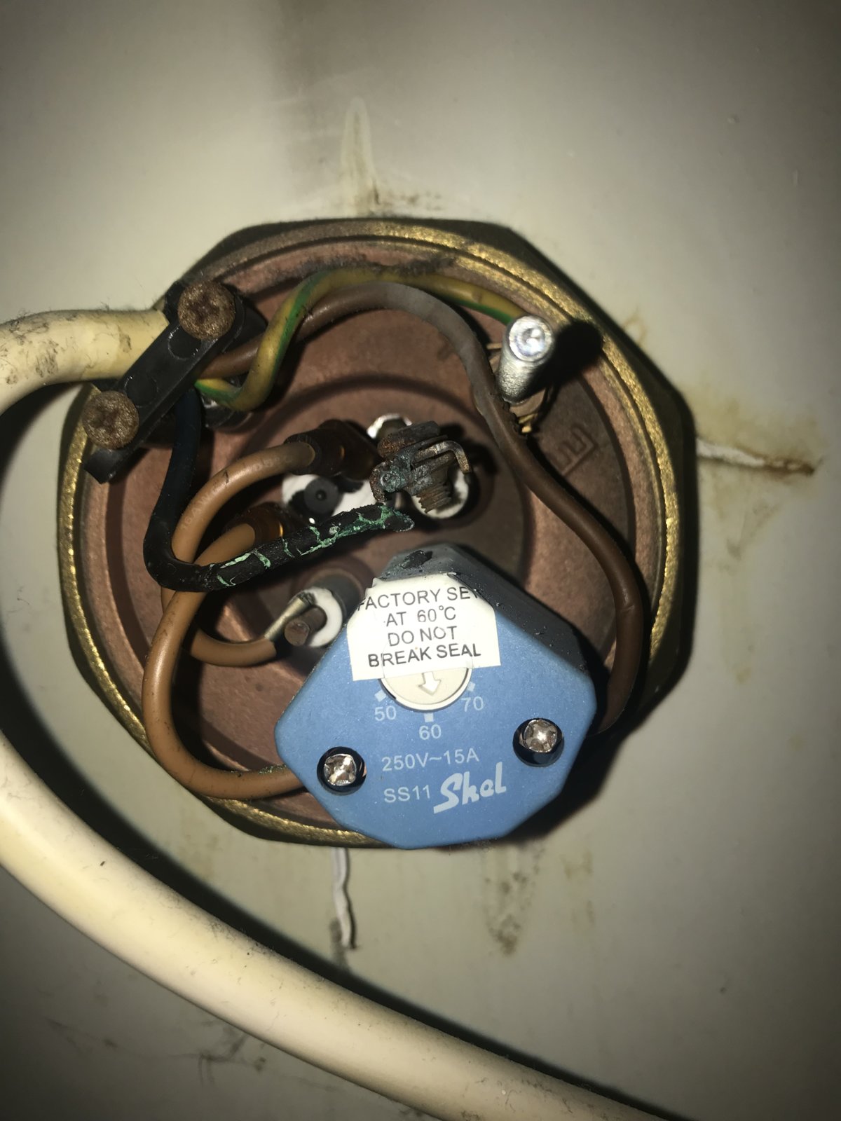

I’m potentially being blind, but I can’t see a reset button. It’s a SHEL SS11..??
Just noticed that black wire doesn’t look great does it...
No its not good. Needs re wiring.
The stat is an old type and does not have a cut out.

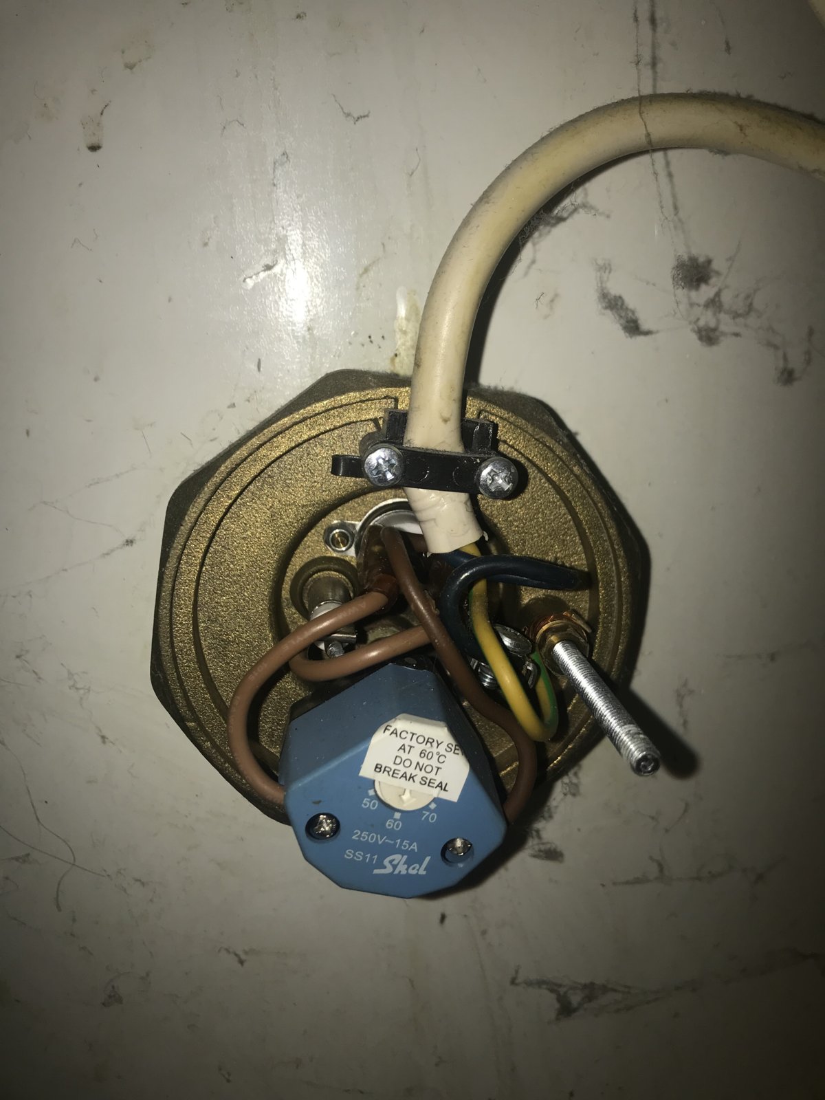

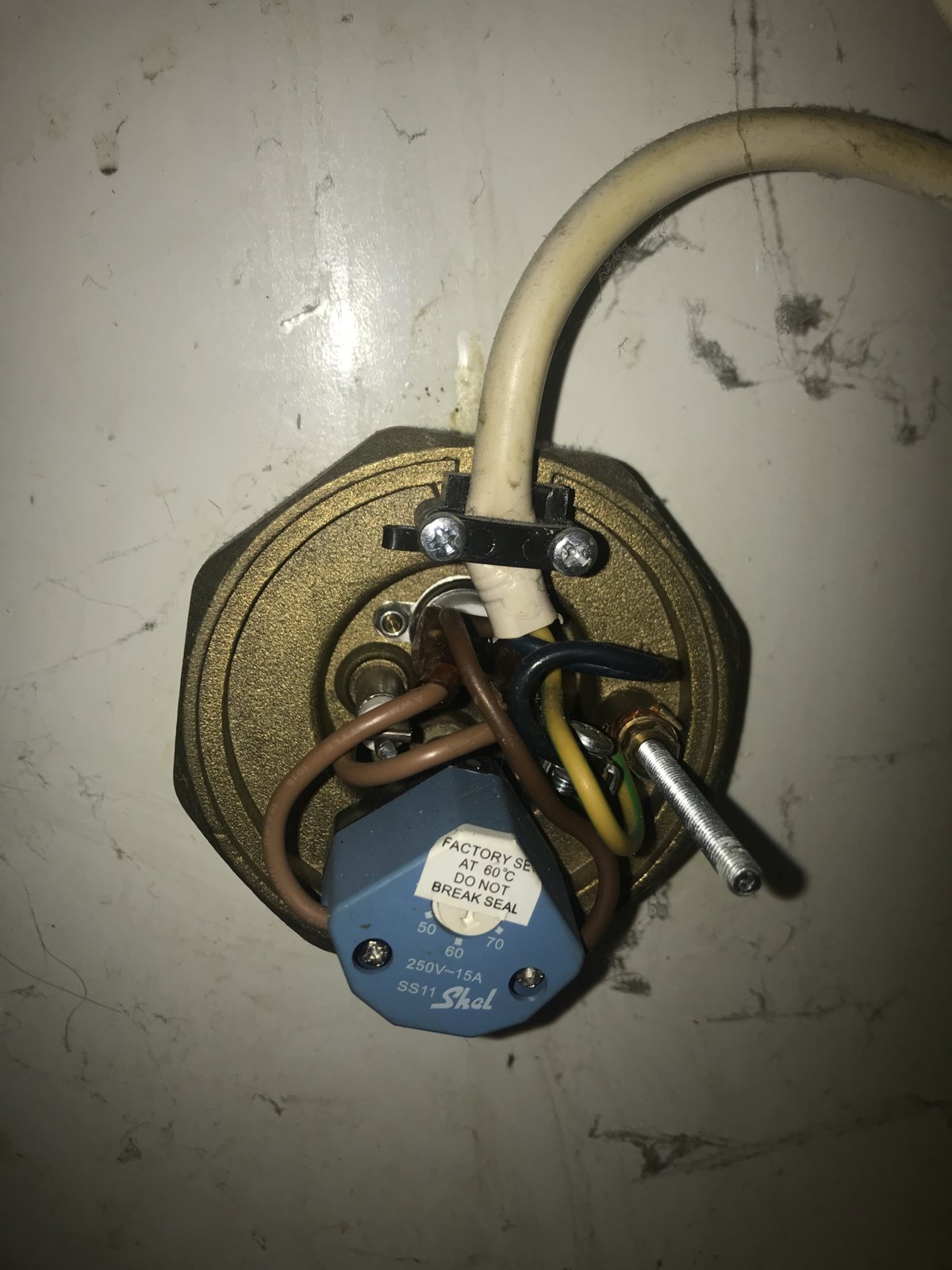

What is the other immersions condition ?
Second looks okay! I’m happy with most DIY but feel like this is an electricians job as it isn’t just replacing the element by the looks of it...
View attachment 170562 Second looks okay! I’m happy with most DIY but feel like this is an electricians job as it isn’t just replacing the element by the looks of it...
I take it that's the lower element in the cylinder ,which looks in good condition. This is often connected to an off peak electricity supply ,is yours ?
By all means if you are not comfortable with electrics call in a pro ,however if the actual element needs replacing ( which I doubt) you will need a plumber .
The other element ,with insulation damage on the neutral conductor, can easily be rectified by cutting back the cable a few inches ,cleaning the terminal and re connecting ,it may then work.
