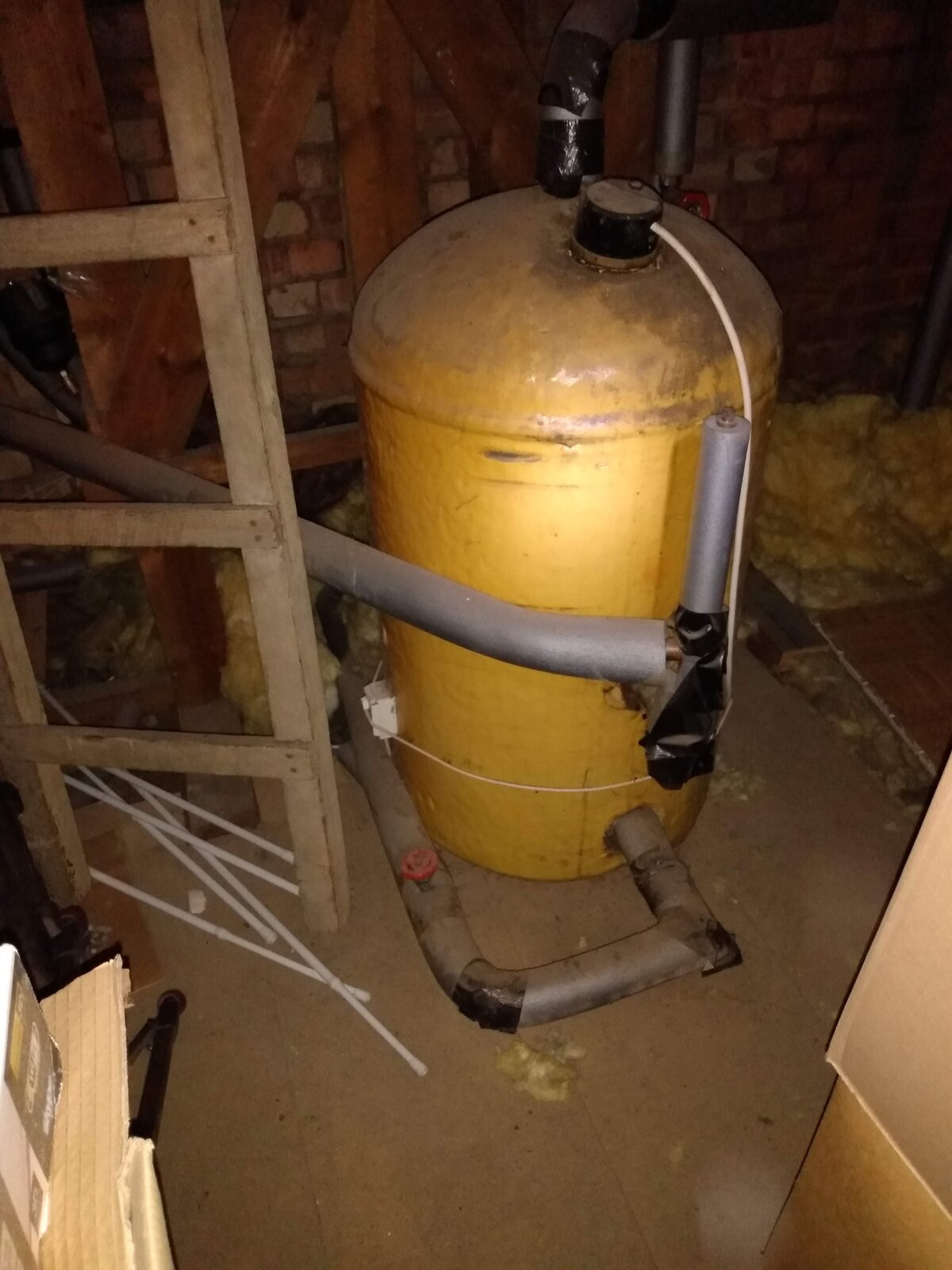

Desperately need a shower after 5 hours of removing tiles and plaster from old kitchen.
But no hot water. My son mentioned the water wasn't very warm when he had shower at 10am.
Hot water comes on 6.30-8am, 12-2pm, and 5-7pm, so should be plenty of hot water.
Increased it from 1 hour twice a day a week ago when the weather got colder, thinking cold water tank was just video. Maybe an issue started then....
But now nothing. Water isn't just warm now, but freezing.
I've put the electric immersion on, hopefully that will work.

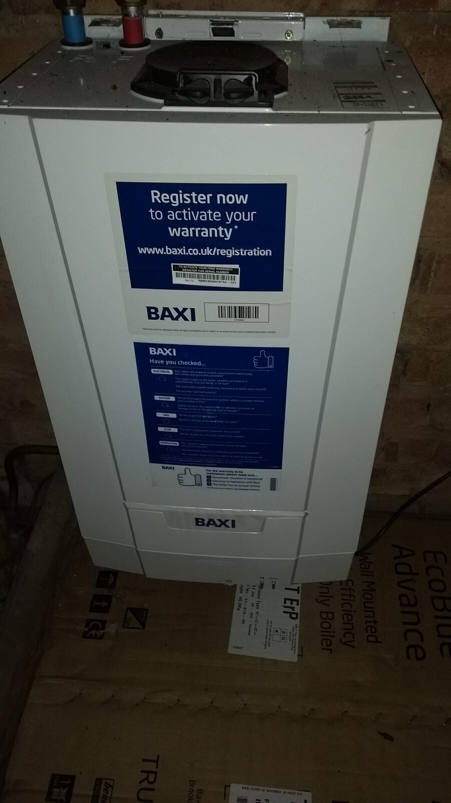

It's as Baxi boiler.
Radiators are all hot.
Anything i could look at before calling a plumber?
I've just turned the heating off to see if that helps. Hot water tank is wrapped in insulation now.
Probably a motorised valve issue. 2 port or 3 port? System boiler or regular open vent?
if you bleed the highest radiator in the house, does water squirt out forcefully, and without dying away?

although not so well if the cylinder is in the loft. Is there a bleed vent on the cylinder piping?
edit
yes I think there is. On the top of that stub pipe on the front. While you're up there, look in the small tank. How deep is the water, and how deep is the mud?
Can’t see a filling loop, so perhaps regular. Check the motorised valve.
Well, within an hour of immersion and heating iff, nice hot shower. Immersion off again, might see if alternating hot water and heating will solve this for now...
I appreciate your advice, but honestly don't know how to do it! If i knew what a motorized valve looked like, or whereabouts to find it, or how to check it is working, I'd take a look.
I'll get a plumber round.
I always leave my hot water on permanently. The cost vs. timed is negligible and you can always be assured of a cylinder of hot water. It’ll only call for heat when it’s needed instead of going stone cold. BTW a 'plumber' might not be able to deal with electrical valves/heating problem etc so if you have to call someone in, call a heating engineer but personally I’d try it on permanent first.
