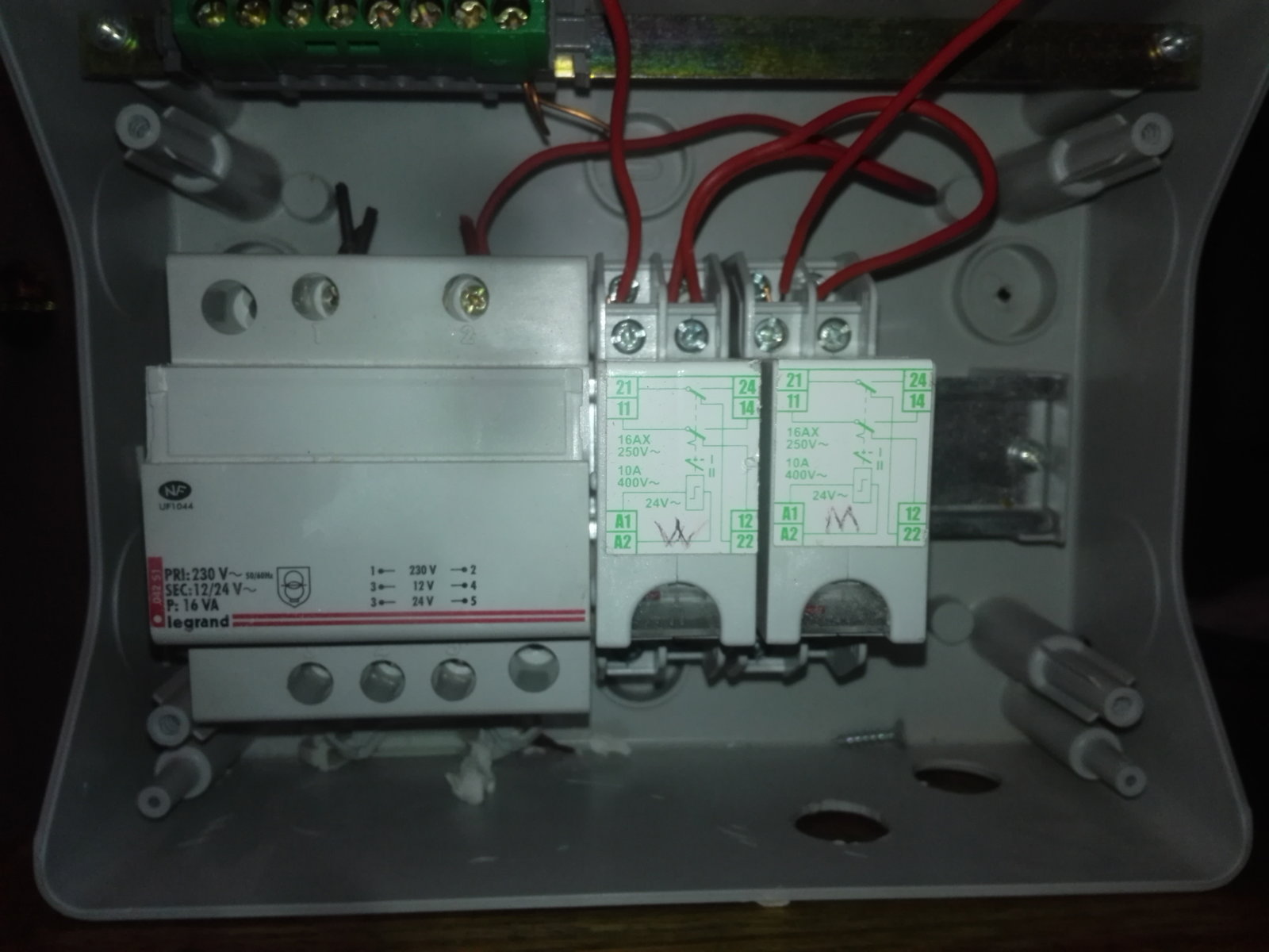

I have done the same in my kids' bedrooms with a 24V relay and PTM switches.
Can dig out an old relay if you like and look at the way I wired it.

Yes please, Thanks very much, voltage is 24V.
OK.
1 & 2 are 230V in to transformer and looped from there is N out to the lamp(s) and 230V live to the relay terminal 14.
Terminal 11 is the 230V output switched via the 24V-fed PTM through the coil.
The 24V -ve output from the transformer goes to A2.
The 24 +ve output from the transformer goes to one side of the PTM switch.
The other side of the PTM switch goes to A1.
So you have 24V from the tx feeding the relay coil through the PTM switch. When briefly energised by the PTM switch, the relay connects terminals 14 and 11, sending a 230V feed to the lamp(s) - via a local transformer of course if the lamps are 24V.
When you hit the PTM switch again, the lamp(s) extinguish.
The only thing is, I can't see a part number for the relay!
