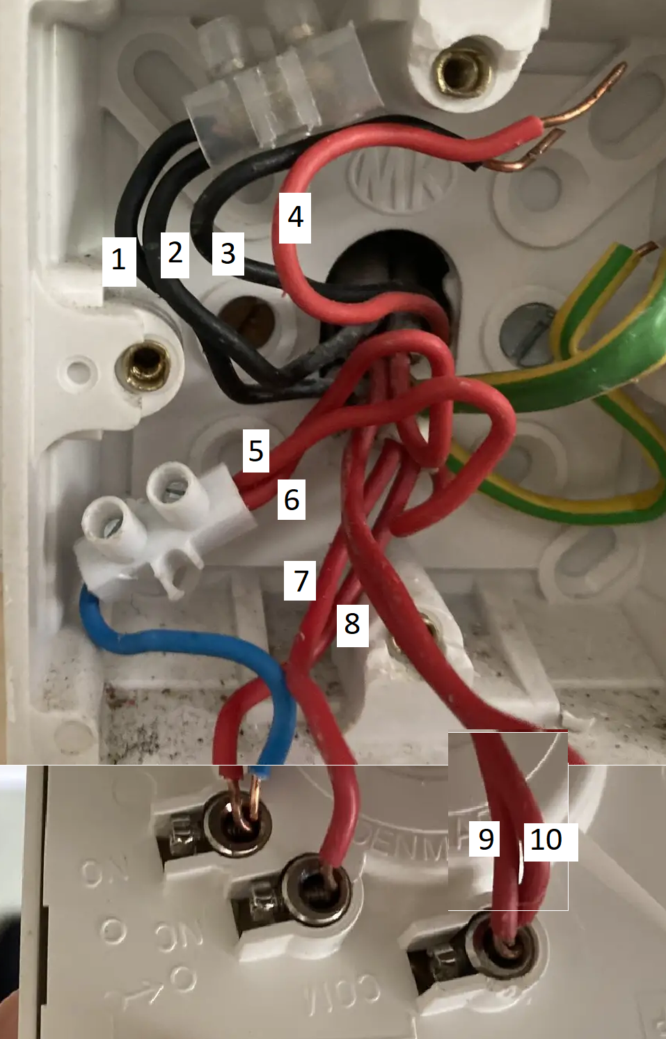

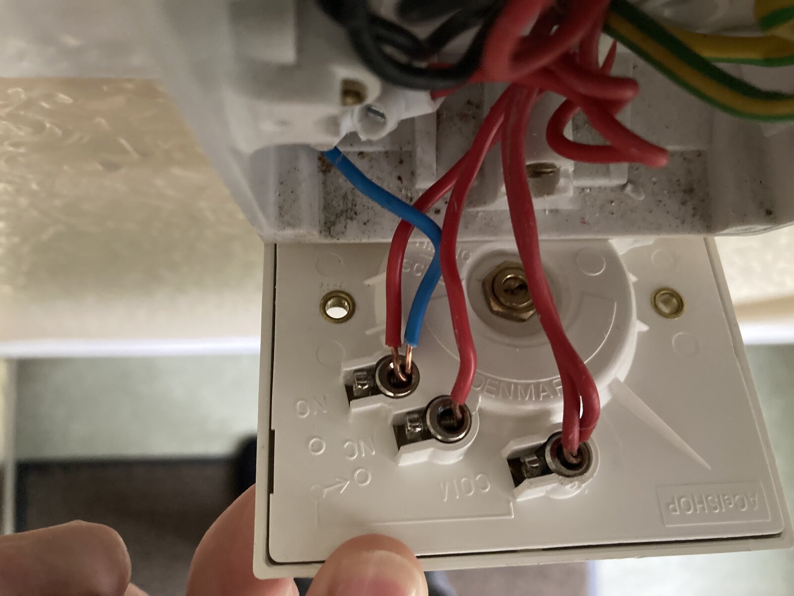

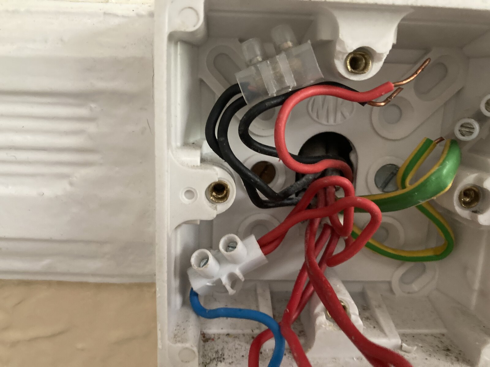

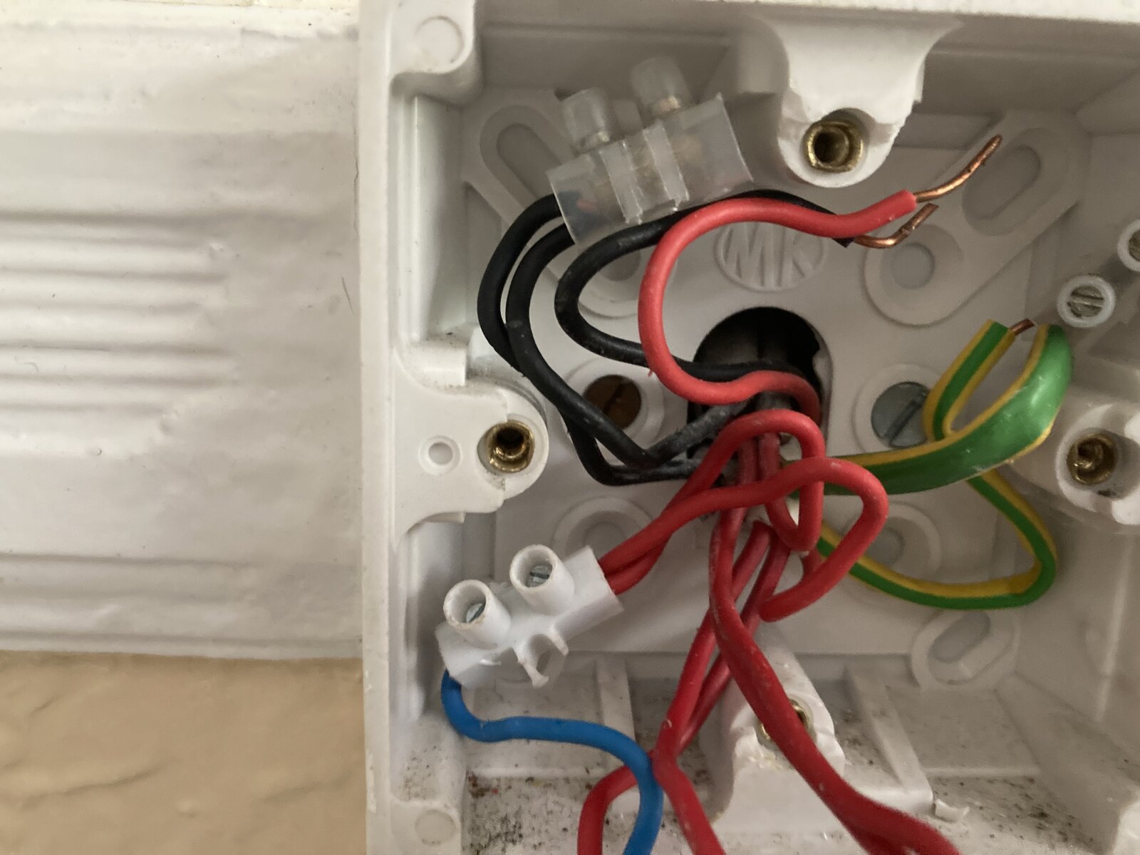

Hi, In my flats we have old push button timer switches, bt one is playing up (button staying in). I've bought a new switch to replace it (not a push button), but the connections are all labelled differently, so simple like-for-like is not possible. Old wiring also not clearly labelled or identified (which doesn't help).
There are 3 push button switches in total all controlling 3 stairwell lights. I am only replacing one switch.
Old switch IMG_2623[1].JPGIMG_2627[1].JPG:
Com has two connecting wires(both red),
NC has one wire (red)
NO has two wires (1 blue, 1 red).

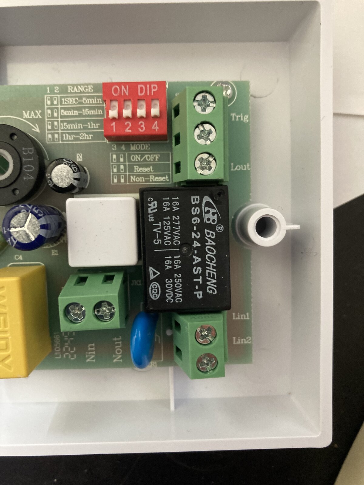

New switch has the following connections:
Nin
Nout
Lin1
Lin2
Trig
Lout

What else is in the backbox (I see something black)?

Comparing New (https://www.lowenergie.com/wp-conte...3A-Multi-Use-Touch-Activated-Timer-Switch.pdf )and Old
Live (which should be Line) = COM
Live-Out (should be Line-Out) = NO (Normally Open)
On the Circuit Board,
L-OUT will be (Live-Out)/Line-Out
Lin1 and Lin2 are "junctions" for the any two Line conductors (Line-In and Line-Out)
Nin and Nout are "junctions" for any two Neutral conductors
Why there is any connection on the "Old" switch to NC (Normally Closed) terminal, I know not - and there seems to be no such "provision" on the "New" device !

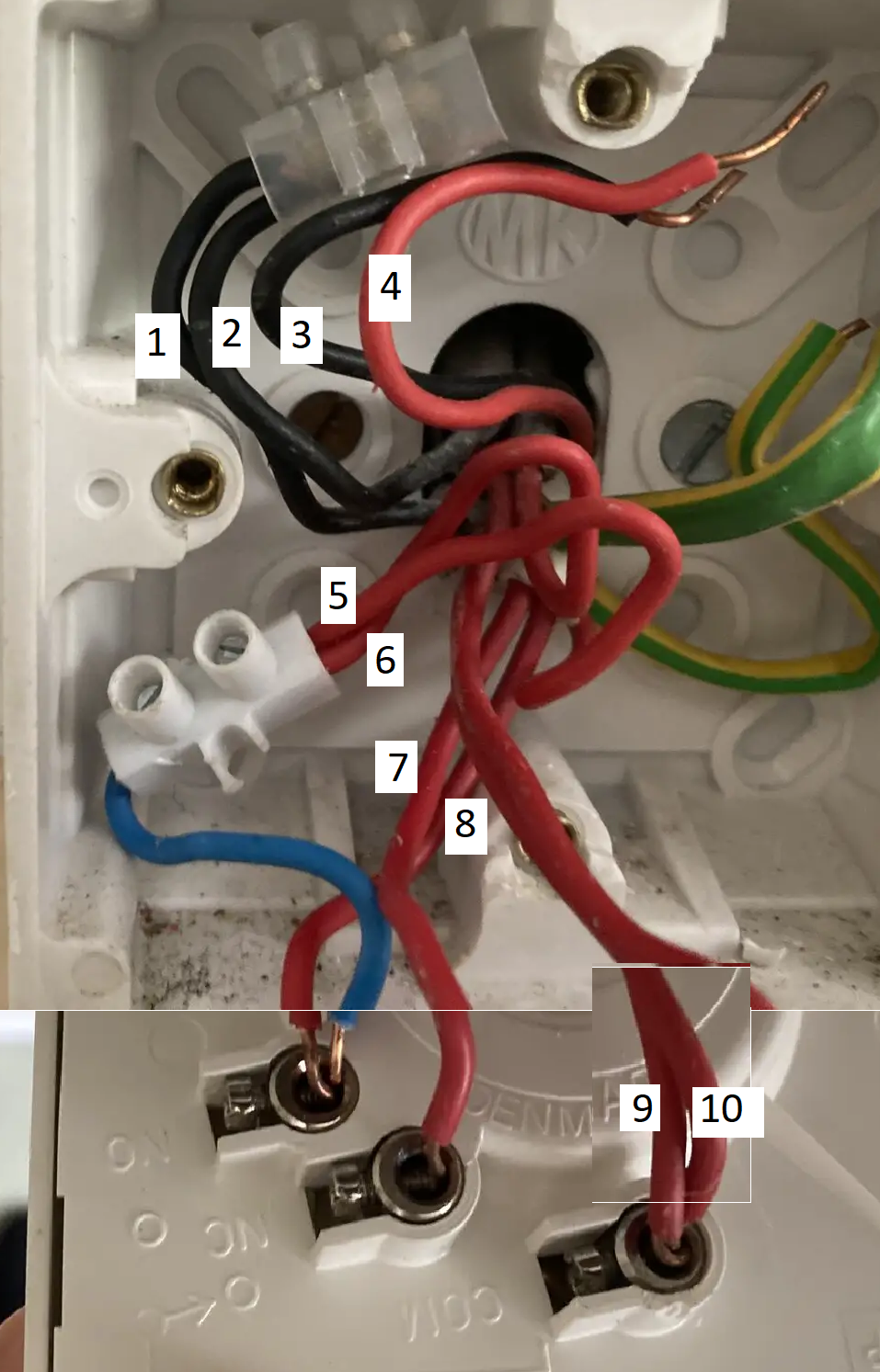

Could you do a favour and confirm which wires go with which in cables.
I think its
1-9 or 10
2-6
3-4
5-9 or 10
7-8
Once you have worked that out could you disconnect the wire '7' in 'NC' (with power off of course) then test to see if the other 2 switches still function. (I'm guessing one won't work).
