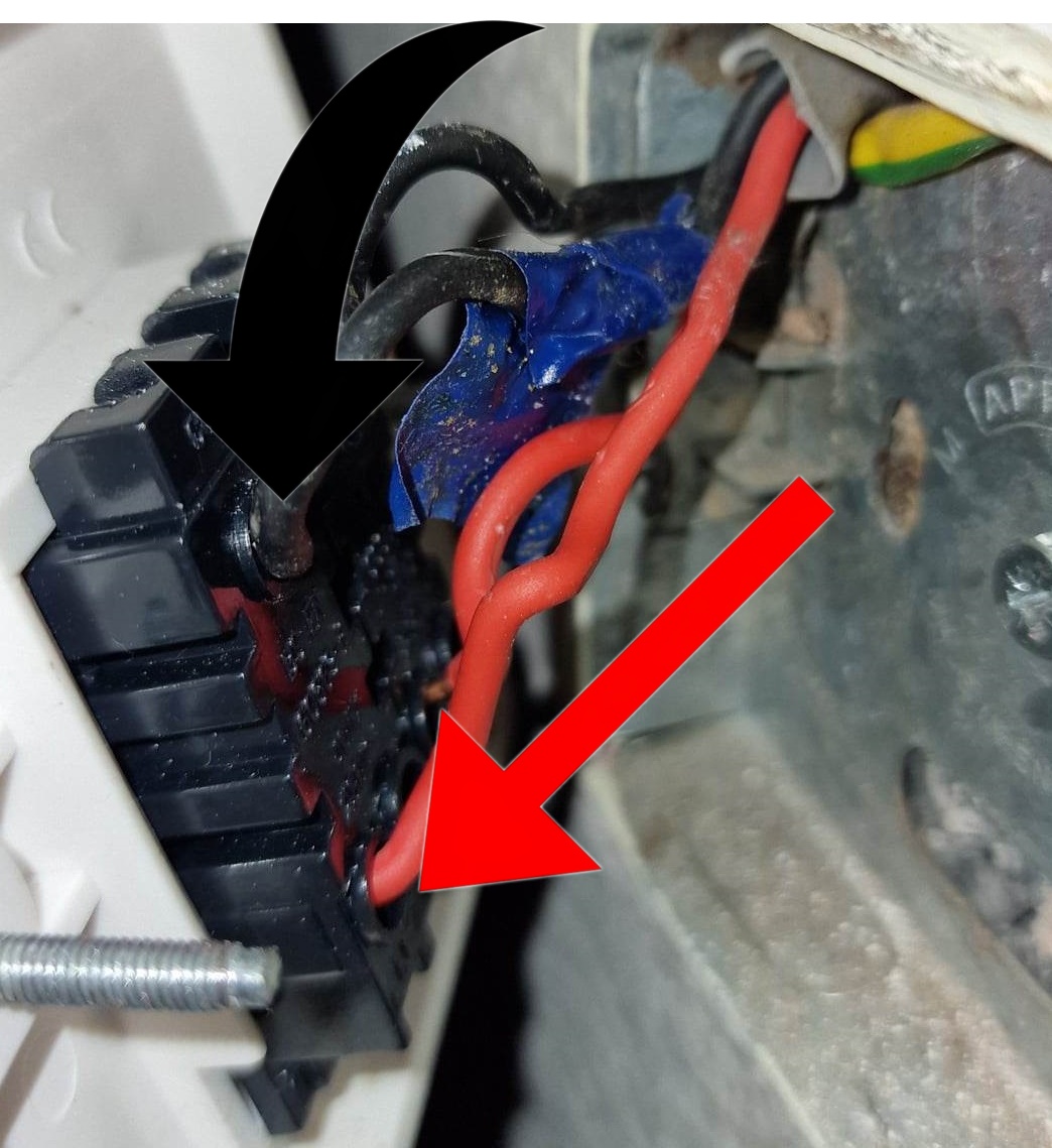

Hi probes test on both connections as shown in pic cheers

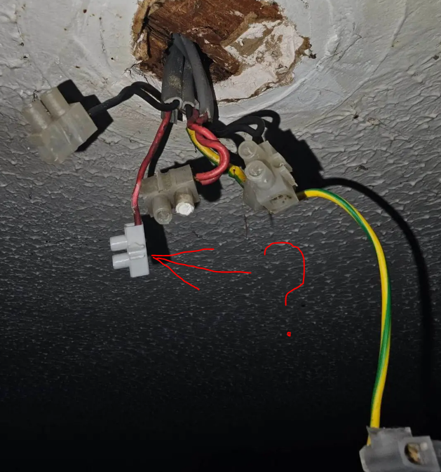

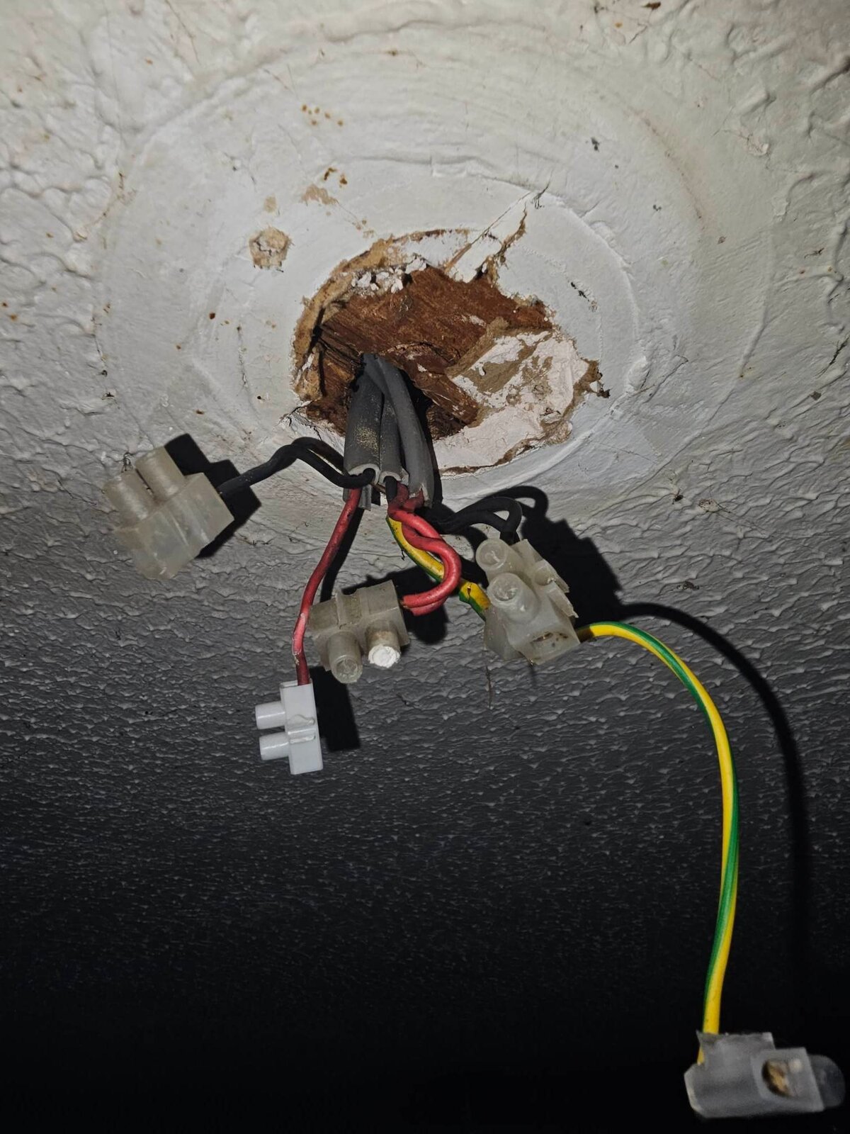

Also existing wiring on the rose

It appears that you are connecting to two line conductors ?That is not how to measure voltages.
What is the cable at the ceiling that has red and black conductors ,each in seperate connector blocks , not connected to anything else ?
The red and black connections were wired to the light fitting, I have taken it light off for testing and picture purposes. Can you tell me what connections need to be test on the light switch please. Cheers
Are you sure those 2 ( red and black) wires connected directly to the light fitting ?
Is the light fitting one of two That works from the same switch ?
