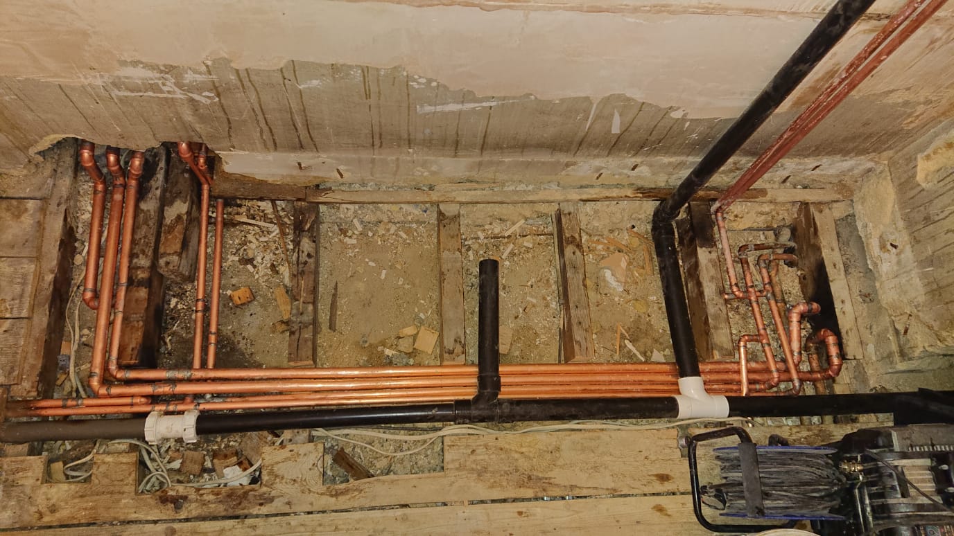

As @Madrab has already said, I'm more concerned about the integrity of the joists which have been notched. Do you know how deep the joists are? The photos are a too grainy for me to tell if there is insulation between them, under the pipes.
The waste pipe run is not good as there's no fall on it, let alone the bidirectional tees.
Ticking pipes is something we do our best to avoid but it can't always be guaranteed not to happen. The pipe runs are too close together and could have done with felt lagging in the notches to act as an acoustic sleeve.
If it's structurally sound, then I guess you'd have to learn to live with the noise as it's all finished and would be arduous to detect and resolve... You might pull it all up and redo and find there is still a noise(s)... May I add that, as a parent of a toddler, your hearing is likely to be hypersensitive and your brain is searching for noises... No offence, but sound is another sensitivity that is unique to the individual.
Thank you, we like his tiling and finish but what happened underneath and this noise. I guess he is not good at plumbing.
The noise has been coming from the pipes the day he put them . He kept saying it was the boiler and he would fix it. We just trusted his words ... This morning he said it is the waste pipe. Why is it making noise at night when noone is using the bathroom.. ? Is it connected to the heating system? Will it stop if I turn off the heating?
The loud ones are by the sink area and also shower cubicle that is closed to the sink. Pipes are under the sink and shower cubicle.. please see photos...

The waste pipe is sitting atop the pipes, so naturally when the pipes are expanding and contracting (knocking and banging) it's going to resonate through the waste pipe
@Nisha2021, I appreciate the finish may be good and it's not what you want to hear but if those joists have been cut the way several of us professionals on here think they have been then the ticking is the least of the problems.
To put it bluntly:-
judging the depth of the notch in those joists by taking the size of the 40mm waste pipe adding that to the 22mm pipe it's sitting on and with room to spare to then get the floor board on top of that, then unless you have joists that are over half a meter deep (the notch shouldn't be any more than 1/8th of the depth of the joist) then the depth, breadth and where on the joist they have been cut could have compromised the strength of the joist and the whole floor could now be dangerous. If they are compromised then best case is that the joists could sag, worst case they could break. Don't forget, the joists are what hold the whole floor up, if they cant do that then the whole floor comes down into the kitchen.
Honestly, you really need to talk to a structural engineer or experienced local joiner ASAP and show them the pictures and ask them to comment on the viability of the floor.

The size of depth is 42 mm for waste pipe and 25 mm for copper pipes in the joists...

OK, going with those pipe dimensions and to keep within the regs for notching joists, you joist would need to be at least 560mm deep (approx 70mm x 8 )
As per the building regulations, even with the largest standard floor joist size @ around 300mm deep then the largest notch that can be cut into it is 35mm. To accept the notch that has been cut in those joists, even if it wasn't too wide (which it seems to be) and in the wrong place on the joist (within the centre of the span), the joist itself would need to be a min of 560mm deep. You don't get joists that deep unless they are large roof beams or bespoke timbers which yours don't seem to be.
https://www.labc.co.uk/news/how-get-it-right-notches-holes-solid-timber-joists - 1/3rd of the way down the page, 2nd table, end column.
As far as the noise is concerned then that's not just the normal clicking that you can sometimes get. That's a nightmare and shouldn't be occurring nor would I deem that acceptable. I don't think changing the pipework behind the vanity will make much difference TBH. I would be looking at the way the plumbing has been installed as the likely culprit.
Was this chap a qualified plumber or just a bathroom installer?

The loud banging is resonance through the plastic waste, as it sits directly on top of the copper pipes.
Regards the joists, you need to speak to the bathroom fitter and give him the chance to rectify the fault.
It appear the waste needs to be situated above the joists so you will likely need to alter the bathroom layout for this.
He should really have used common sense before cutting the joists.

Unfortunately he's right, you don't need any qualifications to do plumbing, but you do need qualifications to do plumbing correctly and part of that is being taught what is and isn't allowed when it comes to the notching of joists and setting out pipework properly all of which he obviously doesn't know.
Makes me wonder what else he has left in other jobs if he thinks that butchering job he has done on the floor and that dogs dinner called pipework is ok and safe.
If he has compromised the joists to the point where they are weakened then the only fix for that is remove the pipework and patch them - blocks of hard wood that would be glued and screwed to fill the gaps he's made at an absolute minimum, if not sistering them too. Then the pipework would need set out properly and fitted safely and correctly. Basically it would be a full redesign I'm afraid to say.
As far as any recourse is concerned, then I would say that you are well within your rights to have that all stripped back and made safe on his time. As far as to what you have paid him up to now then, minus any materials then you could be owed that back too but you are then getting into the realms of professional reports and claims against the substandard work.
If he's unwilling to do any remedial work (basically stripping all that out and making the floor joists safe) then I'd be getting in touch with your local council building control, trading standards, citizens advice, mybuilder.com etc for advice.

Got this photo from my husband's phone, shows a bit better... I have put it in the wood forum too.. thank you very much for your time and advice.
