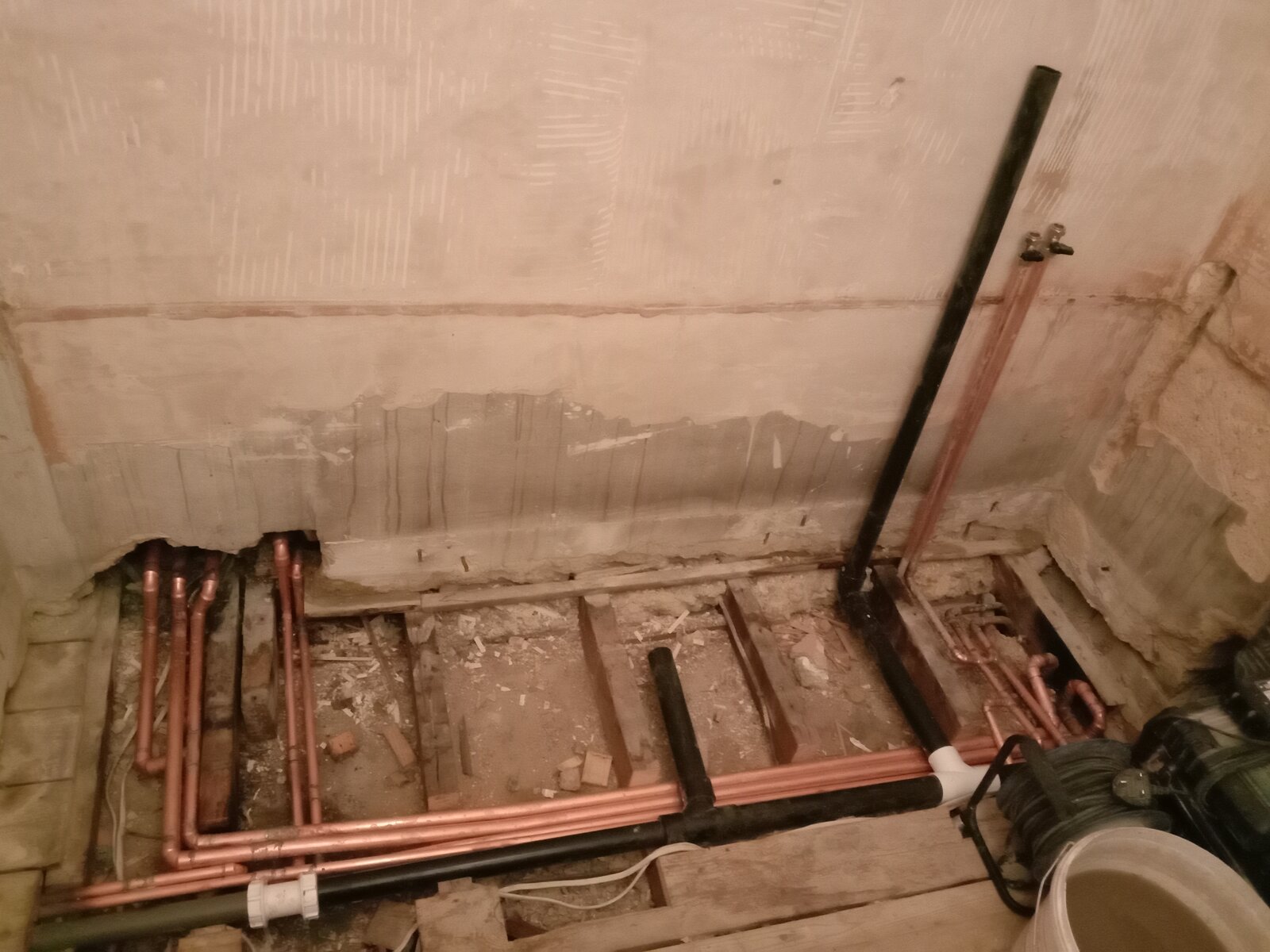

Hey there,
We have recently redone our bathroom and ever since the plumber changed the water pipes, they are making noise. The noise comes and goes. We have some photos of the pipe work, taken out of interest. The plumber said he did not put any insulation around the pipes but did pin them down. One other plumber told us that the pipes are too close together. Please could you have a look into this. During the night the noise does not let me sleep, causing so much stress...

What kind of noise is it they are making? Is it the noise of the water through the pipes or are they ticking/clicking? IMO they are too close together.
Out of interest is that on the ground floor and are those joist sitting on something below?

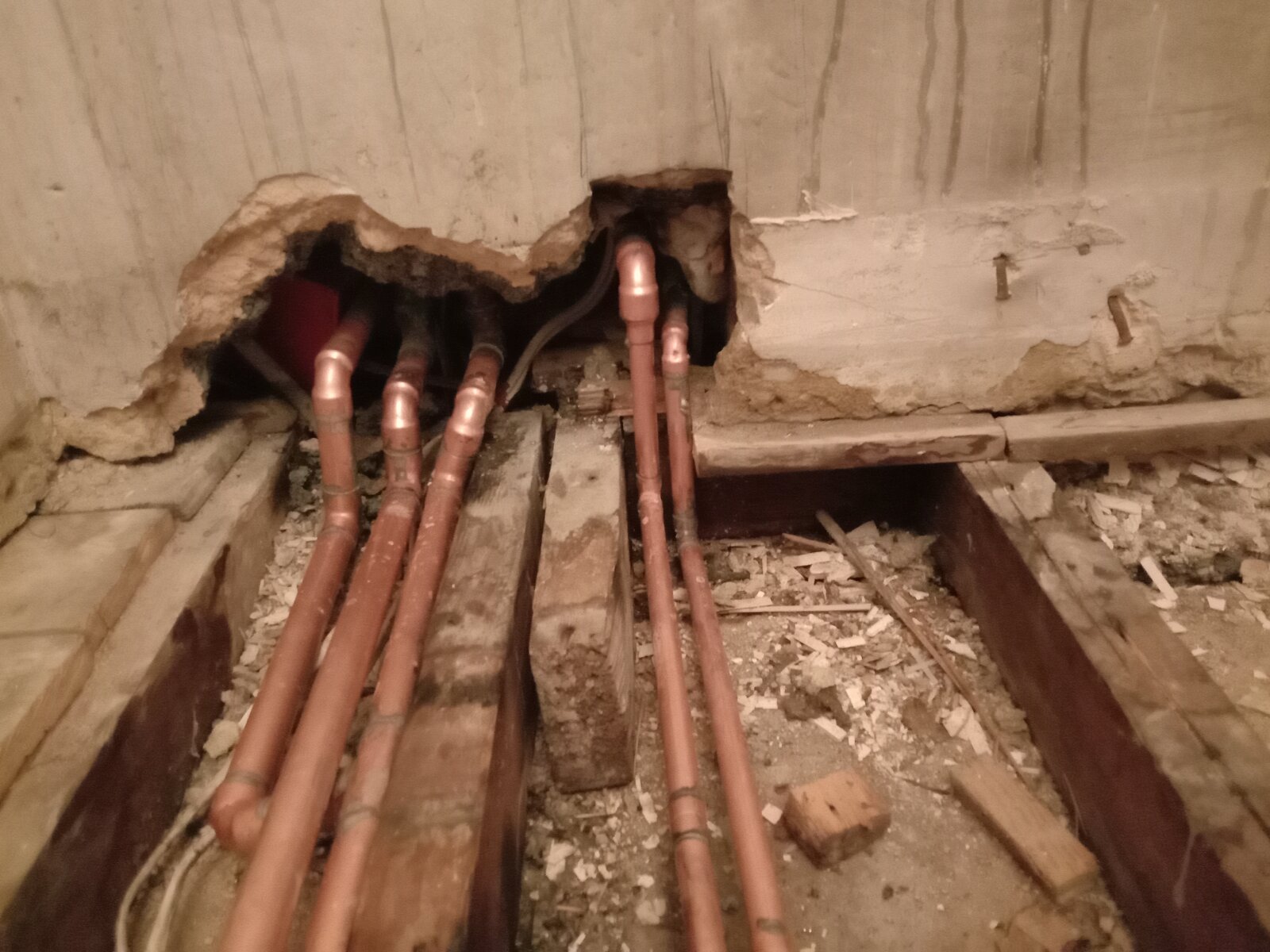

I'd be a little more concerned about the size/depth of the notches that have been made in those joists to get all that to fit TBH.

The only thing that can really be done is either re-do the pipework or insert material in between the pipes themselves to stop them expanding and contracting against each other which is undoubtedly what's causing the noise. Correct setting out is plumbing 101 though.
Not being on site it's difficult to suggest if the notching of the joists is an issue but I wouldn't have fitted that much into one notch, especially with the waste pipes in there too. Not sure what can be done about it but I'd be tempted to get an experienced/recommended joiner in to assess their condition.

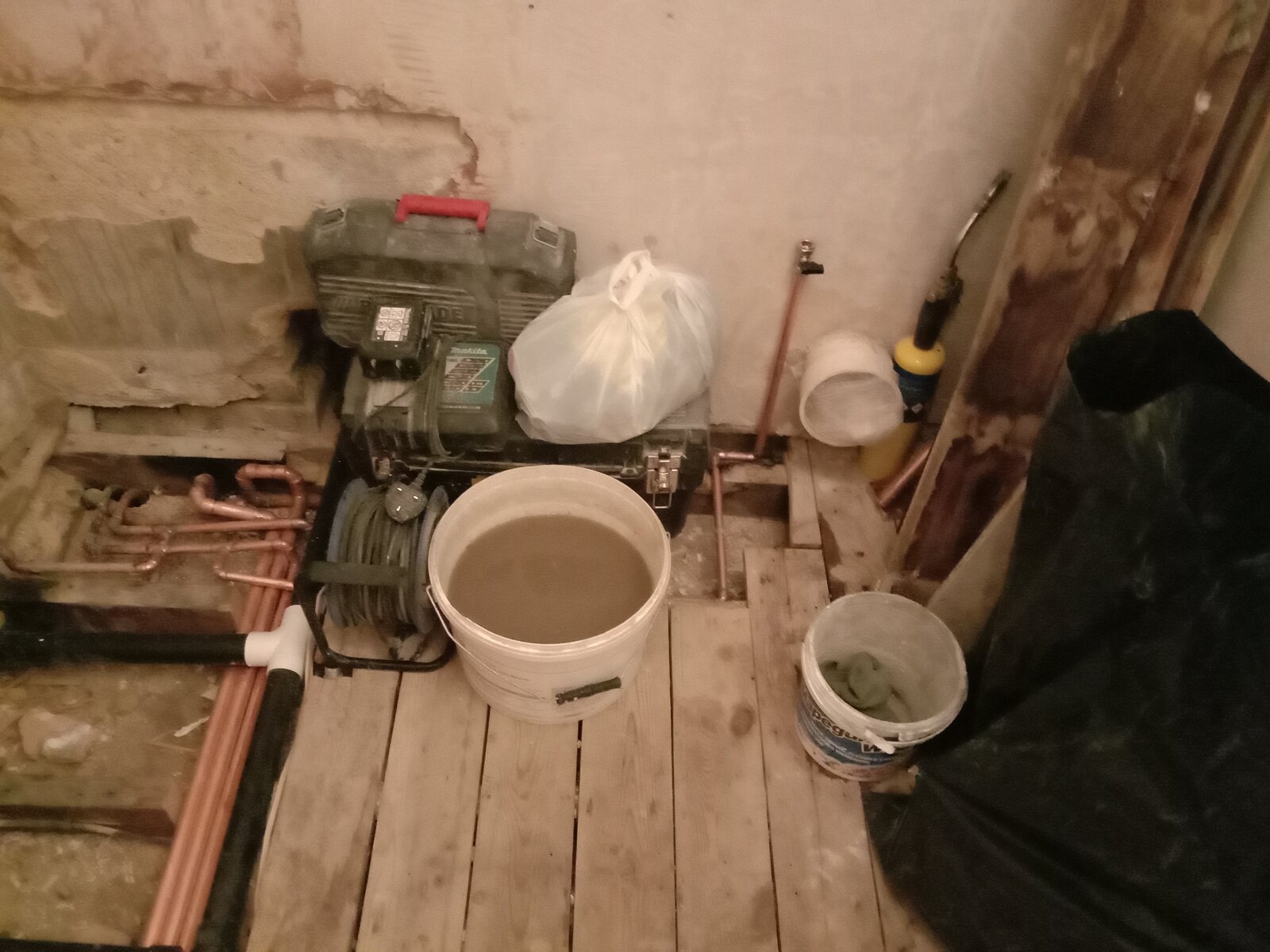

Just noticed that there are also 2 swept tee's running away from each other, so at least one of them is wrong. Is the shower sitting above those pipes and on those notched joists, where the black pipe in the centre is running to?

Can I suggest that you maybe want to pop this message into the wood forum too with the pics and ask about the joists. I don't mean to sound like the doom and gloom but I really am concerned about the size of the cuts in all the joists, especially with a shower sitting on it too. How large is the shower? @dilalio, @Hugh Jaleak
Good Grief, that is NOT safe if he's done what I think he's done. You have nothing supporting an area of the floor now, looks like sections of the joists have been cut out completely! I would seriously suggest you do NOT use that area of the room until it has been checked and deemed safe by a Competent Builder. Good call Madrab, Nisha, this cowboy needs reporting, before you or someone else gets hurt.
Plumbing leaves a lot to be desired too, why on earth he's got those pipes coming back on themselves I dont not know, very poor layout. Waste is also wrong. To be honest, the whole lot probably needs doing again, properly. After the floor has been repaired and strengthened.
Lag the pipes this stops the clicking and banging.
I've done mine in my house when I moved in it sounded horrendous, lagged the pipes to stop them touching themselves and where they rest and now quiet as a mouse.

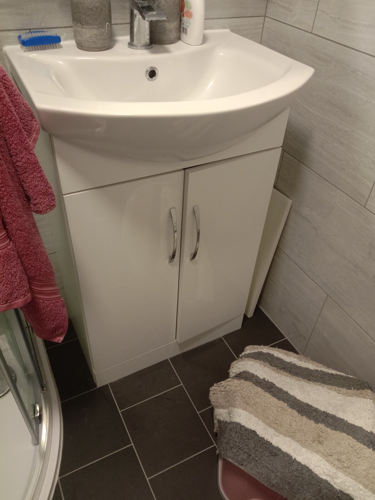

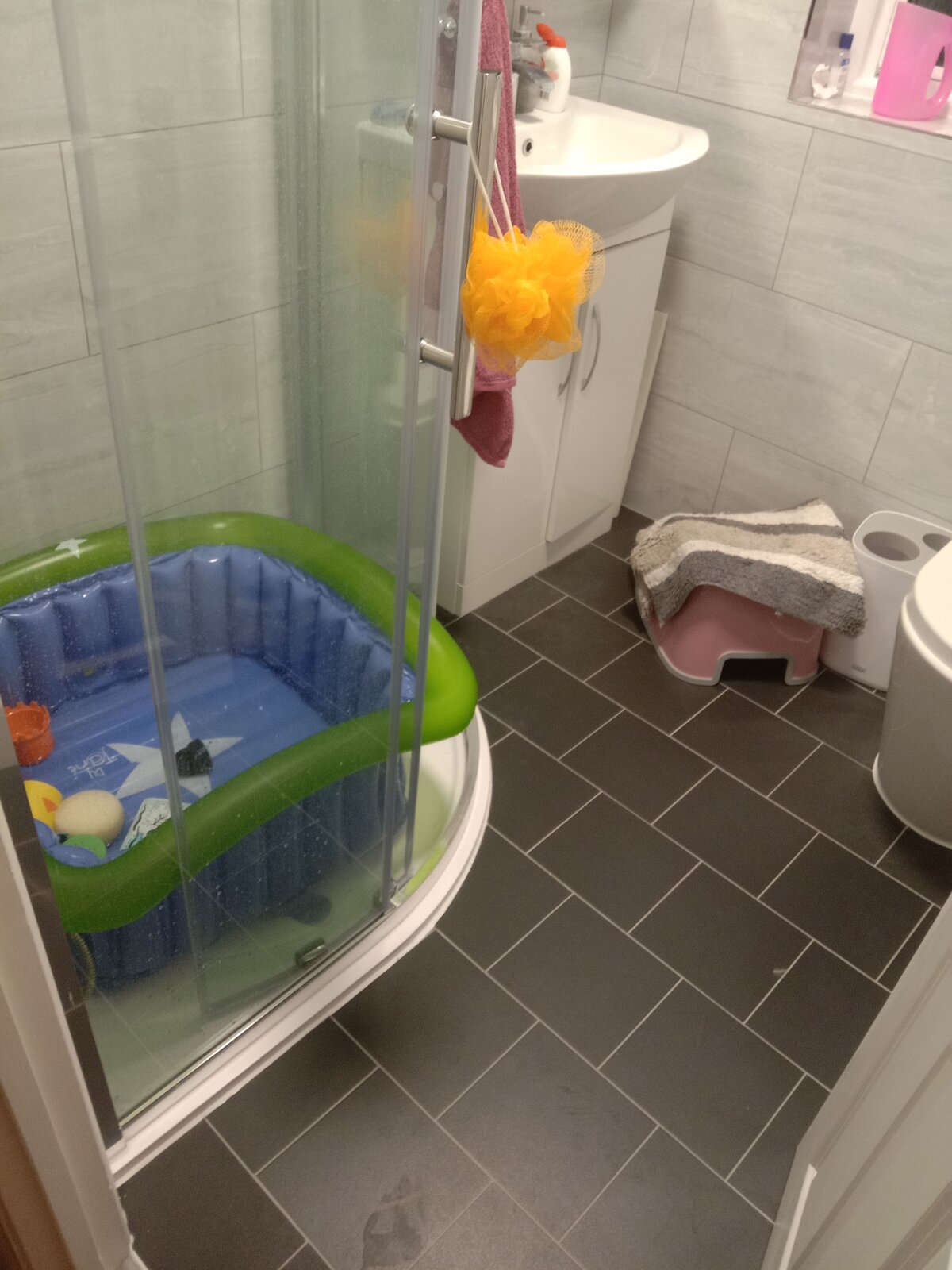

Thank you for your reply. On the left is the shower cubicle 1000x800mm with 8mm thick glass. The noise is mostly coming from the sink area. Please see attached pic.
One of the waste pipe running into the wall on the left was there before so he left it there. It does not do anything. It's a 1930s semi detached house.

Where the sink is,.is where all the pipes are closest, I don't think it's just the waste that's the problem, but all you can do is try.

The loud ones are by the sink area and also shower cubicle that is closed to the sink. Pipes are under the sink and shower cubicle.. please see photos...
