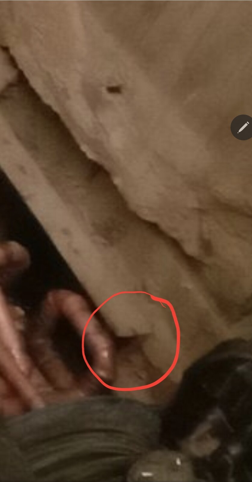

I am afraid this plumber is not taking any responsibility for his actions. He is saying that the cut into the joists was already there and he did not cut even a little piece so it is not his problem . His work is fine . Also he is expecting us to know about Joists and pipework. We asked him if there was a problem with the joists, he should have told us. we could have done something about it then.

You can tell newly cut joists from joists that were cut years back. And yes if whst he is saying is true he should have made you aware so the problem could be resolved.

Looking at the joists, they appear to be no more than 4 inches deep = yet cut out or not they had a bath sitting on them . Is what we can see not the ceiling but a layer of sand/cement on a wooden framework = built in to suppress noise from the bathroom when the house was built ? Do you actually have deep joists - although probably notched too deep o_O
I don't know how deep it is.. he cut the joists to fit in five pipes . We know how it was before. Four pipes were on top of the floor board not between the joists.
He is saying his pipework is prefect , he didn't cut any joists and the bathroom is safe.

Can I just add that there is wiring under that floor i can see in the third image going close to and underneath all that pipework on the left hand side, also the third joist from the right there is a wire clipped to it that you can also see goes under all those pipes. How much of that wiring then is touching a hot pipe? I think that pipework has to be a minimum 25mm away from electrical cables but one of the qualified plumbers can confirm if i am correct on that. Would the qualified plumbers on here agree that needs urgent attention as well.
This joist looks was if it was cut years back. See how dark it is
Could the first image be darker because it was burnt with a blow torch? So could also be recent cut.
