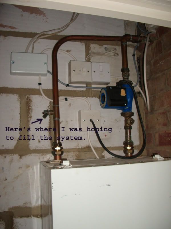

Boiler Cupboard with pump (downstairs; pump is on feed for some reason):
http://img.photobucket.com/albums/v452/tcoolcon/Plumbing/boilercupboard.jpg

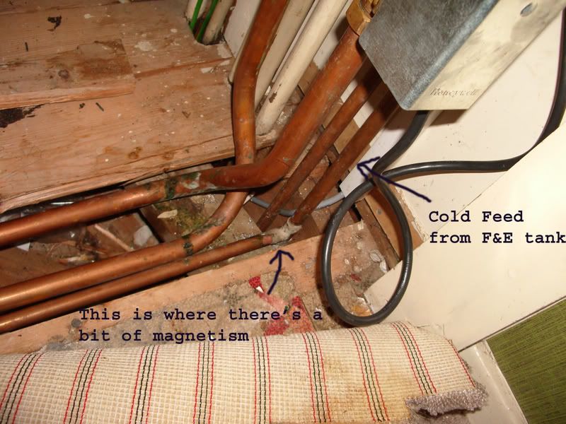

Cold feed (Upstairs; showing where I think it's blocked):
http://img.photobucket.com/albums/v452/tcoolcon/Plumbing/ColdFeed.jpg
Valve & feed (Bigger picture of above):
http://img.photobucket.com/albums/v452/tcoolcon/Plumbing/ValveFeed.jpg

A tip for anyone trying this. Use a bleed valve that off the ground some way as they leak like buggers. The water runs down the hosepipe, so loop the pipe into a bucket to catch it all. Fill a bit at a time, bleeding rads as you go until everything is full.

Cut out the feed connection onto the system and see if it's blocked.

The good news (if I have this worked out) is that the water level expansion tank rises when the heating is on. I assume that, as I don't have a vent pipe, this shows that the expanding water is using the cold feed to expand, and means it's not (or at least no longer) blocked!
