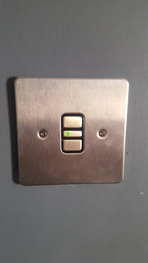

Hi, we've moved into a large house and I've realised I have a lot of high power incandescent and halogen bulbs, also there a lot of Siemens GUGEDIM (I believe, picture enclosed) brand dimmers. The online manual I downloaded says they cannot use LED bulbs and the minimum power rating is 60W (I would want 10-20% of that). Is there a way around this or am I faced with changing the dimmers? Thanks for any insights!

Many dimmers need a minimum load, so if it says no good for LEDs then you may be stuck.
You could get some LED lamps and try it, but you may be faced with replacing them.
Megaman have dimmer suitable for LEDs that have the same look.
A dimmable LED has two features, one is it has a leak resistor so a small amount of power can flow without causing the LED to come on dim or flash, and two it either has a very simple current control or a pulse width modulated control able to read the leading or lagging phase clipping of the dimmer unit. With large 10W or more units the percentage loss to make them dimmable is not worth worrying about, but with multi small units i.e. 10 x 3W LED candle bulbs the losses mount up, and instead of 100 lumens per watt they drop to 60 lumen per watt.
In general LED lamps leak around ½ watt to work the dimmer.
The older dimmers needed a lot more than ½ watt to work the dimmer, although using 10 lamps may mean you get 5W wastage which is enough to get the dimmer to work, one has to ask do you want to use such an inefficient dimmer?
