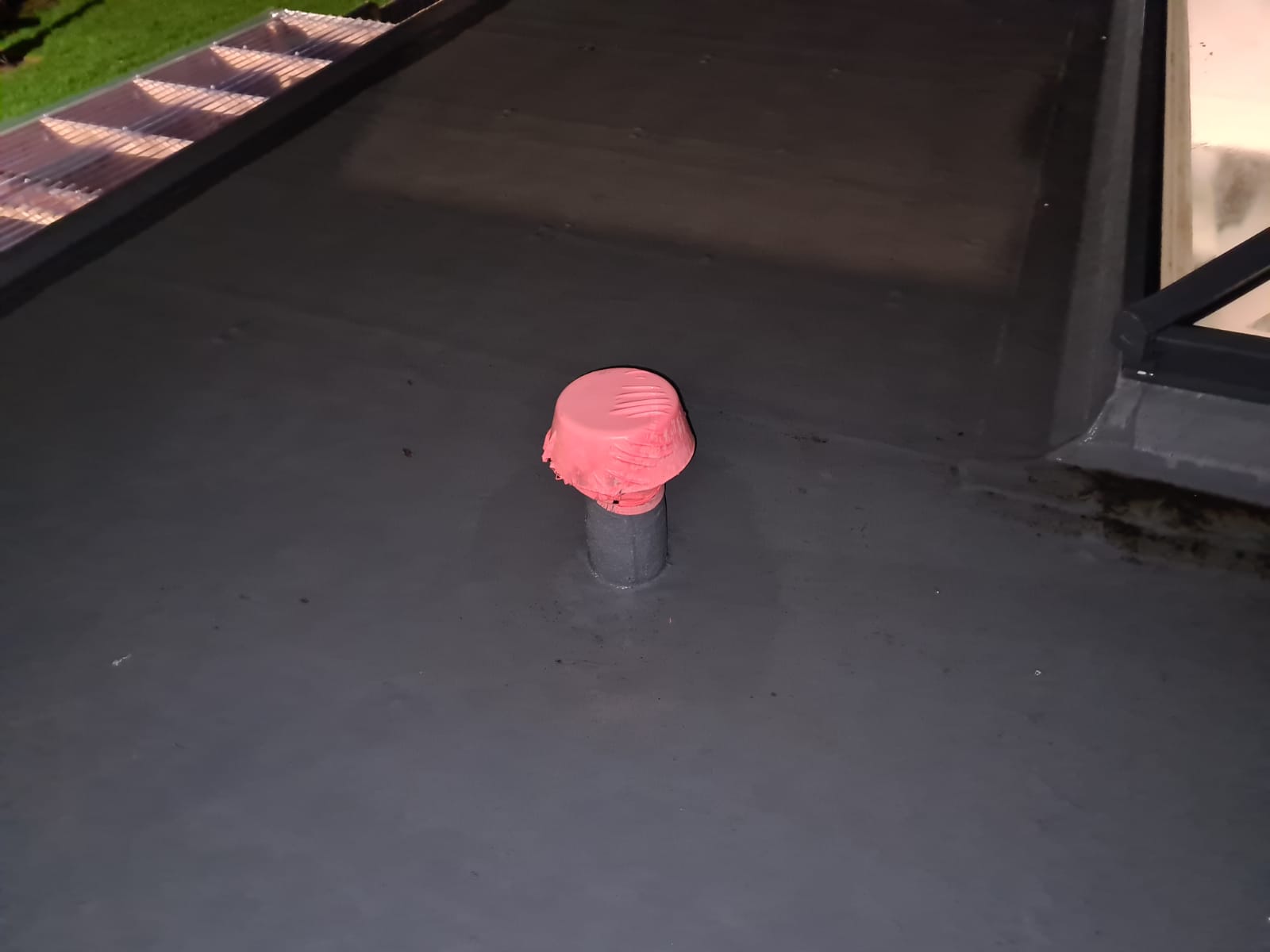

On the roof outside, tried to use a material to block it in, its falling apart and i need a better solution.

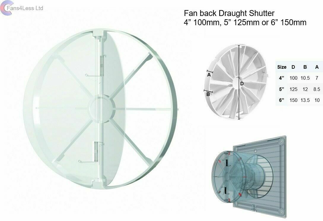

you can get a non-return flap to fit to the duct.
they are usually designed to work on a horizonal duct so the flap swings shut under gravity. I expect it would work vertically if the fan was fairly powerful.
but there are now butterfly valves with practically no weight. They will open if you blow on them.
Like this
Some of the better extract fans have them fitted as standard (e.g. the Soler & Palau Silent 100, also branded Envirovent), but you can also buy them as an accessory. I will see if I can find one to see the brand. I think I had some that were made in Eastern Europe.

this looks like the ones I had
If it's the same, the rim push-fits into the duct but you may need to check the precise measurements, or you may end up sealing it with duct tape.

Fit a back draught shutter, or a fan with one built in.
