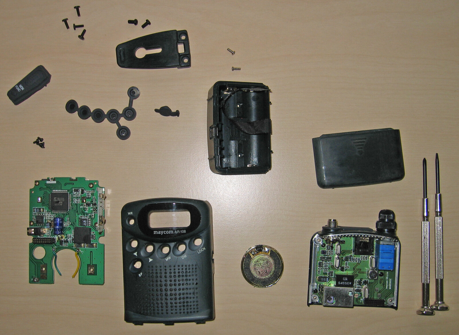

Then had a flash of inspiration and tried Swarfega - and that was better than all of them and has the added bonus that it can be applied without removing the case on the XEBEC. It still put up a fight and needed around three goes and frequent changes of kitchen towel but it has finally shifted the wretched stuff as you can see on the right hand side. I reckon if I leave the Swarfega to soak into it, it might come off even better.
Maycom is gonna have to be taken to bits as the whole thing is coated in the stuff.

I managed to strip down the Maycom and sort that out too - but what's interesting is the battery box section removes and the surface of the box facing inside the scanner where no sweaty fingers have ever been, was even more sticky than the outside. That rather suggests it could simply be warmth rather than sweat that causes the coating to eventually degrade, and when I think about the XEBEC device, it hasn't been used that much, but I tended to leave it sitting on top of the PC.
