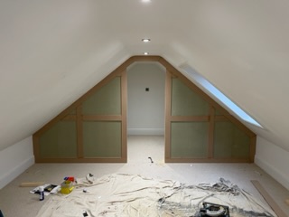

This sort of thing?

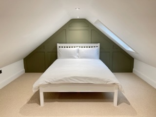

Kind of. That would be the door shape I’d need roughly. But I don’t want the visible door frames. It’ll blend into the panelling. And as it’s not for general access just for storage I don’t need to be as exact as you’ve got there. This is the picture the wife found when she decided she wanted the wall putting up:
I’ll post a picture once I’ve had a crack in a week or 2.

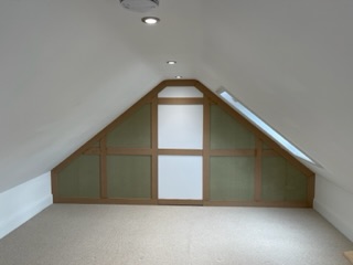

All done, took a bit longer than a week or 2 as always. Went with the intricate top as per @Wayners image. Pretty happy with the result.
