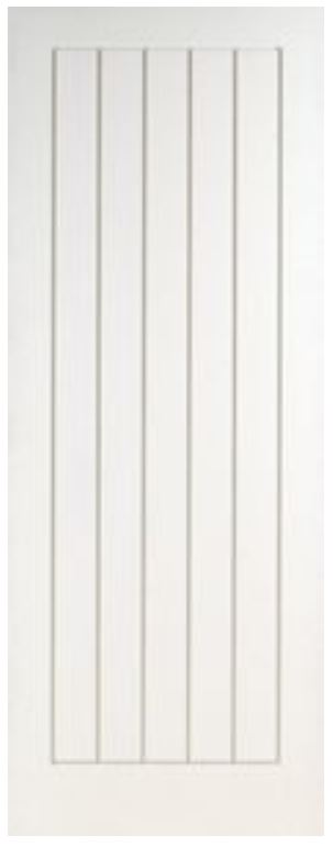

She has seen these hollow core doors in Wickes which she really likes:
which are 1981mm high and 4 various widths - 610mm, 686mm, 762mm and 838mm.

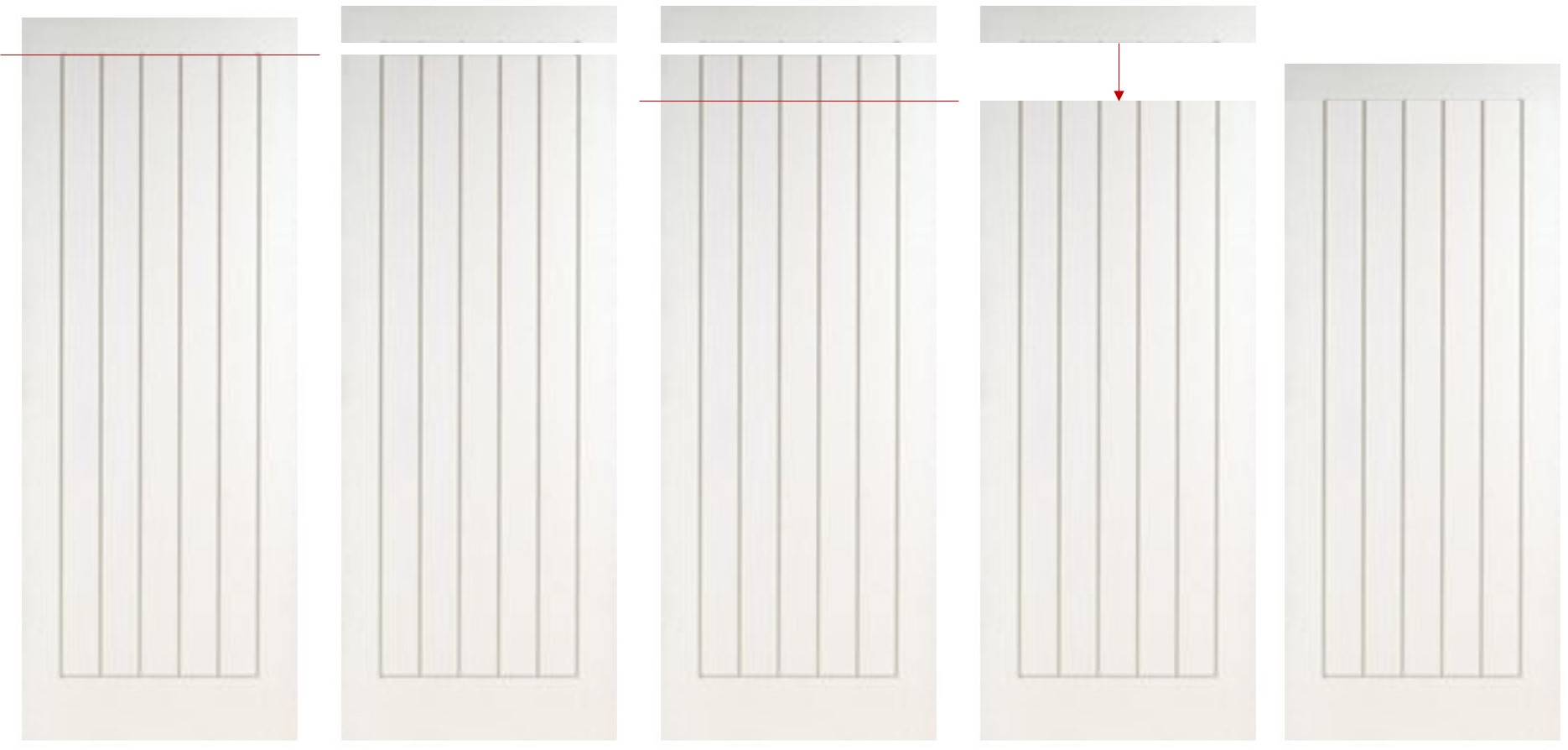

Details of the doors indicate they can only be trimmed by 10mm and so I'm thinking I might be able to make them into custom sizes. For the height, I thought I could make a cut to remove the top rail where it's contoured, then remove the required amount from the field of the door and re-attach the top rail:
This would keep the top & bottom rails in proportion and also keep the lock block at the same height from the floor.

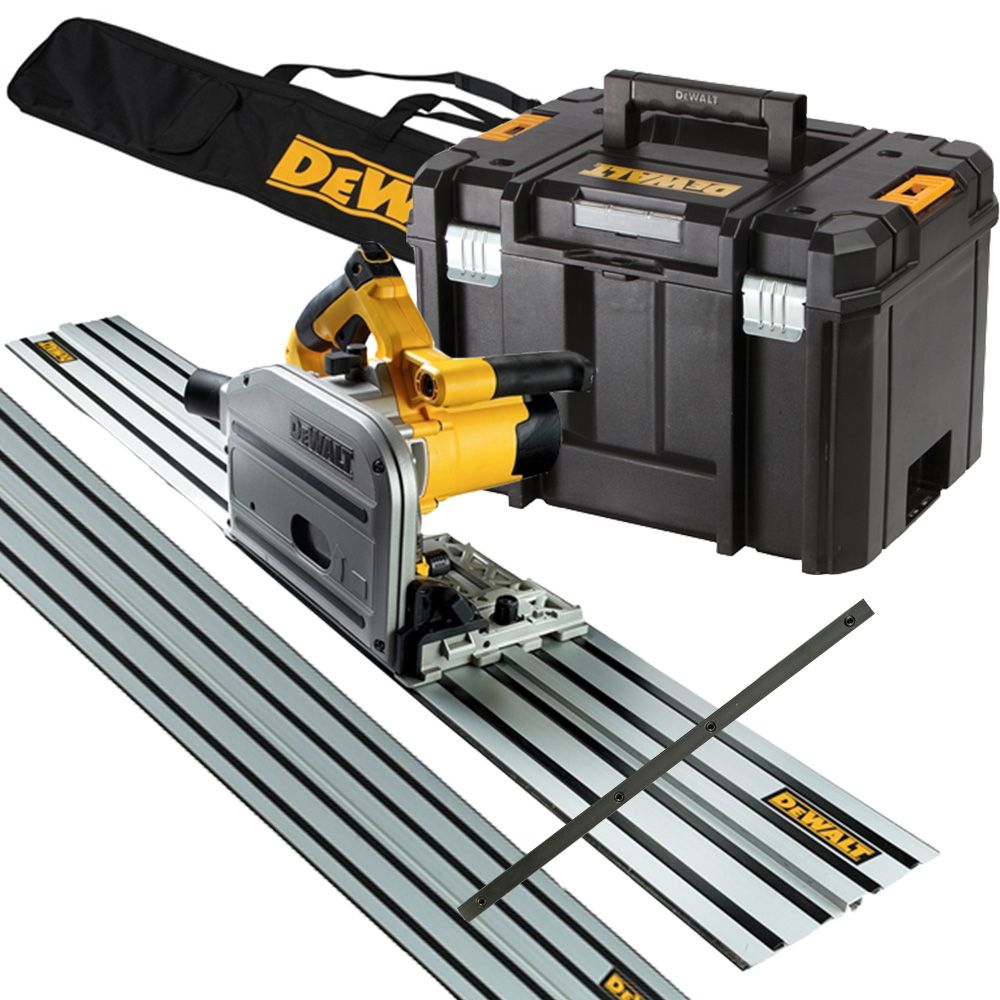

I should add that I have a plunge saw the same as this one, so accurate, square cuts won't be a problem:
As for the widths, I might get away with the standard doors for 4 of them (using 3 x 686mm and 1 x 762mm) with a bit of frame packing and trimming but for the other 2, I'll be removing 32mm & 37mm in total, so using a similar method, I can remove the wood frame from the side:
then remove the required amount of material and re-insert the frame piece using pins and glue.

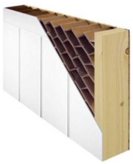

Some of the cheaper hollow doors are actually hollow not even a lump of polystyrene . So make taking the edge off difficult .
Quite easy to copy that style with mdf doors using a router to give the panel effect .
