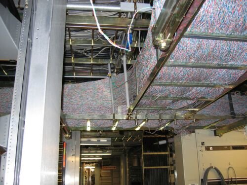

BAS, I assume that's a photo in a largish telephone exchange with what looks like a good few thousand blue/white or blue/yellow pairs ?
