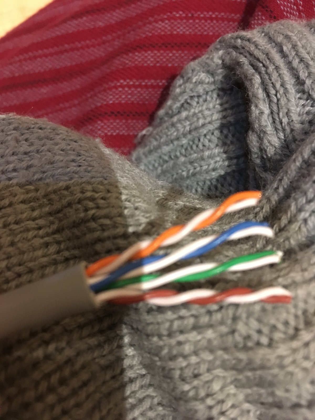

So I normally don't have an issue fitting an RJ45 connector onto ethernet cable but this cable already has a pure white cable twisted around the orange and the same for all the other 3 colours such as green/blue/brown.
So pure white twisted around the brown, pure white twisted around the orange and so on.
If I want to create a normal straight through cable how would I wire this ? As normally I'd expect to share the tracer white/orange with the solid blue and the tracer white/blue with solid green or something along those lines, so this solid white already twisted with the solid colours has got me confused.
Any help much appreciated :)
Here’s are picture
Just treat it as if it does have the tracer colour on it. The fact it's twisted with the other colour means it's the correct one.
You just have to take a bit more time when you are untwisting them at the ends that you keep them in the correct order, because now you have 4 white wires. Testing afterwards is a must.
awesome thanks so i'm pretending the solid white wire twisted with the orange is actually a white/orange tracer wire ?
Get some marker pens out while your untwisting them, mark the white ones with a stripe.
Makes assembling the plug easier as you can get them in order then.
