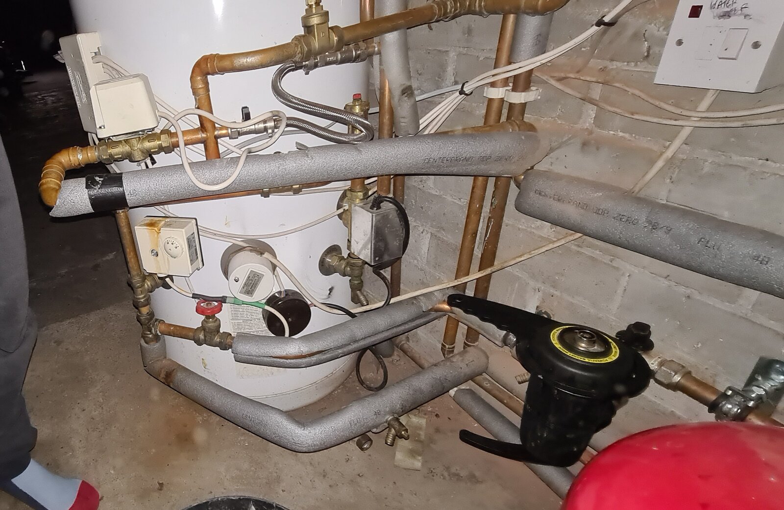

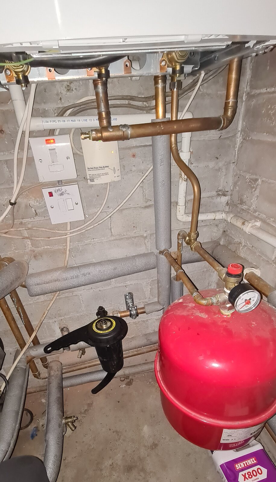

Hello,
I have been scouring the forums for help with my issue. With nothing working I thought I had better post to see what else people can come up with.
We moved into a large house in the summer. It was built in 1901 with stone walls. The CH system is likly to have been installed in the late 1960s and then added to over time with a mix of old single panel and some more modern double ones. In total there are 7 radiators downstairs and 13 upstairs (inc 4 towel radiators).

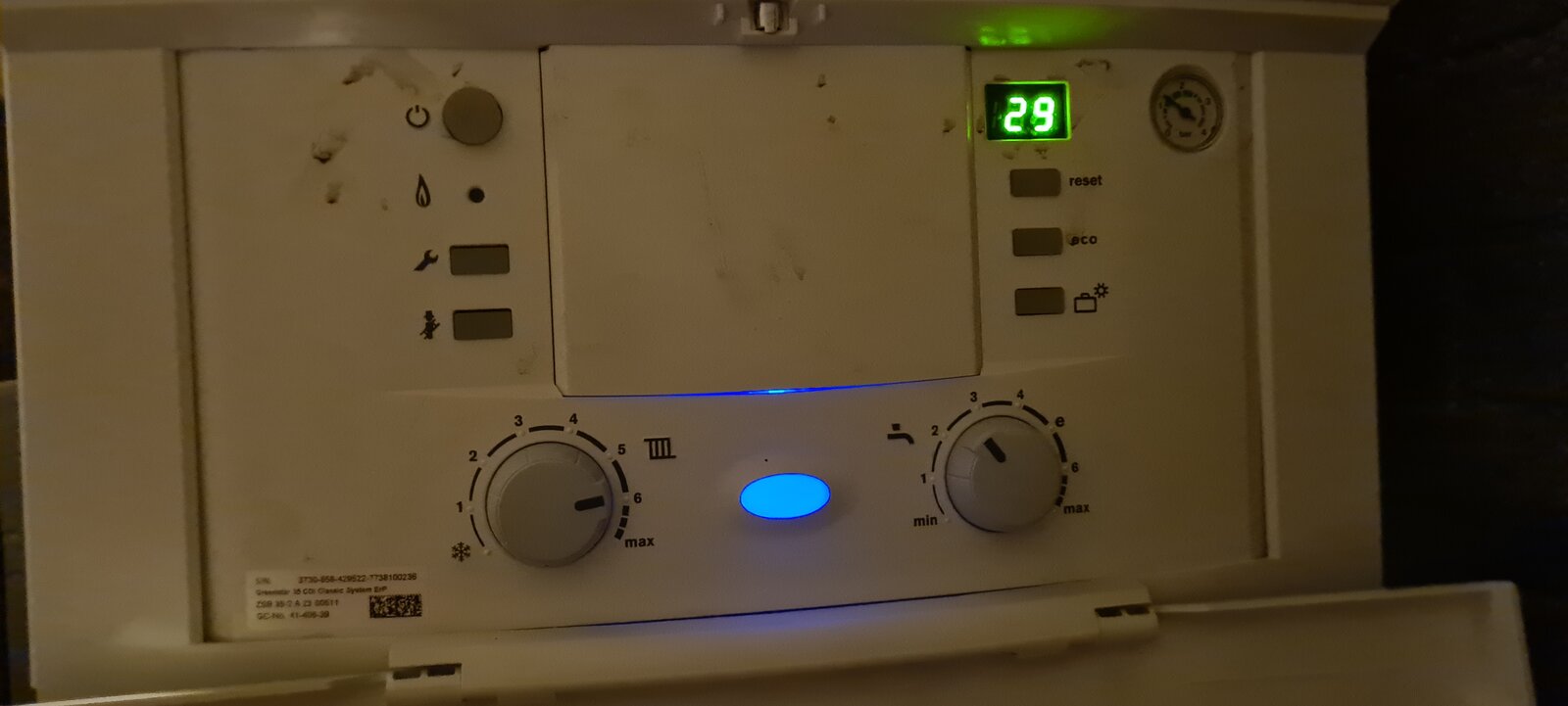

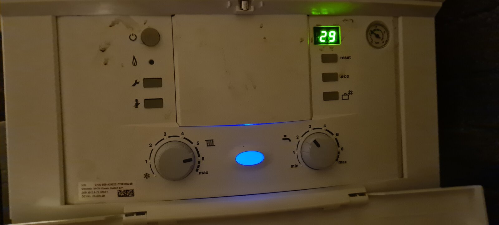

The boiler was installed in 2018 and is a worcster bosch greenstar cdi 35 classic. It's currently turned up to 6 (pretty much max) and water to 2.5.
The boiler and cylinder and next to one another in a cupboard in the garage.
The main issue we are having is that 3 of the upstairs radiators do not work. And many of the others are luke warm at best.
Things I've tried;
Bleeding radiators - doesnt seem to be any air
checked that the trvs are working
Balancing the system - I did my best by touch/hand. It potentially could be done better by a professional.
Placed x800 into the system (2 bottles), Cleaned the magnaclean everyother day since
Taken off and flushed the 3 radiators that are not working; 2 were small old ones (loads of sludge) 1 was a large double (minimal sludge).
Nothing has changed heat wise in those radiators.
Some other odd symptoms: hot water turned down to 2.5 but still scalding.
The flow and return are both very hot, much hotter than rads.

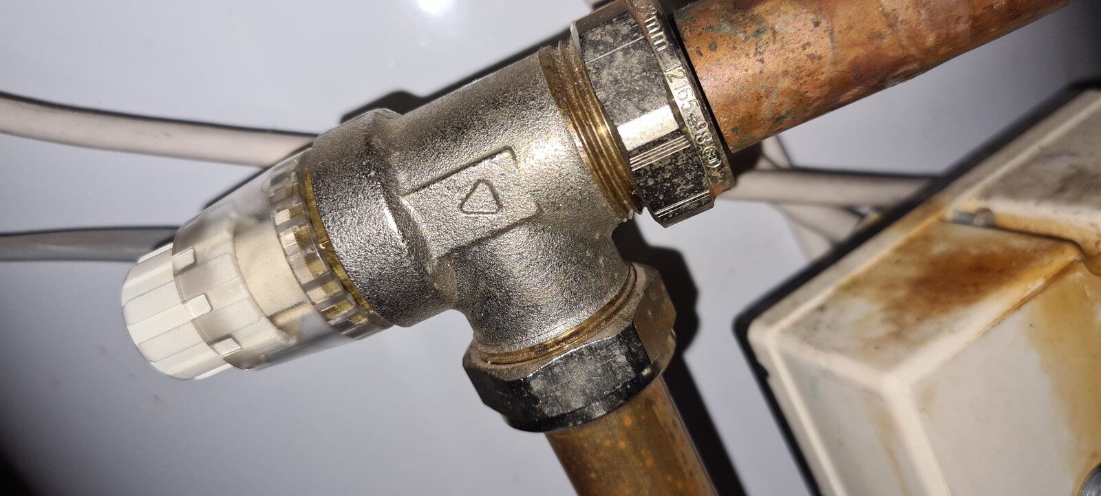

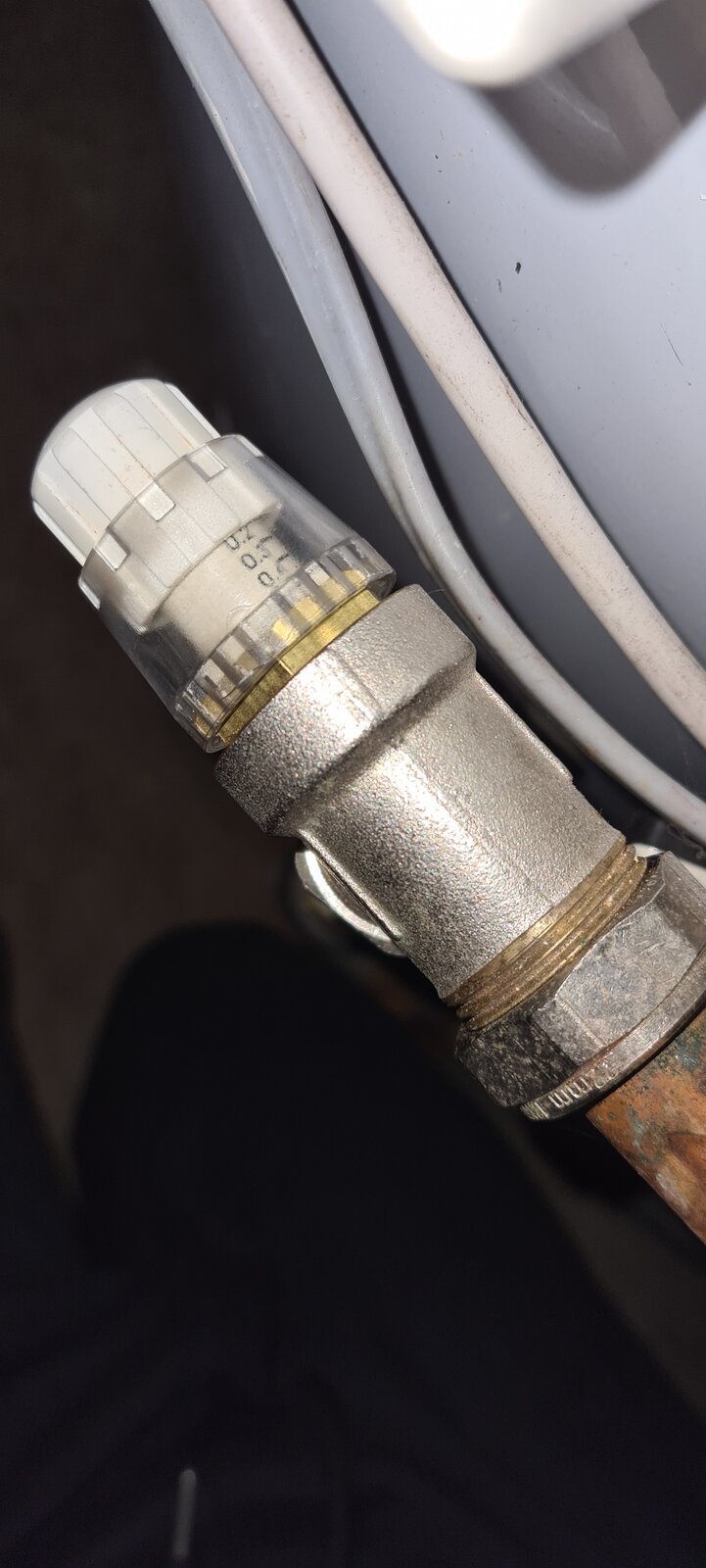

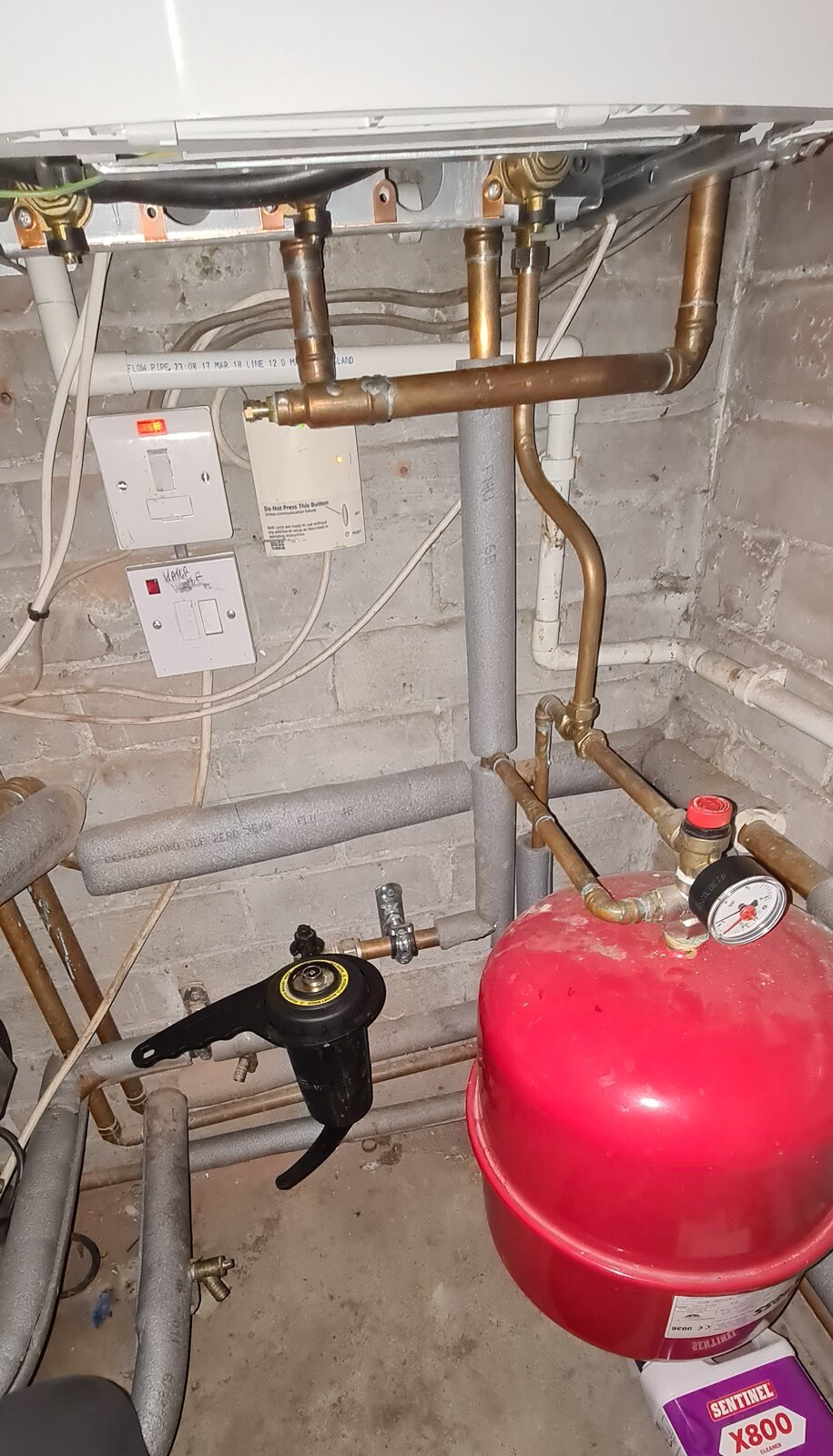

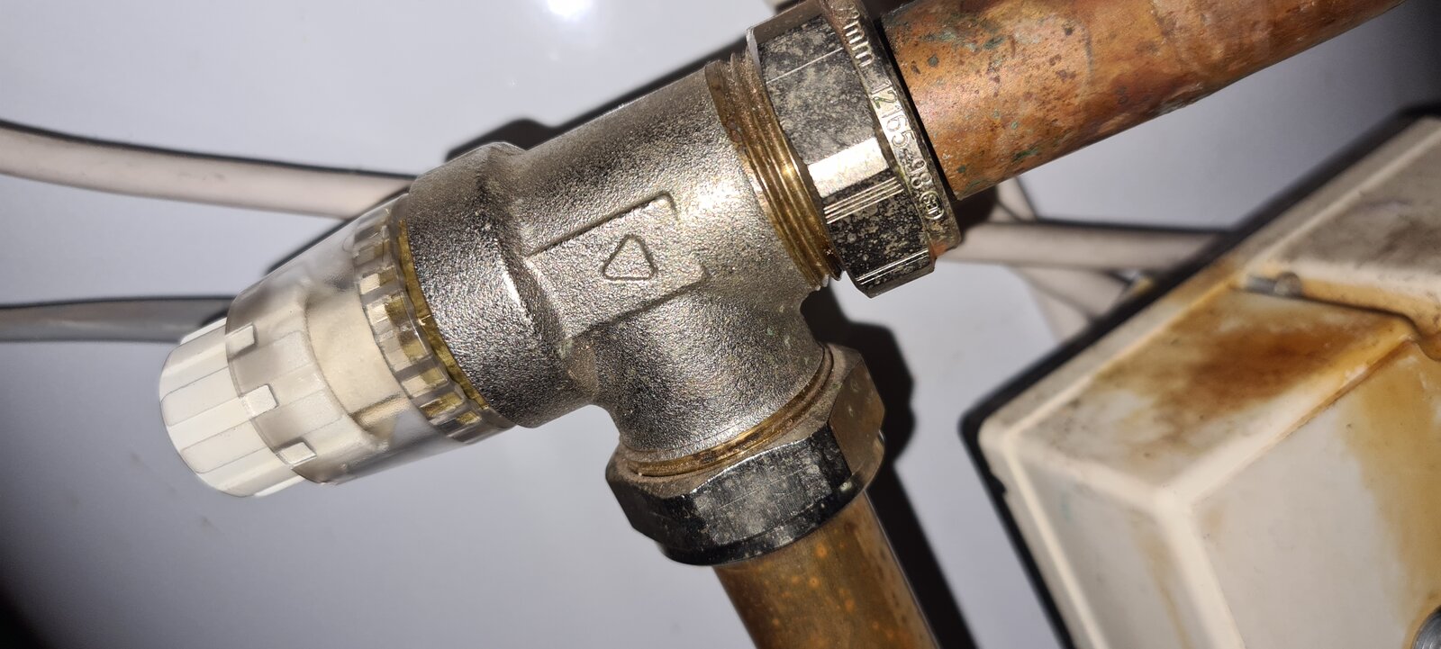

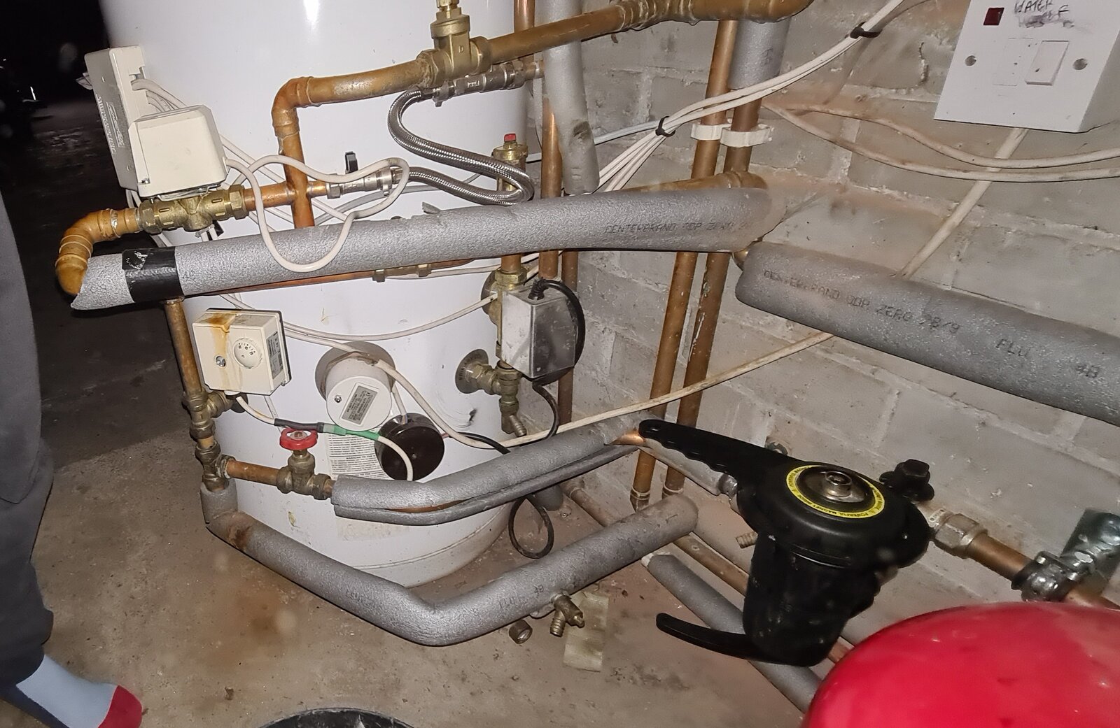

I have included some photos of the pipe work around the cylinder, in the hope it might help.
I am sorry, I don't know the size of the pipework in the system.
Things that I might need to try but havent been able to yet: a magnacleanse, system powerflush.
Any other ideas or thoughts I could try? I am happy to get a professional in, but I would rather at least have an idea of the issue to help them with diagnosing it/save time.
Thanks for any ideas, and I will do my best to provide any further info required.

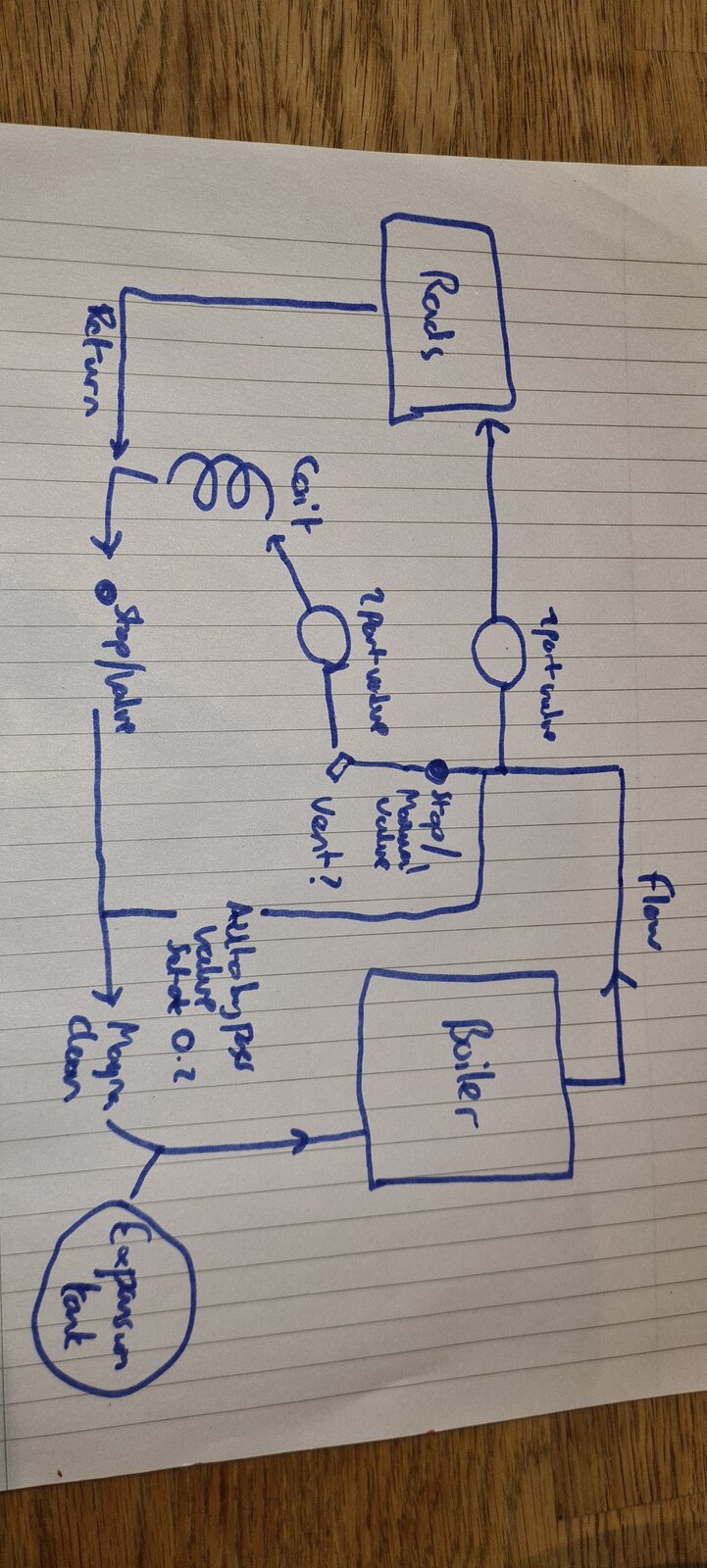

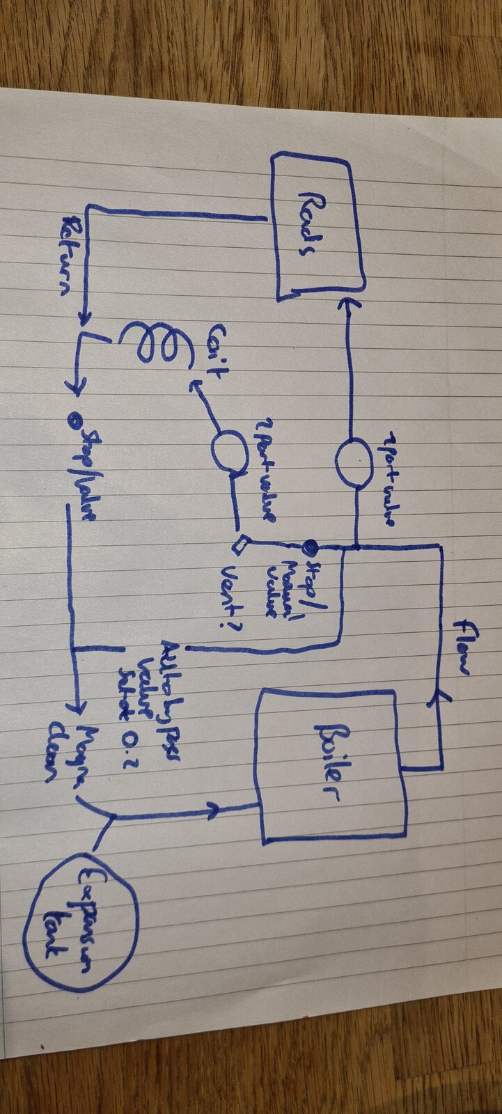

This suggestion falls on deaf ears but I'll offer it up here anyway.
If you can, draw a schematic of what you have.
*Helps you understand what you have
*Helps you problem solve
*Helps others problem solve
*Is a valuable reference.
Doesn't take long either and then you quickly see the obvious stuff...

I'm not clued up on this stuff.
I think this is what you want. Just scribbled it down now so apologies for the crudeness
Yay!
That's great.
Trace every pipe though.....
You have a circulation problem ,possible issue with a by pass,pump, and restricted pipework.
Engage a professional ,you don't need to assist them in diagnosis , just tell them what you have told us.

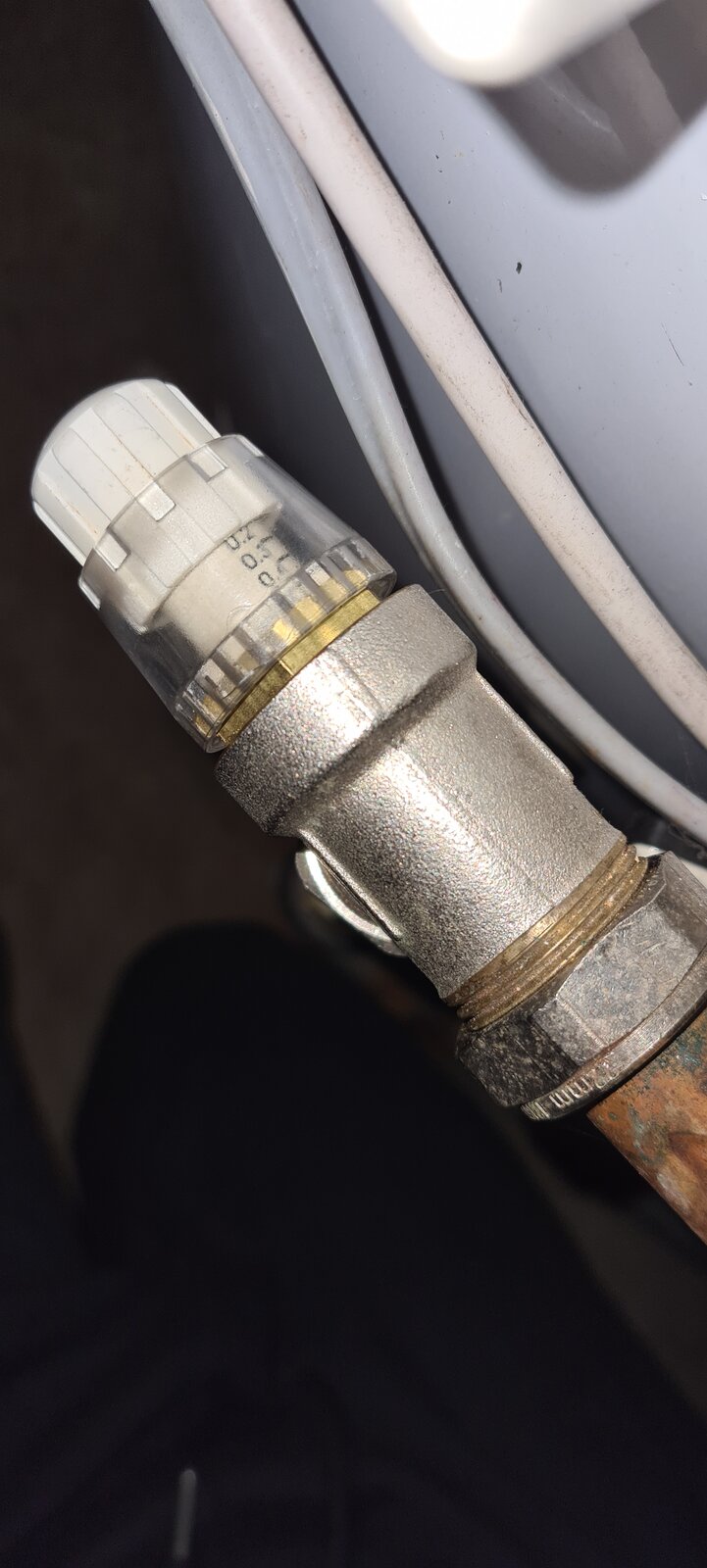

0.2 bar on the abv is low isn't it?
Is it open all the time? (Hot on the outlet).
Google the brand and make and read the settings instructions.
Easy enough.
Might be worth a shot.
Easy enough.
Can't see a brand, I will try searching though.
What is the "average" setting for most systems?

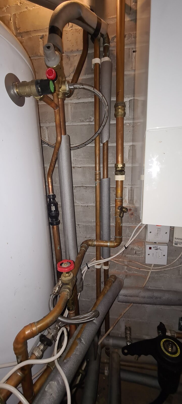

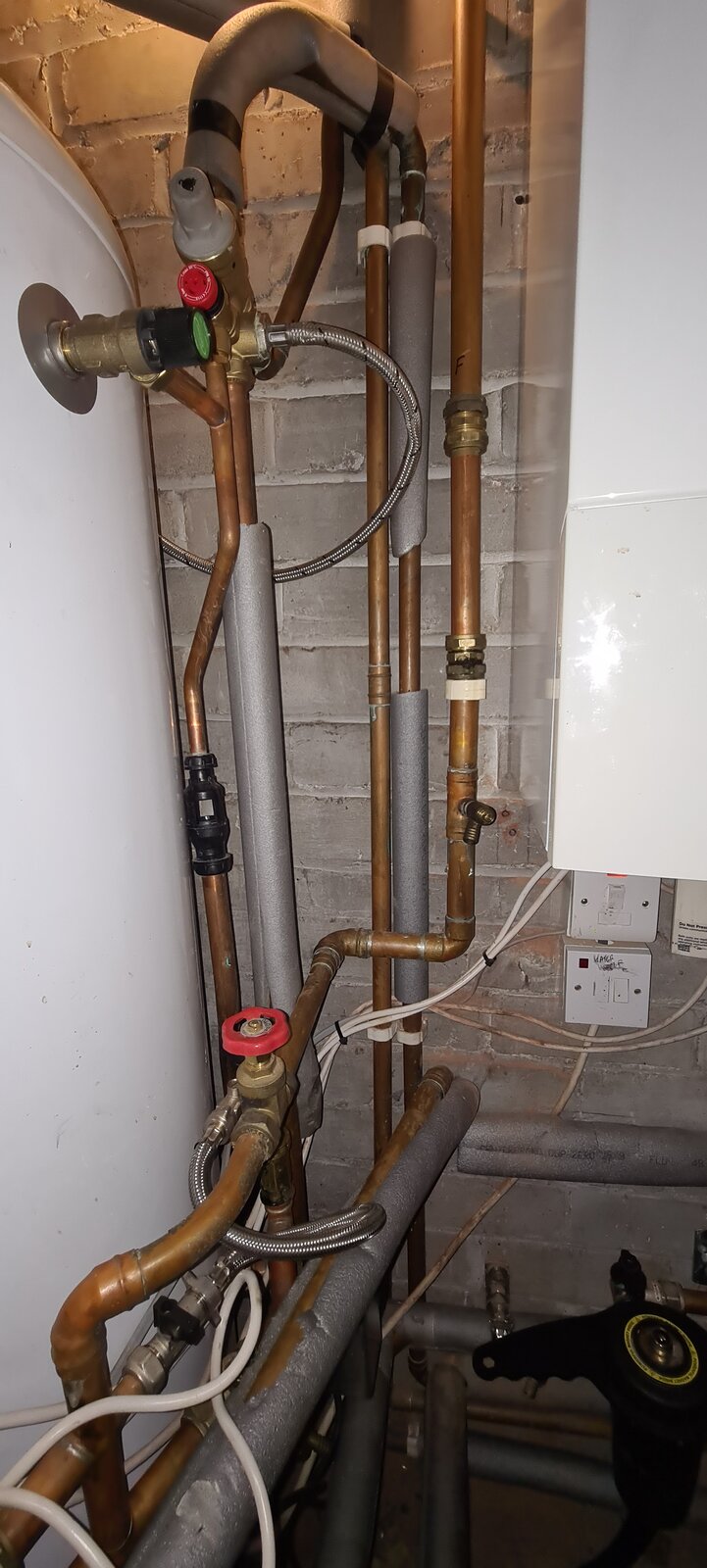

The pipe work below is warm on touching (and heating not even on)
Then as Terry says, definitely a circulation problem. Get someone to take a look, boiler firing on heating, check pump etc.
