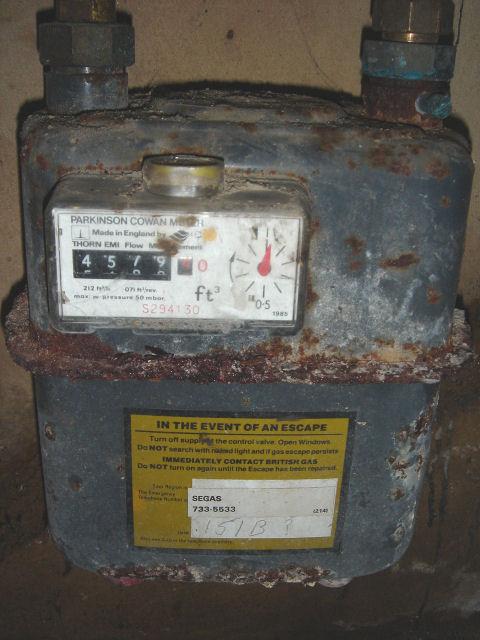

I work for myself selling and fitting kitchens and last week on a job I called the local corgi registered plumber out of the phone book as I was further away than my regular plumber is willing to travel.
I asked him to install pipework for a new hob an move the gas meter tighter into the unit under the sink! He looked a the meter and said that if he was making a new connection or moving the meter it was not allowed to be under the sink as under a sink classes as a corrosive atmosphere. And would have to move the whole lot its the next unit which caused me nothing but problems.
In my 9 years of fitting kitchens I have never heard of this! If this is correct I have 9 years worth of faulty sited gas meters to consider as nearly every house I work on the meter is under the sink!
Any help on this one.

Find someone else...although most gas installers are not permitted to work on the meter pipework before the meter outlet.
Transco/Scotia/SGN and the others happily install meters under sinks. In fact they are not the slightest bit concerned about corrosion until the gas starts to leak.
This one has been reported to them 4 years in a row (it's located under Victorian steps...where the meters and steel pipework always corrode).

He can re-position the meter within the length of the anaconda but he cannot move the incoming service pipe, only Transco, or whatever they're called these days can do that.
Unfortunately the guy is talking by what is written in all the MET1 manuals,however what he failed to tell you is that if it is showing signs of deteriation due to its location then it should be reported to transco, who will make the call on if it should be moved, replaced or left in situ.
Theres a long list where you shpouldnt site a meter and is broken 9 out of 10 times,some locations being corrosive enviroment,cupboards where food is stored.
For exact info try the CITB appliances pocket guide or the viper books.

the BS on gas meters says meters should not be sited under sinks or in cupboards storing foodstuffs
